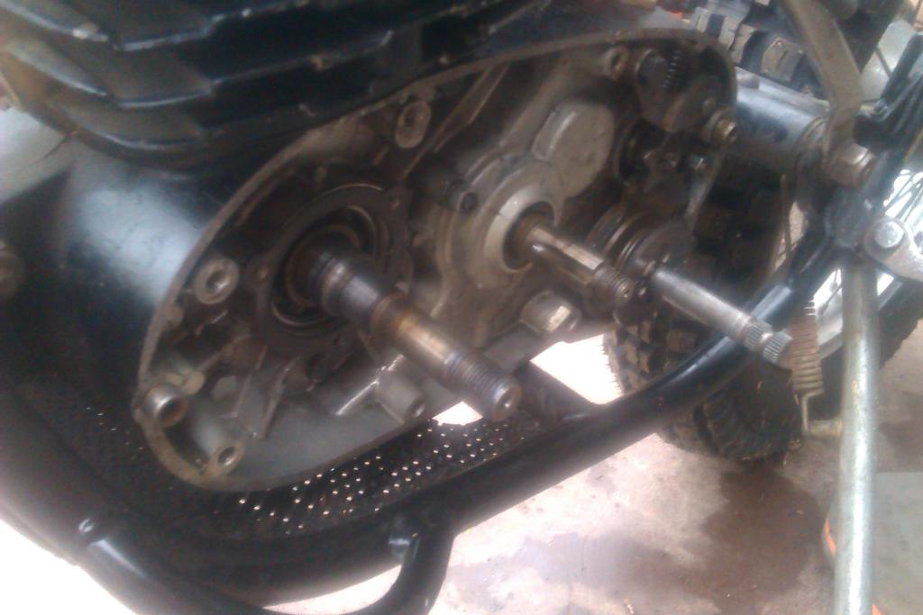

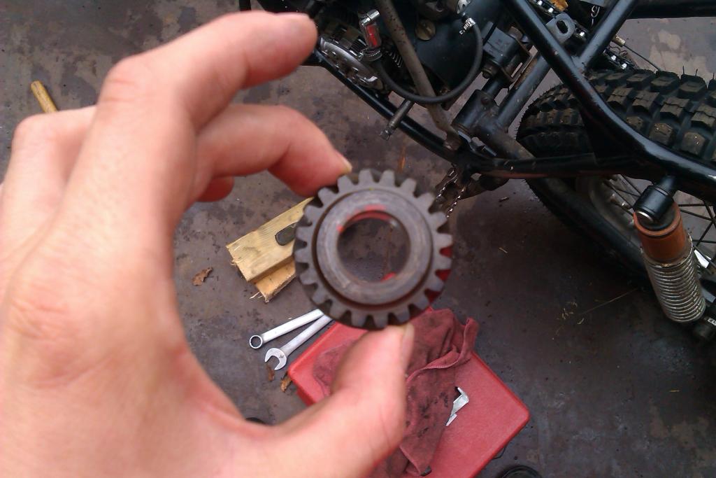

I was pretty happy to see this come off.
Finally I can get access to the oil seal.
In all it's glory.
