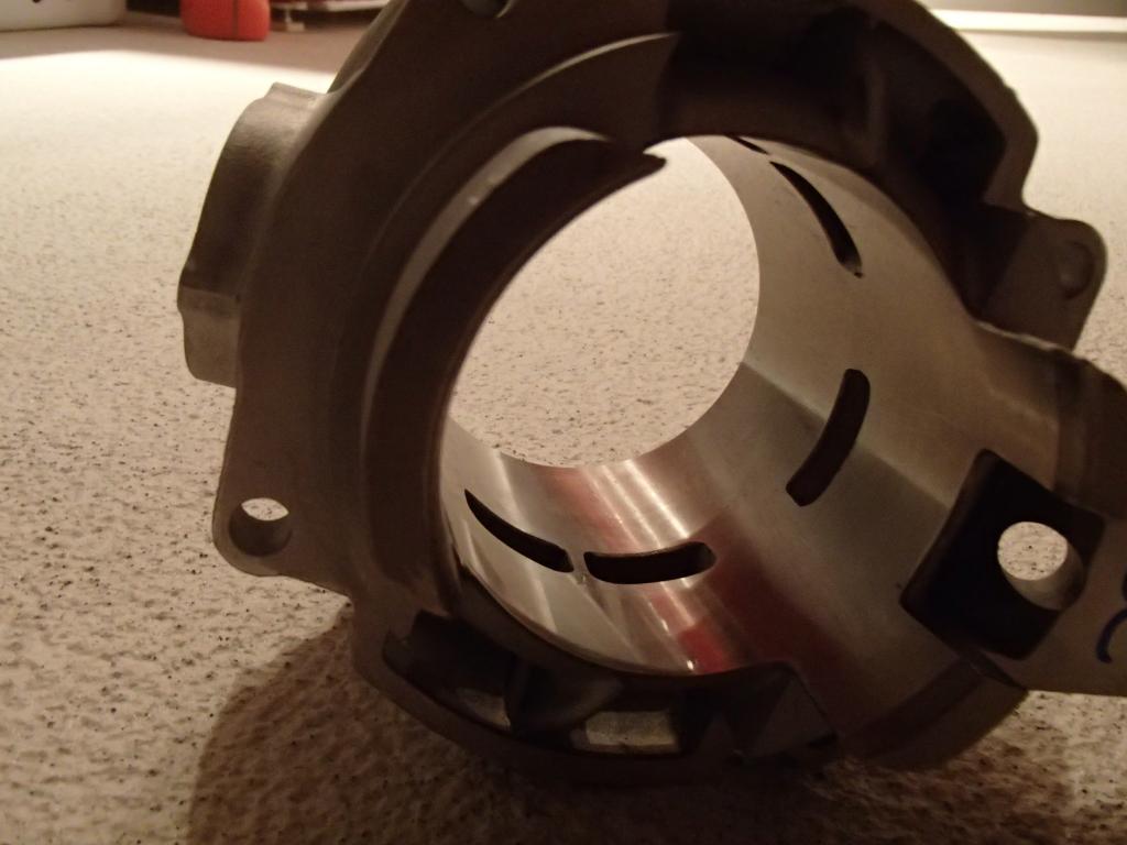

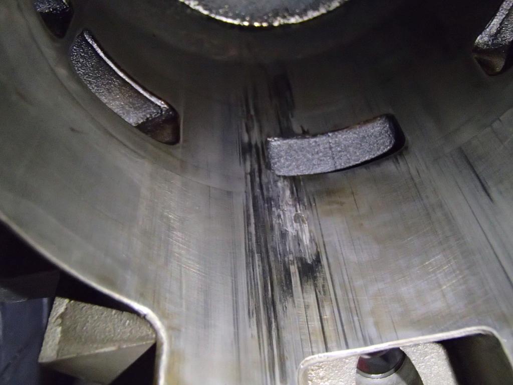

February 13, 201511 yr Had my Ossa's nikasil cylinder redone by this Quebec company.Cylinder looks better than new.Prompt friendly communication dealing with the clearances needed.$300 (cdn) is better than a new cylinder for sure.I sent them the new piston and buggered cylinder and they came back in 3 weeks. http://www.cvtech-aab.com/en/ Before After

February 13, 201511 yr It doesn't look like the original damage was near the exhaust port, closer to the transfer/intake, is that right? Seems like an odd spot for wear. The work they did looks good, what type of clearance did you leave between the piston and wall? What piston did you use?
February 13, 201511 yr What radius have they put on the port edges? those in the photo look very sharp
February 14, 201511 yr Author It doesn't look like the original damage was near the exhaust port, closer to the transfer/intake, is that right? Seems like an odd spot for wear. The work they did looks good, what type of clearance did you leave between the piston and wall? What piston did you use? The damage was at the intake.I think it was just rough use and maybe a bit too tight.(it's a 2011) I trust CV-Tech know what they are doing.My dealer sent them the factory specs.The piston is a oem 75.95 which is the A.I don't know what the clearances are.Sorry. What radius have they put on the port edges? those in the photo look very sharp The picture doesn't show the radius work they did.Here's a pic that does.It's really well done. Edited February 14, 201511 yr by ric h
February 14, 201511 yr That original smearing of the piston indicates a seizure or partial. Seems some type thermal event, owner would be the one to say why and when. Did it start rattling?
February 14, 201511 yr If the piston is 75.95mm then I'm picking bore size will be exactly 76.00mm giving clearance of .05mm or 2 thou
February 14, 201511 yr Author Here is a pic of the piston.It came apart for inspection and to install a second base gasket.The engine was running perfectly!
