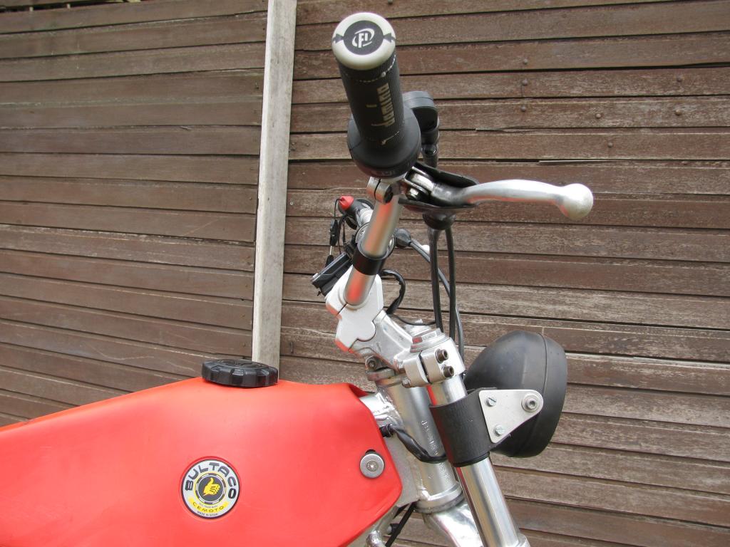

guys Posted August 9, 2015 Report Share Posted August 9, 2015 At first I was a bit sceptical when a experienced twinshock friend advised me to put a higher handle bar on my Sherpa. I thought that there wouldn't enough weight on the front at steep climbs, but after mounting some SW-Motech bar risers and spending a day test riding at Bilstain, my fear turned out to be unfounded, and I gained some comfort by a more upright riding position, wich is nice. I also changed the tired old fork springs for some progressive ones from Magicals which really livened up the front. 4 Link to comment Share on other sites More sharing options...

guys Posted August 13, 2015 Report Share Posted August 13, 2015 Guys, what brand are the bar risers? I think thats what I need. http://shop.sw-motech.com/en/by+products/Ergonomics/Barback/index.htm Link to comment Share on other sites More sharing options...

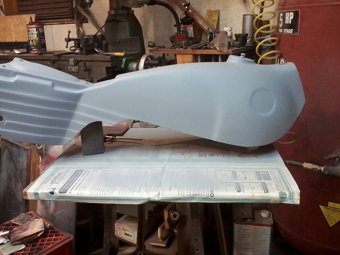

lbhbul Posted August 26, 2015 Report Share Posted August 26, 2015 (edited) Here is the latest fixer upper to come through the door, just mostly cosmetic as it was here a year ago .( Not running at the time) Carb change for you know what I like; it had all new points & condenser,( ran terrible), nice new remote auto condenser sorted it. The top of the tank in front of the filler looks like an alligator! To be continued Have a nice day Larry Edited August 26, 2015 by lbhbul 6 Link to comment Share on other sites More sharing options...
lbhbul Posted August 28, 2015 Report Share Posted August 28, 2015 We have made a little progress, need to get on with it as fishing time is close. More later Larry 5 Link to comment Share on other sites More sharing options...

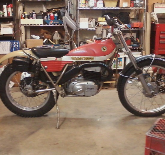

lbhbul Posted September 2, 2015 Report Share Posted September 2, 2015 Getting closer got to finish this beasty, time to go fishin!! Have a good day Larry 4 Link to comment Share on other sites More sharing options...

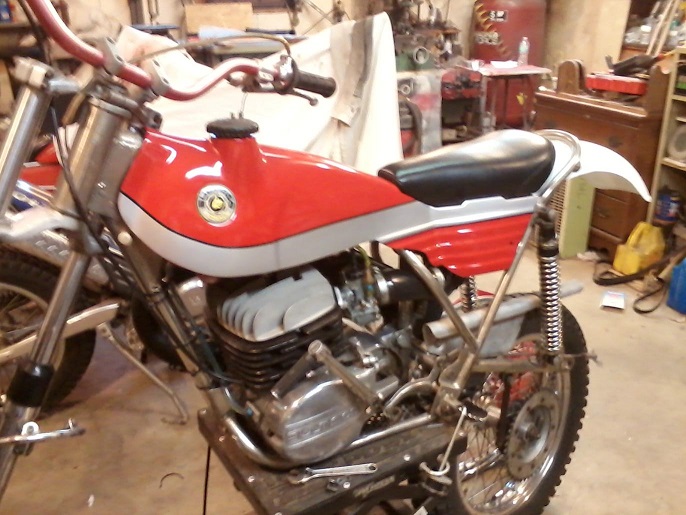

lbhbul Posted September 3, 2015 Report Share Posted September 3, 2015 (edited) Very nice Stuart you will have to be sure to keep us abreast of your projects. Today my buddy brought me a m166 Alpina cylinder (std bore ) that we shall attempt to machine to m199 dimensions as close as possible (Alp 64mm stroke). It looks like it will work. The m125 project goes on, a new surprise today; the primary case is damaged and will leak, so clean and sand and clean again, now some glass cloth and resin, should have that taken care of. New shocks arrived and installed so now all we like is finishing up! Forgot to post this photo of a m159 style glass tank and wonder if any can tell where it might have originated, please note filler. Thanks Have a nice day Larry Edited September 3, 2015 by lbhbul 2 Link to comment Share on other sites More sharing options...
