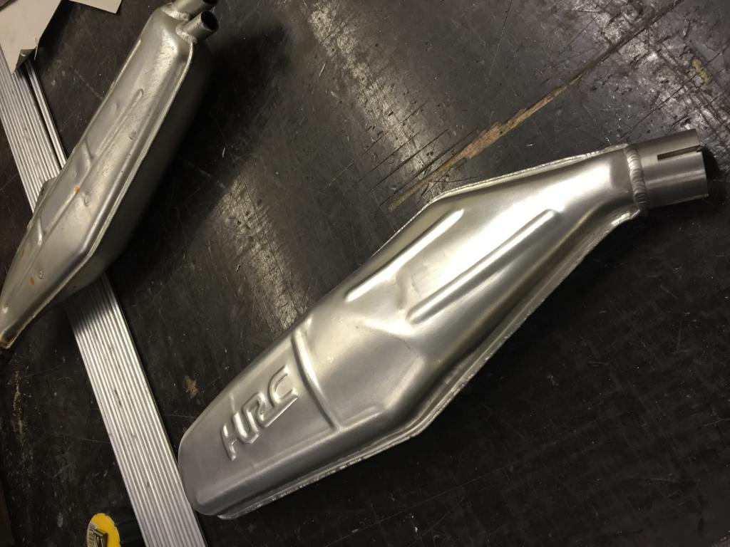

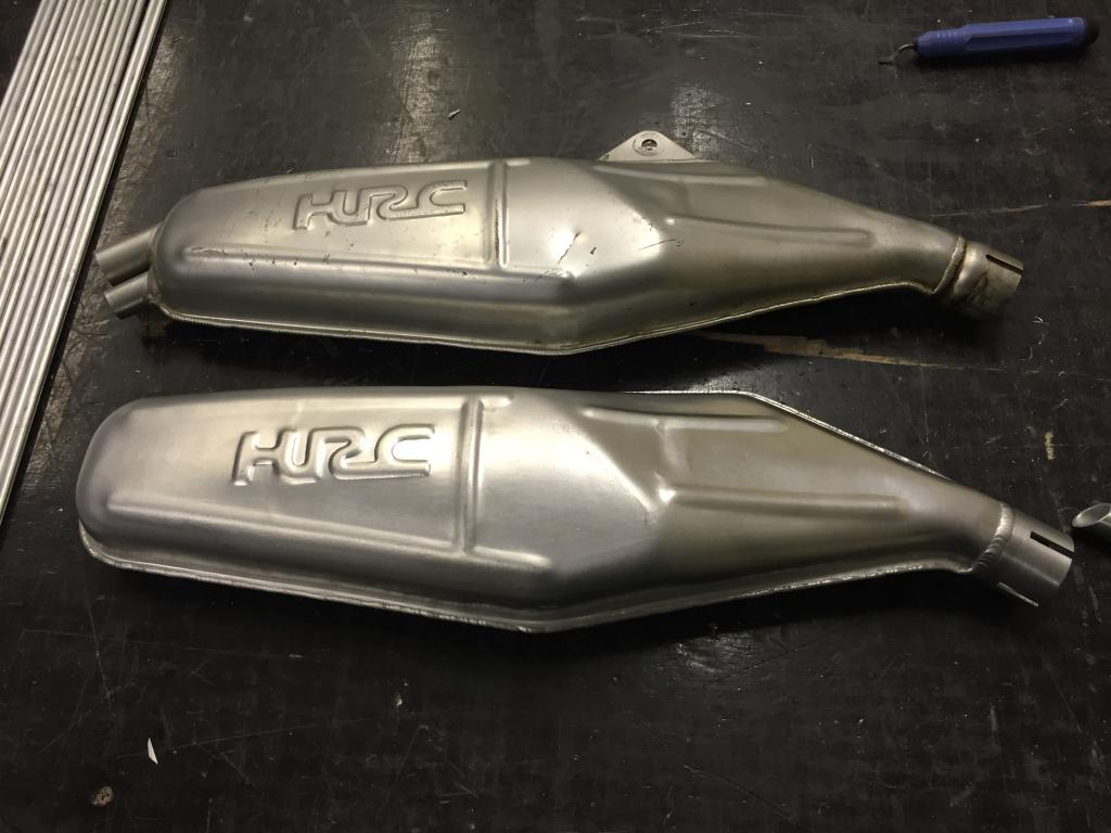

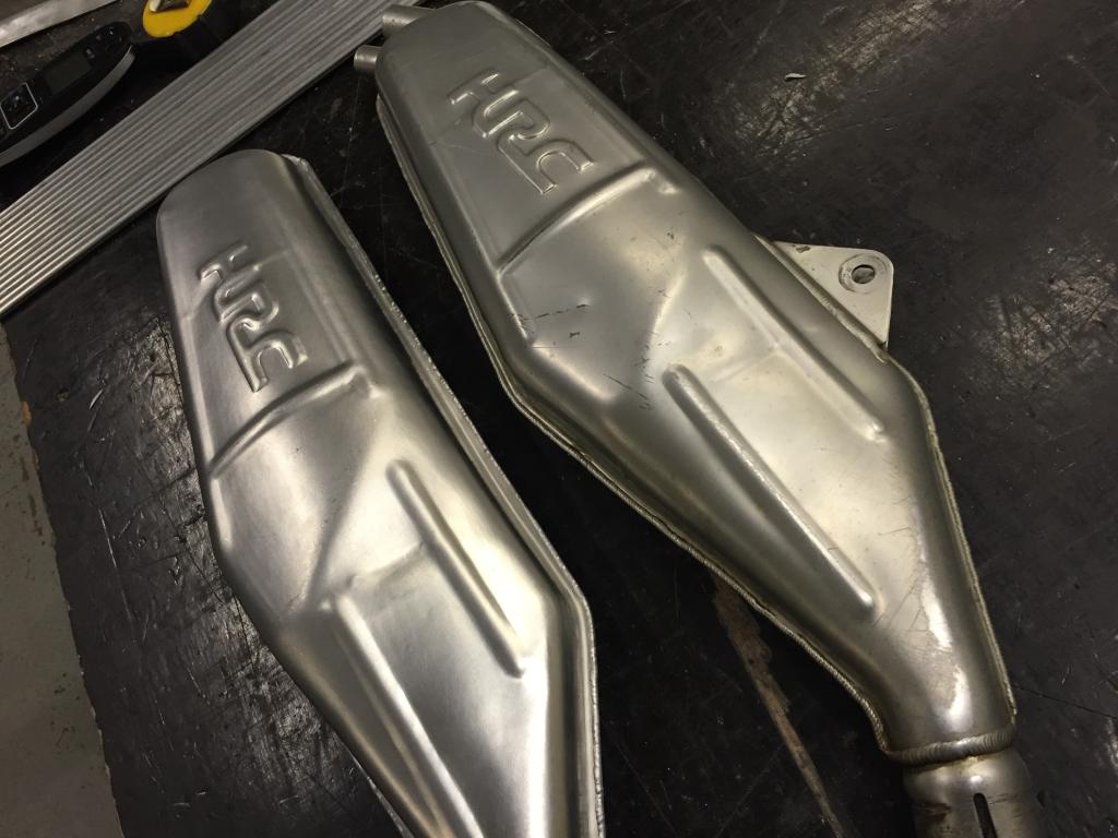

This happened tonight, still more work to do - this is our first one so not 100% (obviously isn't totally finished anyway)
Its come out really well though, I want it so you cannot tell one of these apart from an original.
It still has to be anodised but it should be fully finished by Monday to be taken to be anodised.

Nice welding, I think a factory finish look is well on the cards. I hope you haven't made it too heavy

The aluminium is slightly lighter gauge than the original, 0.03mm thinner. So if anything its slightly lighter.
Its had to be done slightly thinner due to needing to keep the detail. You lose the definition slightly in the moulds when you make it out of thicker aluminium.
I'll be doing a batch of 10 this year. (this is an interest for me and was done for my own bikes benefit) The moulds I'll obviously save.
I'm keeping two for myself. so there will be 8 available.
Price has until recently been very hard to calculate. The price will be £525 + postage
Believe me when I say this isn't covering my costs - it was done as a project, it was never for financial reasons.
