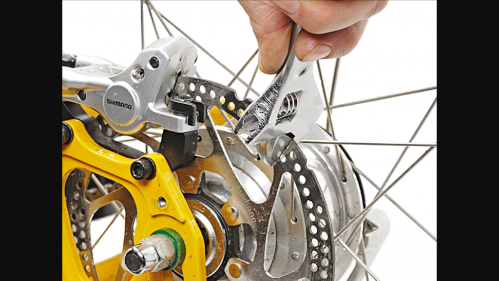

Right the pads are out and the disc is like a dogs back leg How do I go about straightening it? Fronts a little bent too, but the wheel spins quite freely
If you insist on straightening it then get an adjustable spanner. Adjust it to the thickness of the disc and give it a tweak. The bigger spanner the better so as to spread the force along the disc.
Thanks for the help lads, pads are low and the disc is defiantly bent. I've got it 90% straight and it barely catches now so I'm happy
