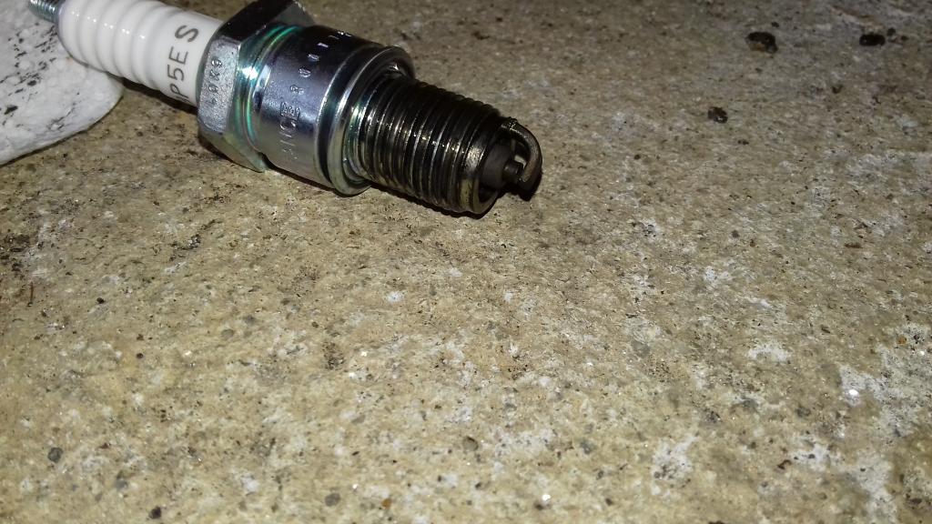

Having rebuilt the Sherpa engine and had it running beautifully I then go and pour 2 litres of Diesel in when refueling.
I gave the tank a quick wash with straight unleaded, kicked over the engine lots, cleaned out the carb and replaced the filter and plug. Still running like ****e.
The video is at half throttle and pic of the new plug.
I plan on dumping the fuel in the tank as presumably the tank was still coated with Diesel, washing again with unleaded and re-cleaning the carb.
Any other suggestion apart from stopping being so stupid?

One thing I noticed is your plug gap is too wide. A Sherpa likes a plug gap the same as the points. .40mm. Unless it has a CDI installed then go with whatever the ignition maker recommends. I once had to run a lawnmower engined minibike on diesel and it ran and got me home but it was not happy about it all. Graham.

Well it is easier to start and will tick over nicely. When revved it bogs down a little and if held at a constant throttle it seems to miss and sometimes there is a blow back through the carb which tries to stop it. I've put it into gear and it does run forward.
The plug is looking better after a short run now as the pic shows. I've gapped the plug and it was to big.
Things are moving forward but it still is far from ok.
Thanks for your help, I'd be jiggered without it.

Try a NGK PB4ES instead of a 5 as lonf as you won't like to do MX with the bike for better plug color aka better spark and plug live as it still seems to be too dark in my personal view.
