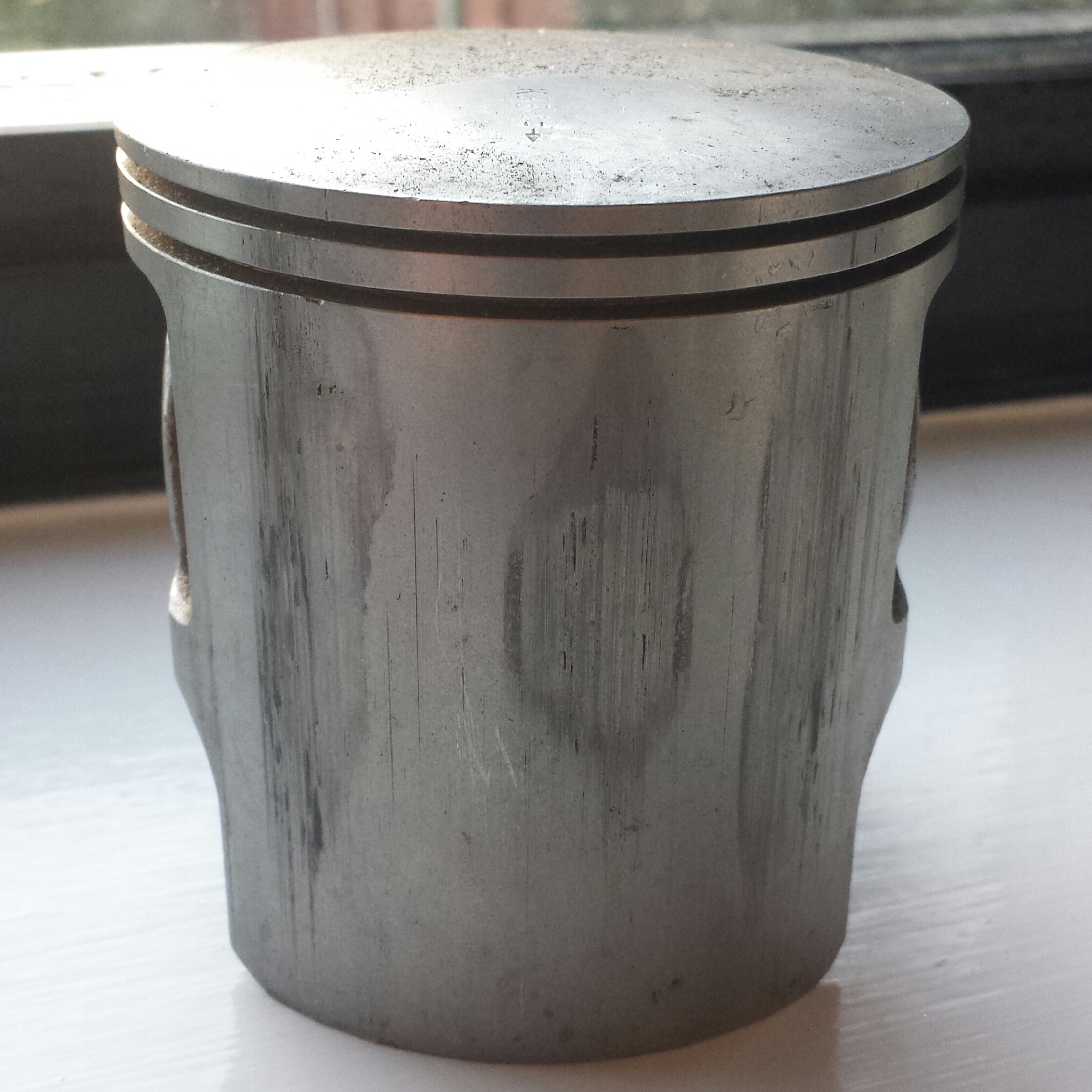

fantic240motor Posted January 2, 2017 Share Posted January 2, 2017 If your piston looks like this it's time for a new one! I doubt it will. I bought my 307 as a dead project. It had been used as a field bike and run without an air filter and not enough 2 stroke oil. 1 Quote Link to comment Share on other sites More sharing options...

fantic tom Posted January 2, 2017 Author Share Posted January 2, 2017 Very interesting picture fantic 240 motor did yours need replating or was a piston kit enough to repair it? Quote Link to comment Share on other sites More sharing options...

dadof2 Posted January 2, 2017 Share Posted January 2, 2017 3 hours ago, fantic240motor said: If your piston looks like this it's time for a new one! I doubt it will. I bought my 307 as a dead project. It had been used as a field bike and run without an air filter and not enough 2 stroke oil. The piston in the photo is not necessarily scrap. It has just had a light nip up, there is hardly any wear on the skirt. Clean the nip up marks off with fine (800 to 1200) wet and dry, scraped out the ring grooves if the rings do not move freely and it should be OK. Quote Link to comment Share on other sites More sharing options...
