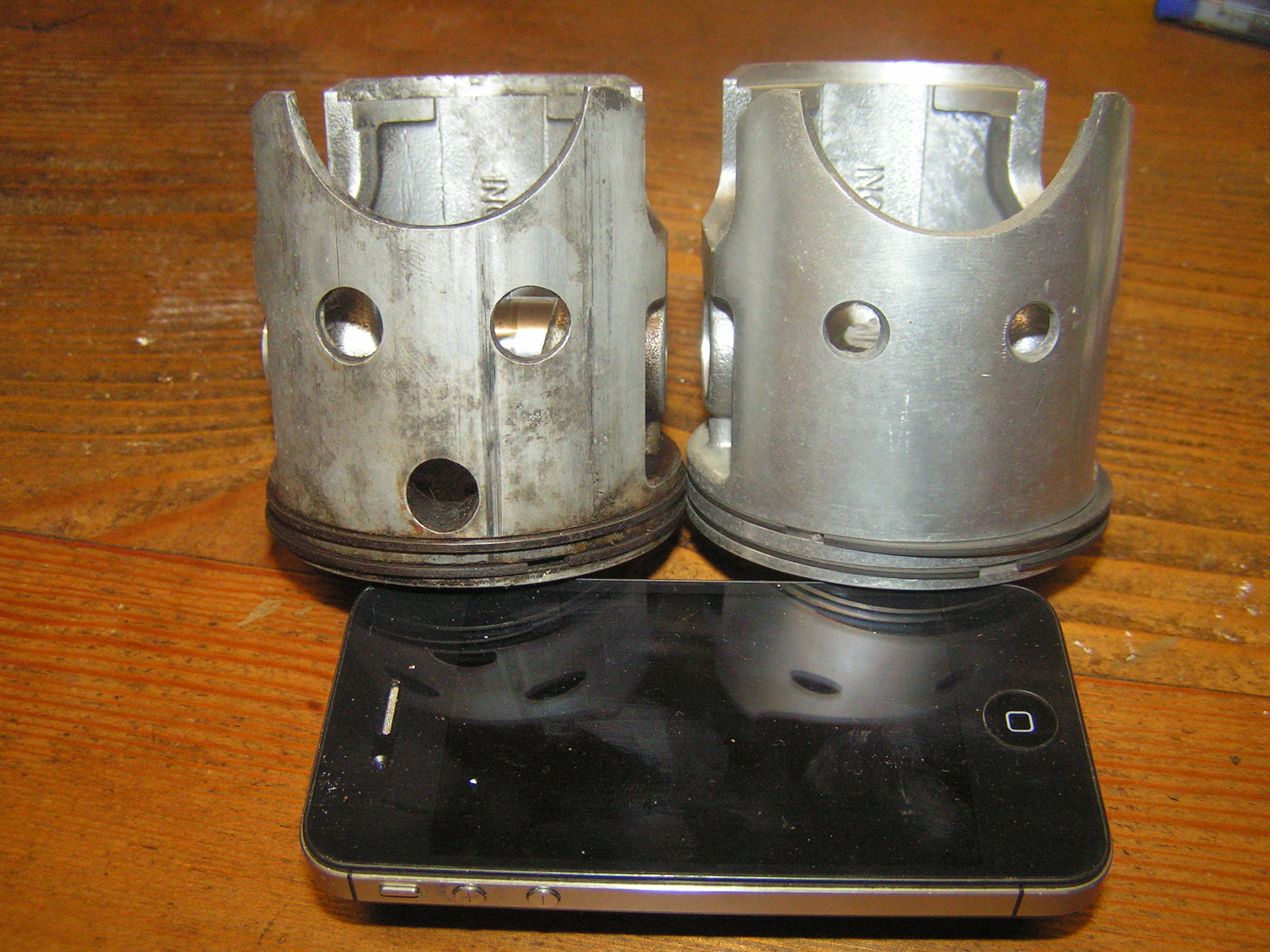

Hi Guys, Fantic reed valve pistons, both 245 and 305 can come with different configurations for the piston inlet ports, the middle port is a puffer port, directly opposite the exhaust port, doesn't really matter (in my opinion) wether piston has or hasn't got this hole, or can be machined if you really think it's necessary. In my experience, some pistons have no holes whatsoever, but can quite easily drilled/ machined  to original spec.

Most important plated cylinder and piston has to match.
So i can fit the Section piston in my 305 without problem ?
And same power ?
Fantic Tom, Would have been nice to have seen the markings (letters) on top  of the barrel and the markings on top of the piston (in your photos), these should correspond (be the same). Next, if the barrel looks OK (but it's hard to tell definitely without really seeing the barrel in real life) If for instance both barrel and piston are (say) B, then you would need to aquire a B piston kit (piston, wrist pin, rings and circlips) also (hopefully) would include a wrist pin bearing, but I would fit a new wrist pin bearing also. My experience has been, that to refit a noisey piston, will (at some time) damage the chrome bore, Of course while head and barrel is removed...to check the big end for excessive play, it's pointless to fit a new piston to a suspect bottom end.
