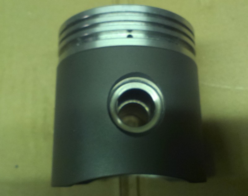

Hi Fantic Tom, I have heard that it's possible to deform the piston skirt to take up excess clearance. Does seem quite drastic and i've never found it necessary to try this 'fix' myself.
Pistons can also be sprayed with a bake on coating,this is a low friction surface which can be 1/2 a thou thick,so up to a thou on O/D. Works very well,my AJS is is running with it,I also had a pair of Ducati MHR pistons done as well. When I sold it the new owner couldn't believe how quiet and smooth the engine was.
Sounds interesting too, how do you use this? And is it avaliable in a diy kit?
The piston is masked up and sprayed just like a paint job,its then baked. Its sacrificial so will do no harm to anything else in the engine.Hopefully the Yamaha piston for my Ariel build has just been done. Attached is the piston in my AJS whch is an Australian JP one, all I could get at the time and does not have a brilliant reputation due to high expansion / noise problems. We were able to halve the bore clearance suggested, to 3 thou because of the coating.It has worked the,engine has never been noisy,picked up or used oil.
Sorry the pic is blurred - Didn't have me best specs on...
Edited by jon v8
