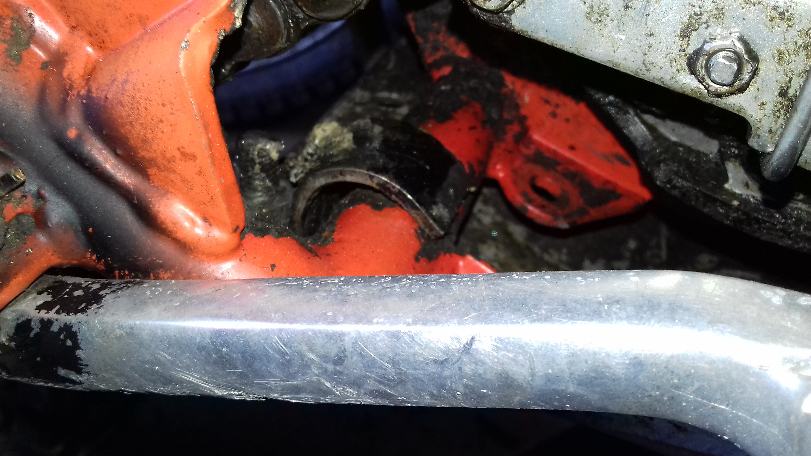

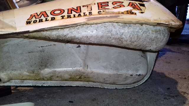

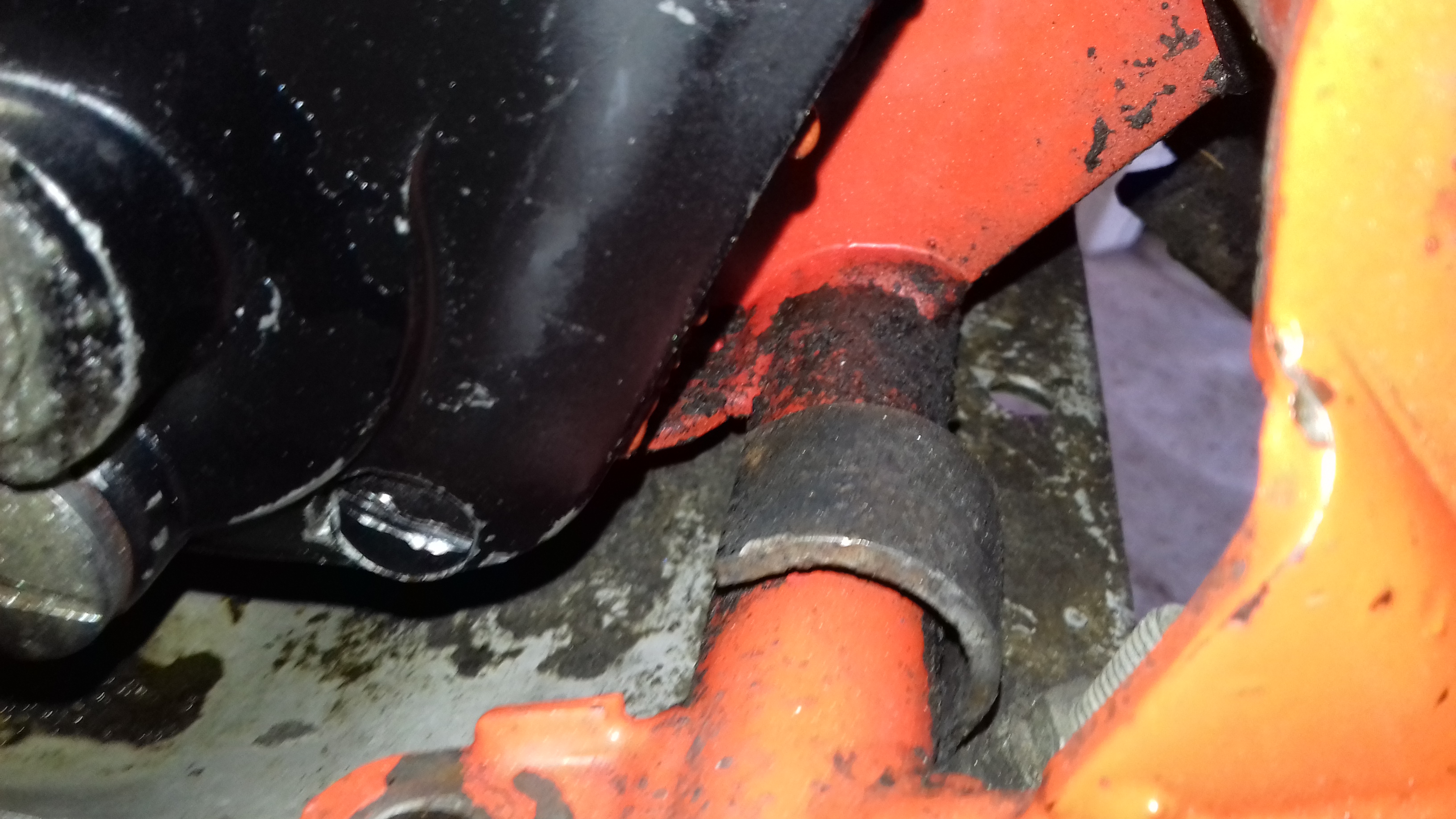

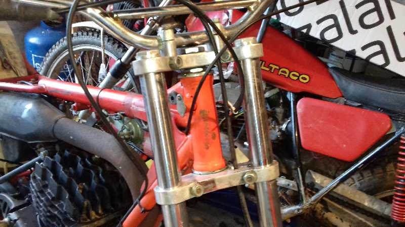

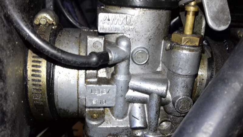

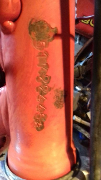

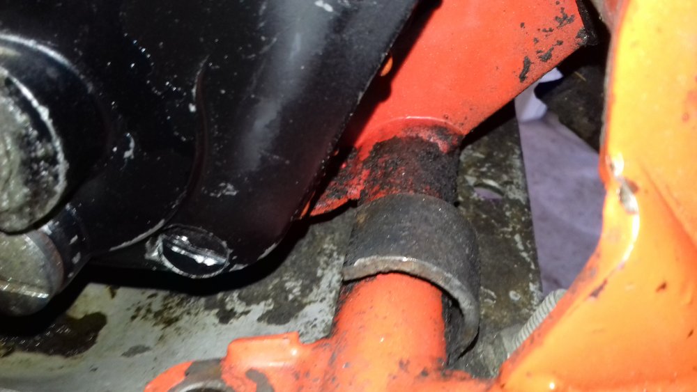

April 1, 20179 yr Author Hi, I picked the Montesa up yesterday and I have a few questions. The frame/engine no. is 51M22445 there are definately not any lower frame rails. After a cursory glance it looks like the bash plate is just hooked on at the back of the engine and doesn't give any rigidity. Also, are the forks standard, is the fuel tank road legal, it looks like fibreglass, and is the carb original ? pics to follow.

April 2, 20179 yr Carby and forks and frame look right for a 1981 349. Front wheel having a gold rim means it is from a later bike. I'll have another look at it

April 2, 20179 yr The bashplate is not the original one and doesn't fit very well. I wouldn't worry much that it is not working as a stressed member with those rear mounting clips like that. The motor castings are easily strong enough to act as the frame member as long as the engine mount bolts are kept tensioned and you are not planning to ride at world trials championship level or race it over the jumps on a modern MX track.
April 2, 20179 yr Author I'm a complete beginer so there's no danger of that. Will the plastic tank ( repaired with fiberglass) be road legal ?

April 2, 20179 yr UK Montsas usually have an aluminium tank inside a fibreglass cover. I'm sure you could get one of the aluminium tanks and use your tank to make the cover from. Sorry I don't know the road-legal status of fibreglass tanks in the UK in 2017
