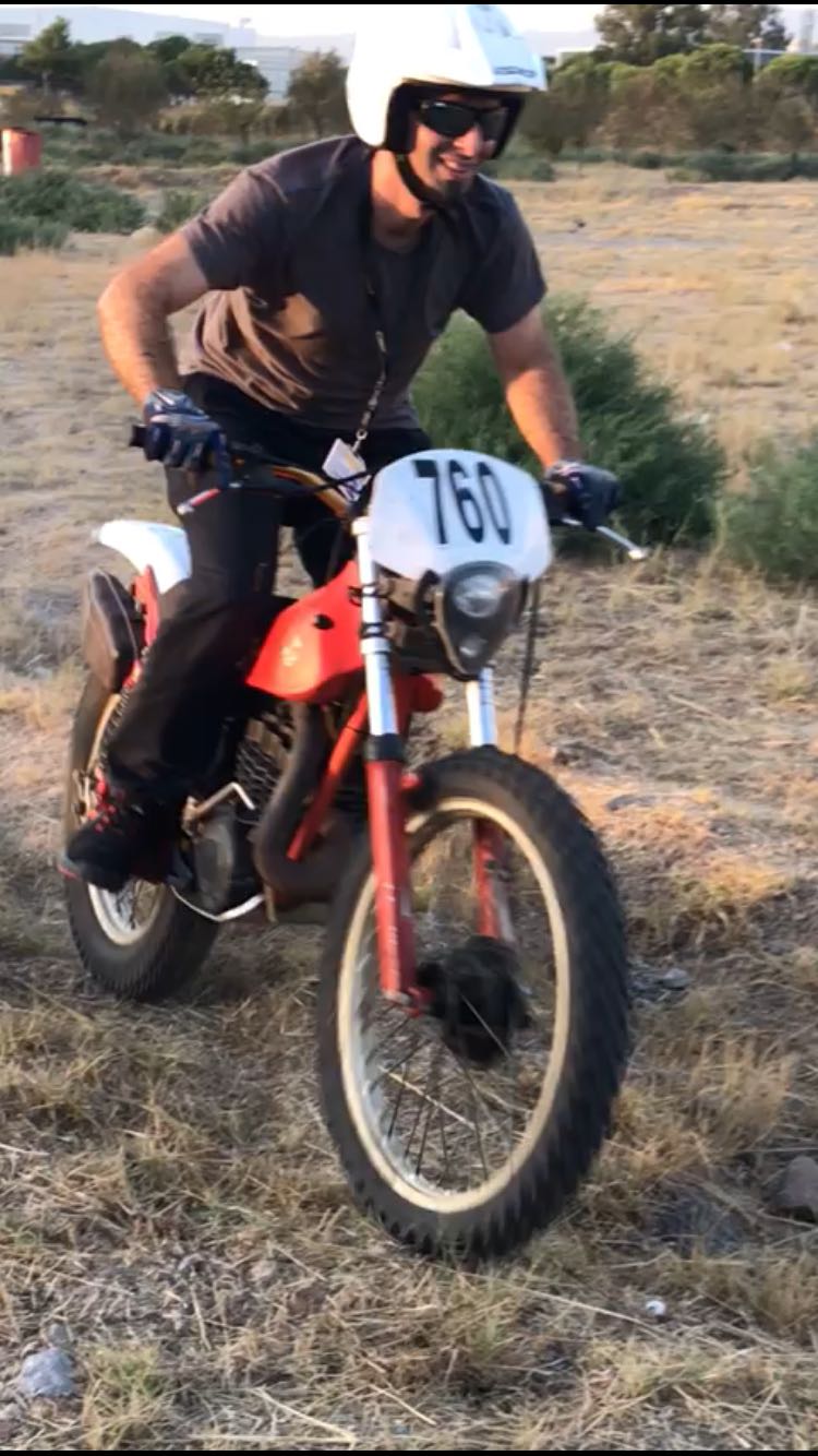

Well finally first ride!!
a few things still needs to be sorted . even with new seals, fork is leaking little bit, clutch oil is leaking , need a front fender , but it starts very easy at firtst kick.
This was the first time I have ridden a trials bike, it feels very light and fun. the engine is strong and seems un stoppable. I need some time to get rid of clutching addiction.
I am open to any advice and experience.
