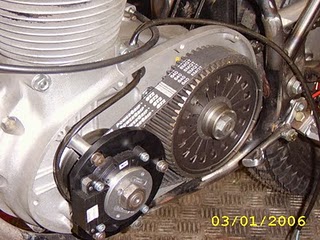

Can anyone tell me how to get in contact with Pete Kirby or where I can purchase his clutch conversion from for a cub.  Also does anyone have any pictures of this setup.
     Mark…

Hi Spen,  i notice ur photo was from 2006, have these clutches been around for 14 yrs?
