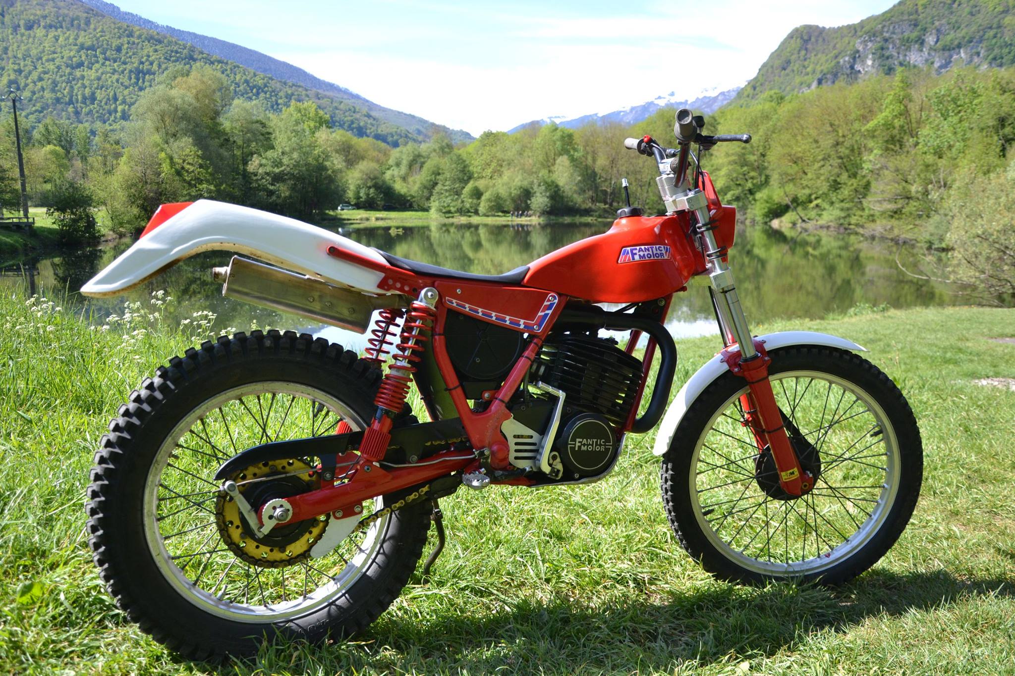

May 25, 20179 yr hi to all fantic addicts ! i've just bought an oko flatside carb (black one with chrome plated slide) i have some problems so set it up correctly,,,so 'id like to know if someone could give me basic) settings for a 300 fantic pro... other question, is a vm26 mikuni the best option for this bike, as i own a genuine one.. all point of view will be welcome cheers from france ;-) nicolas Edited May 25, 20179 yr by lancelot
