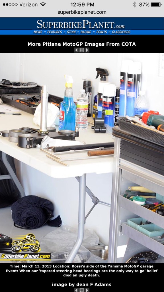

I have never had any dramas with the original ball bearing style and unfortunately the same can't be said for the tapered type in most gasgas bikes I've had in the last few years which seem to require more maintenance than the ball bearing style. I also recall reading somewhere that the Moto GP bikes all use the ball bearing style because they give better feeling.
Cheers Greg
Edited by sherpa325
add photo
