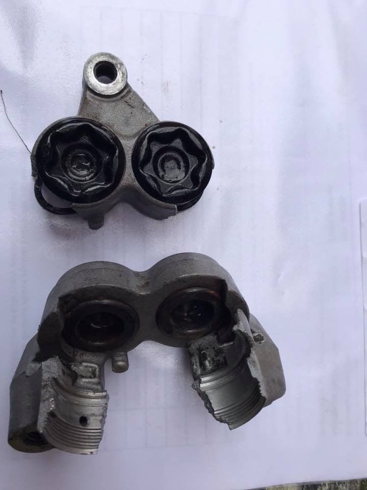

  • Front calliper broke apart today didn’t hit anything just cracked apart that’s 2 I know off anymore had this failure ? Bikes only done 90 miles 3weeks old

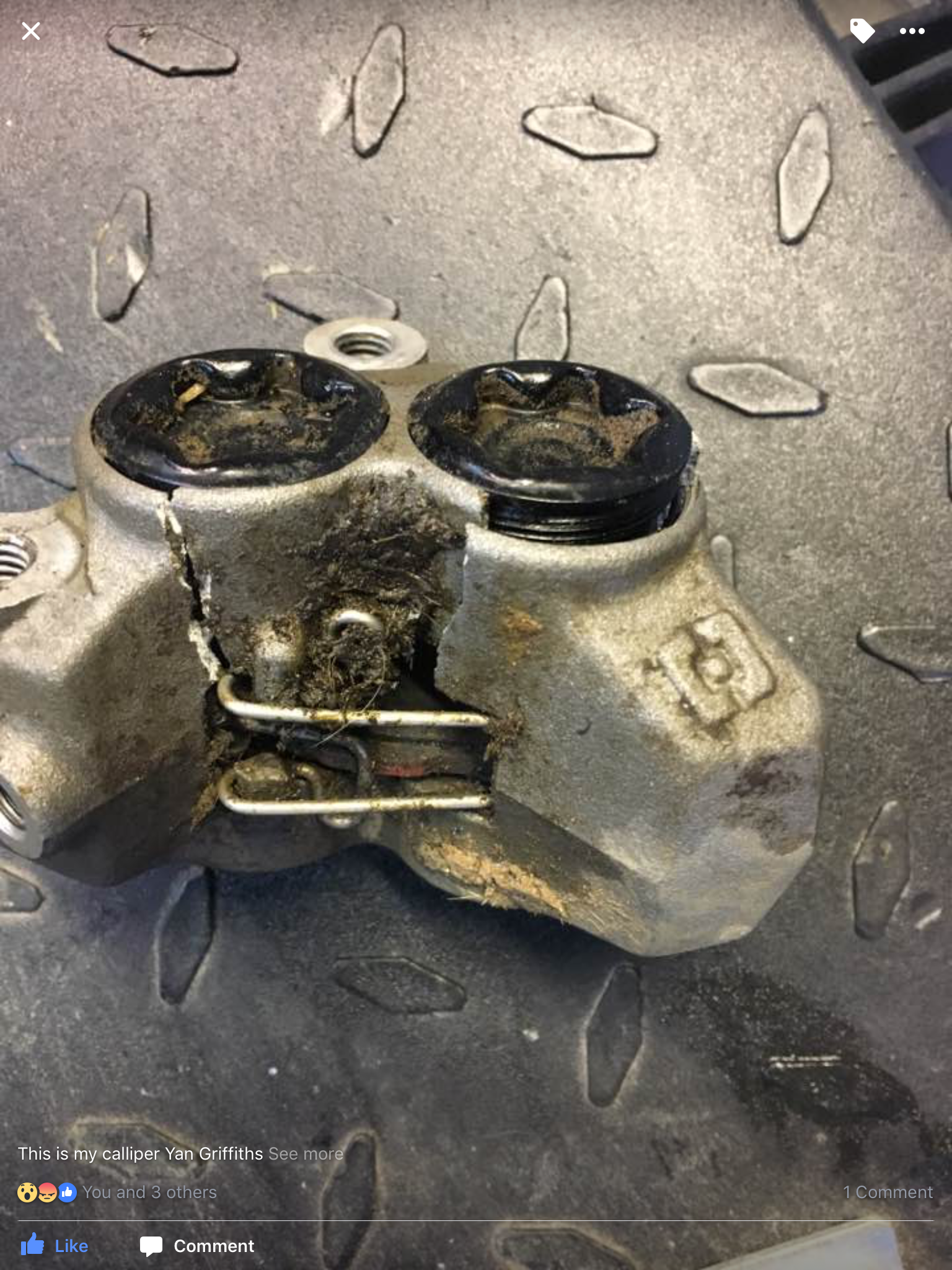

Here’s another one that broke last week on FB page ?‍♂️
Straight back to the shop chap as said take it up with them then follow it up with a call to Honda UK ask to speak to someone high up as you can get in Honda Sales UK . I'm new to Montesa so don't know the bikes that well is the calliper shared across the 4RT an 4ride ?. I'm looking at the pic's as an Engineer an its a Catastrophic part Failure and they should move quick on it. that said it took BMW 4 years to sort out the front spindle snapping off the fork leg's of the F650's after saying it was not a problem how you like to lose the front wheel off a bike

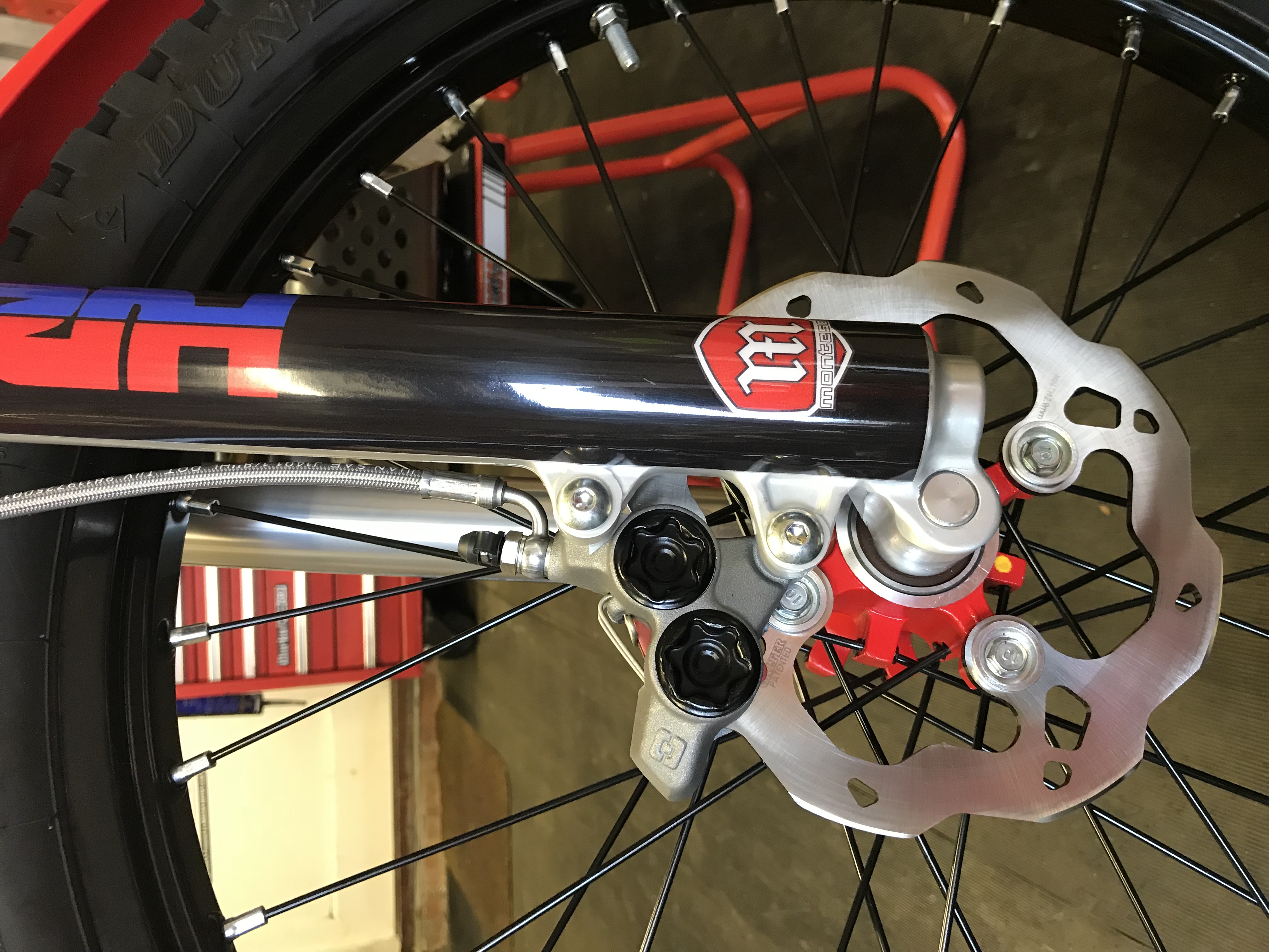

extra info
Strange - they appear to have failed in different places..
The mounting hole on the top picture looks a little fretted as may be a bolt loose but bottom looks to be just split.

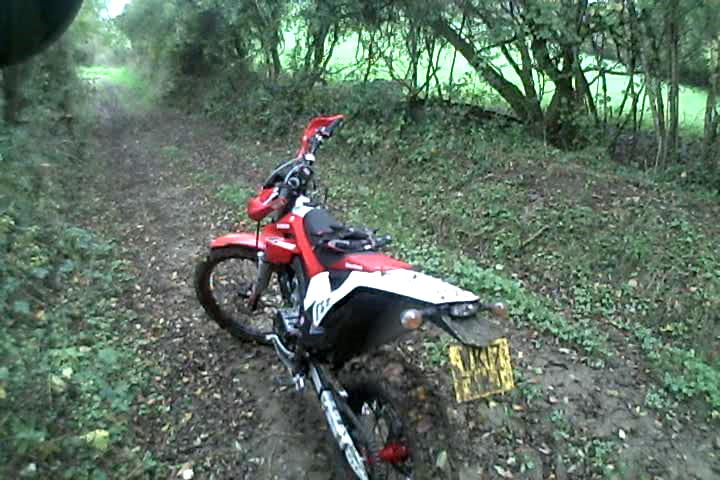

Was on a downhill steep
rd but shouldn’t have been a issue ?
this is a casting defect, porosity or oxide film. it can lead to a recall but in some cases this can be a singular fault. For example when permanent mold casting, first couple of pieces following the start of production, comes with defects due to thermal cycle. it is in fact possible to detect them with x ray and most of the quality casting shops make %100 x-ray inspection. if the broken part is inspected by an expert, the problem can be understood.
