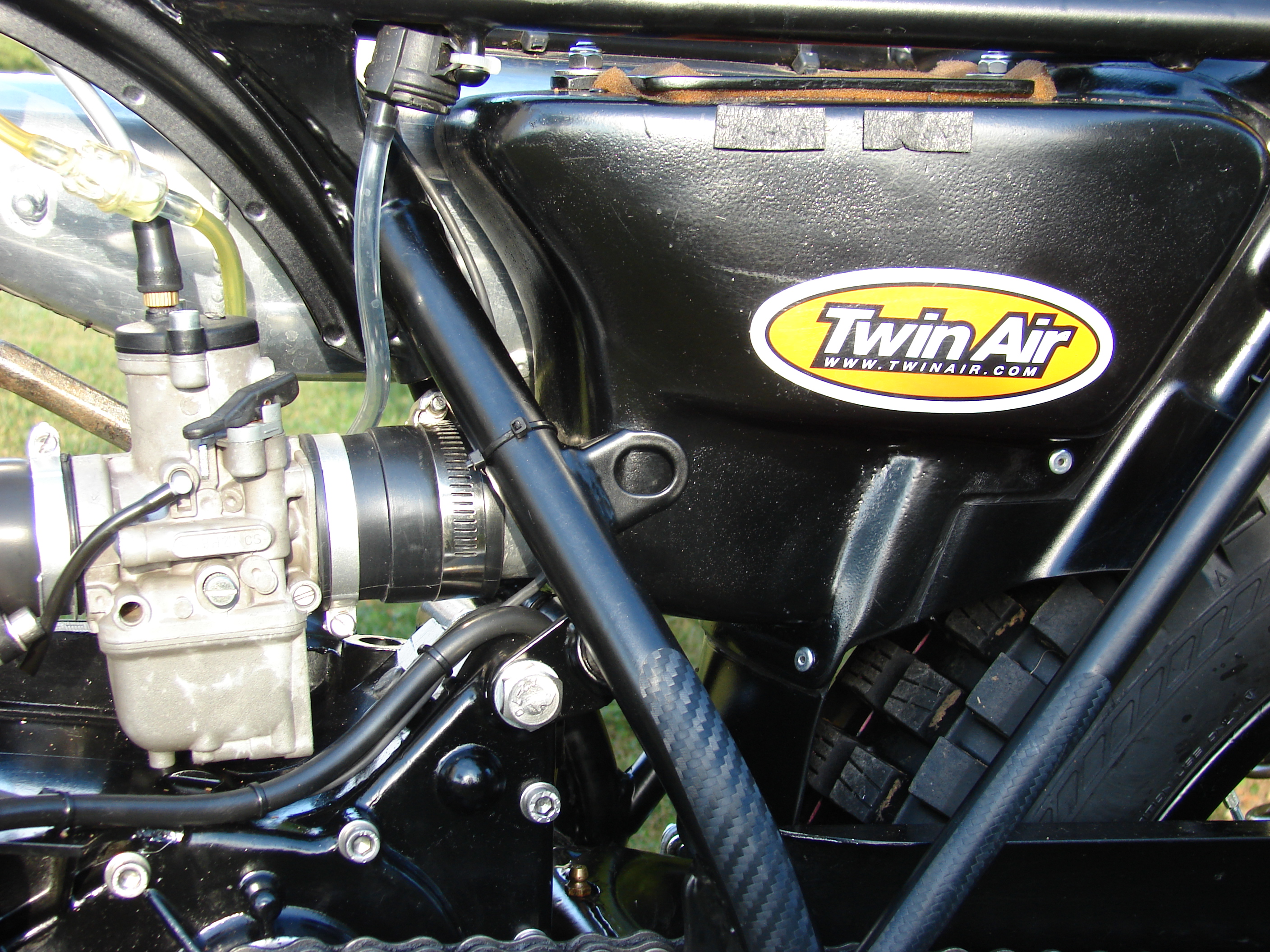

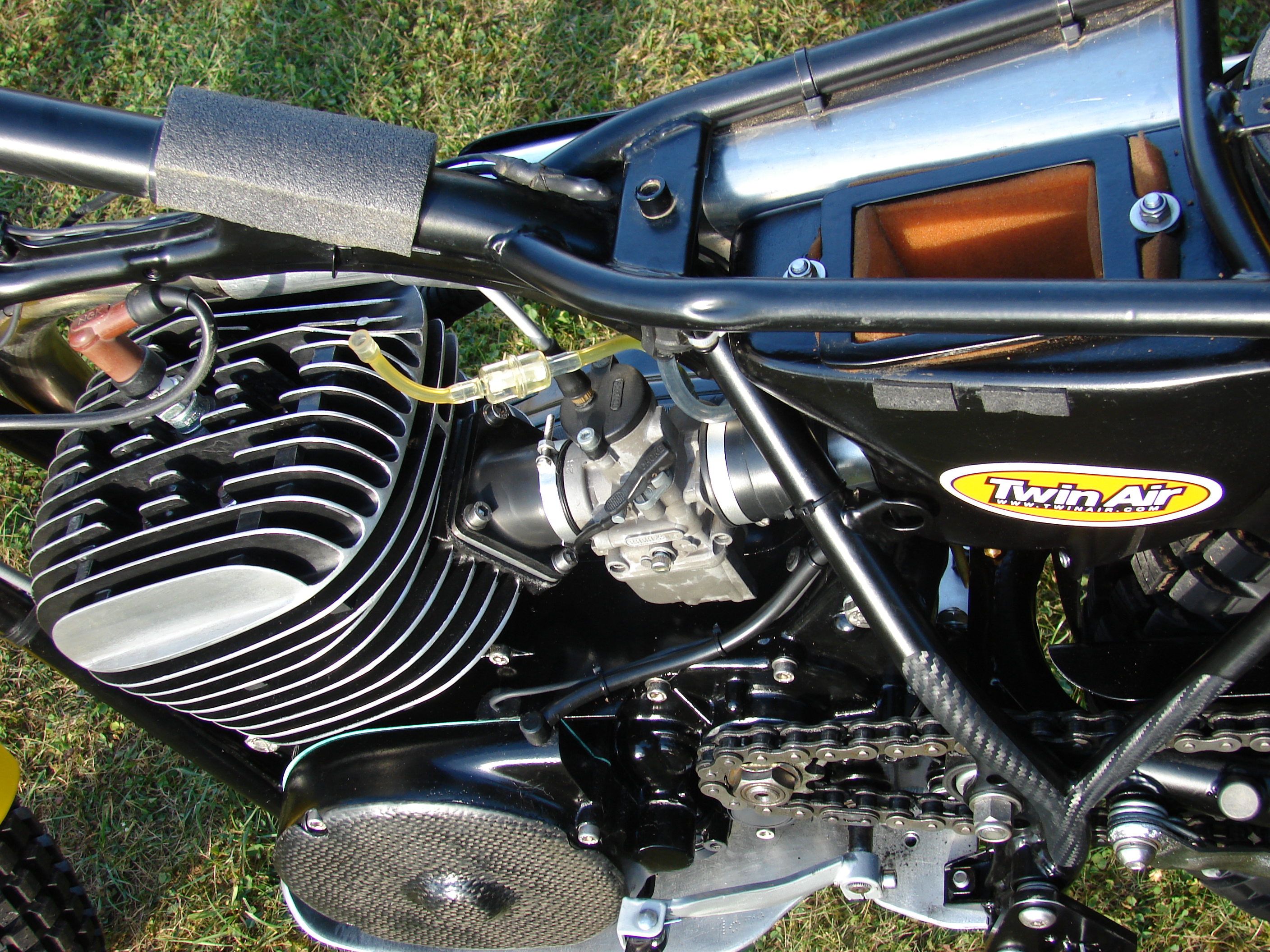

These carbies go very well too. I recently fitted this OKO to my A model when the original TK carby started to suffer from needle and needle jet wear
