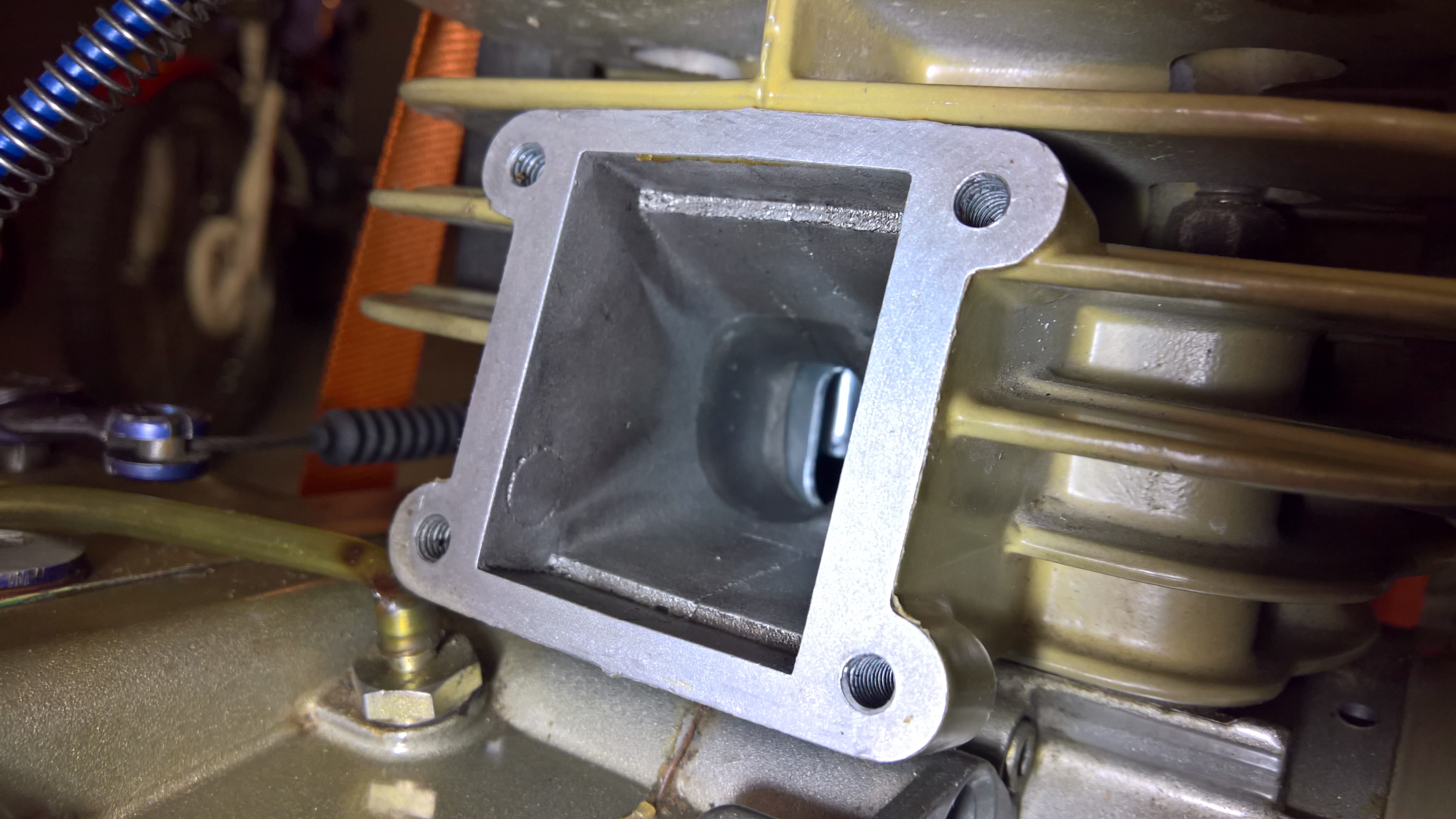

Here You can see how wide and well the carbon type Boyesen reeds are opening at a Beta TR 34, the shadow was created by the fuel gas mixture that constantly washed the walls of the intake.
It looks too me that the carbon reeds open very well. They worked flawless but one reed showed a bit wear where the reeds hitted the cage. The reeds where too not parallel to the reedcage, thus replaced them now after 15 days of riding, (Motoalpinismo).
Wear after 15 days really doesn't sound great.
