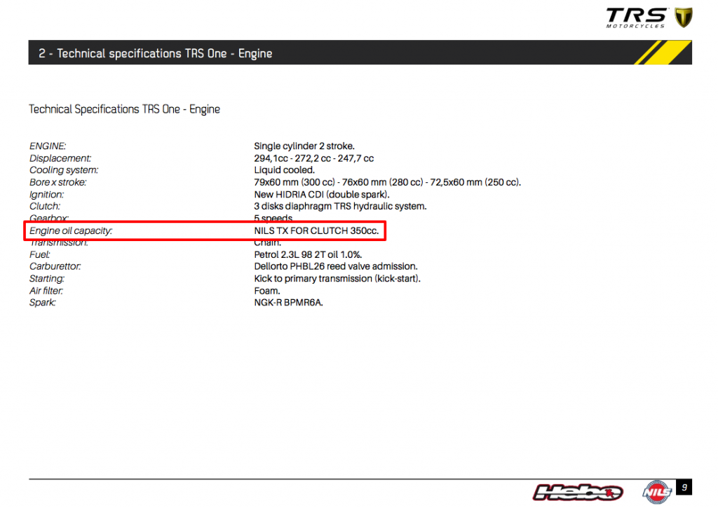

Definitive is as per the user manual (below), but your TRS dealer may be able to offer up an alternative. We have had very good results with GRO Extreme 75w
The current recommendation only became 'definitive' when TRS got around to inking a deal with NILS. Prior to that they spec'd ATF, which is likely what most people in the US use in it as that's what the importer still recommends. That said, any light gear oil like silkolene light, Maxima MTL, etc will also work.
