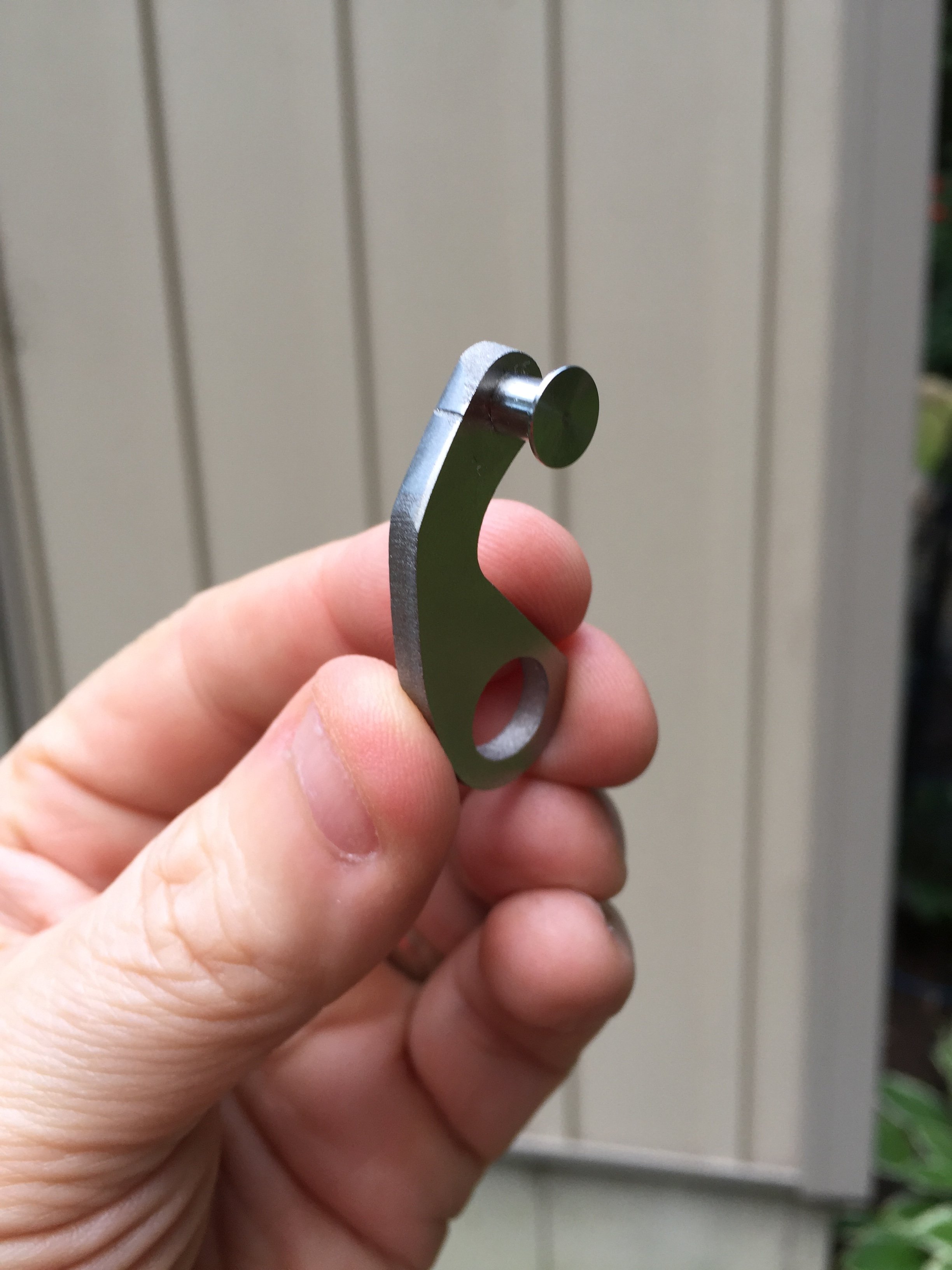

Cam follower arm with pin. First attempt at press fit and stake with punch to see if it’s reliable. Now to abuse it and see if I can pull the pin out. Is it reliable enough to put a bearing on? We’ll see. (edit) Nope, bearing pin too short for my comfort. Pulled out way too easy. Back to the drawing board and a longer pin that can be mashed with a press.

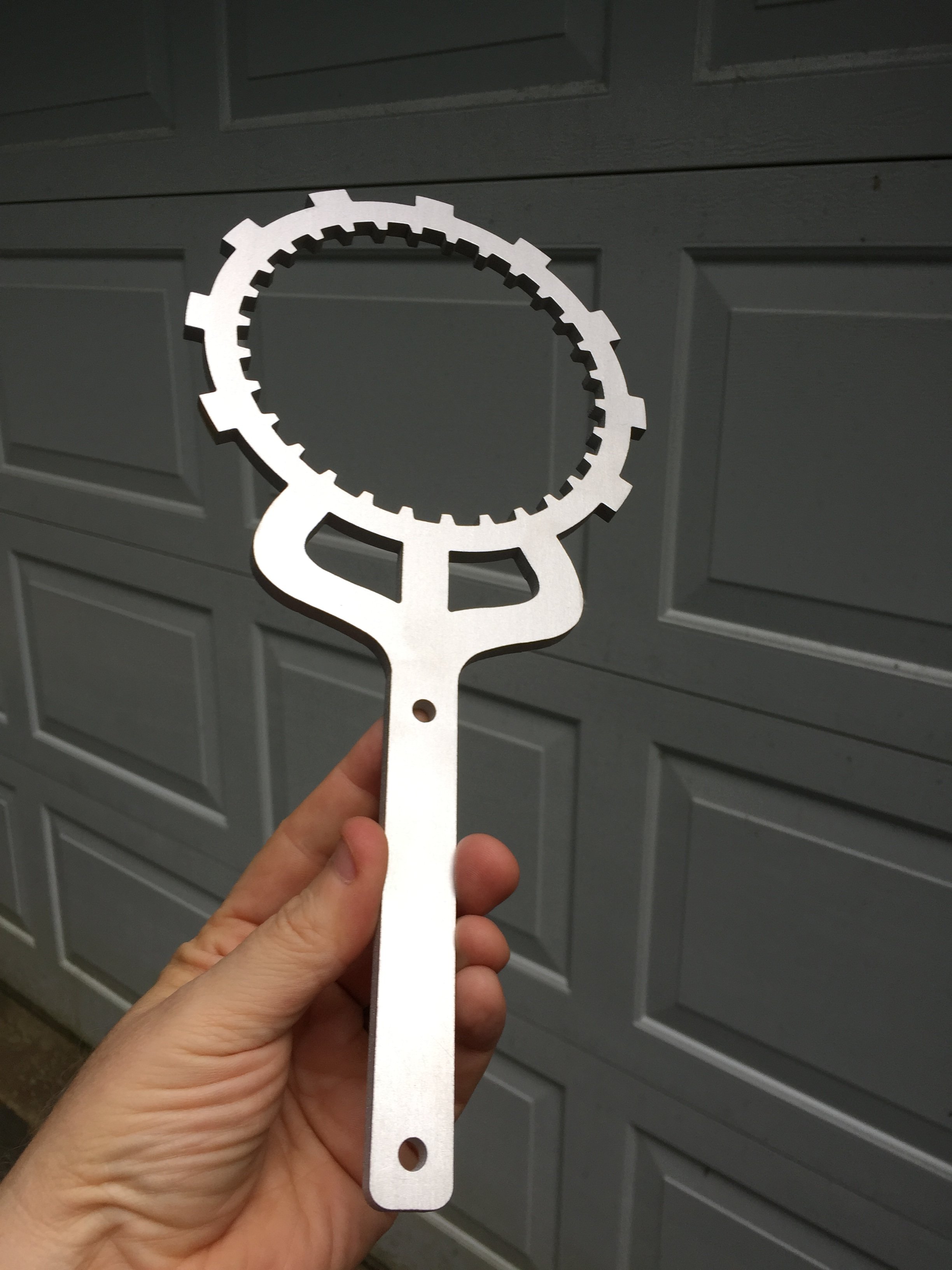

And a clutch holder tool. I love emachineshop. Couple hours on the computer, wait a week and custom tools appear!
