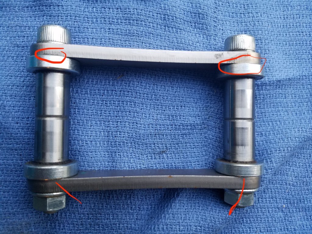

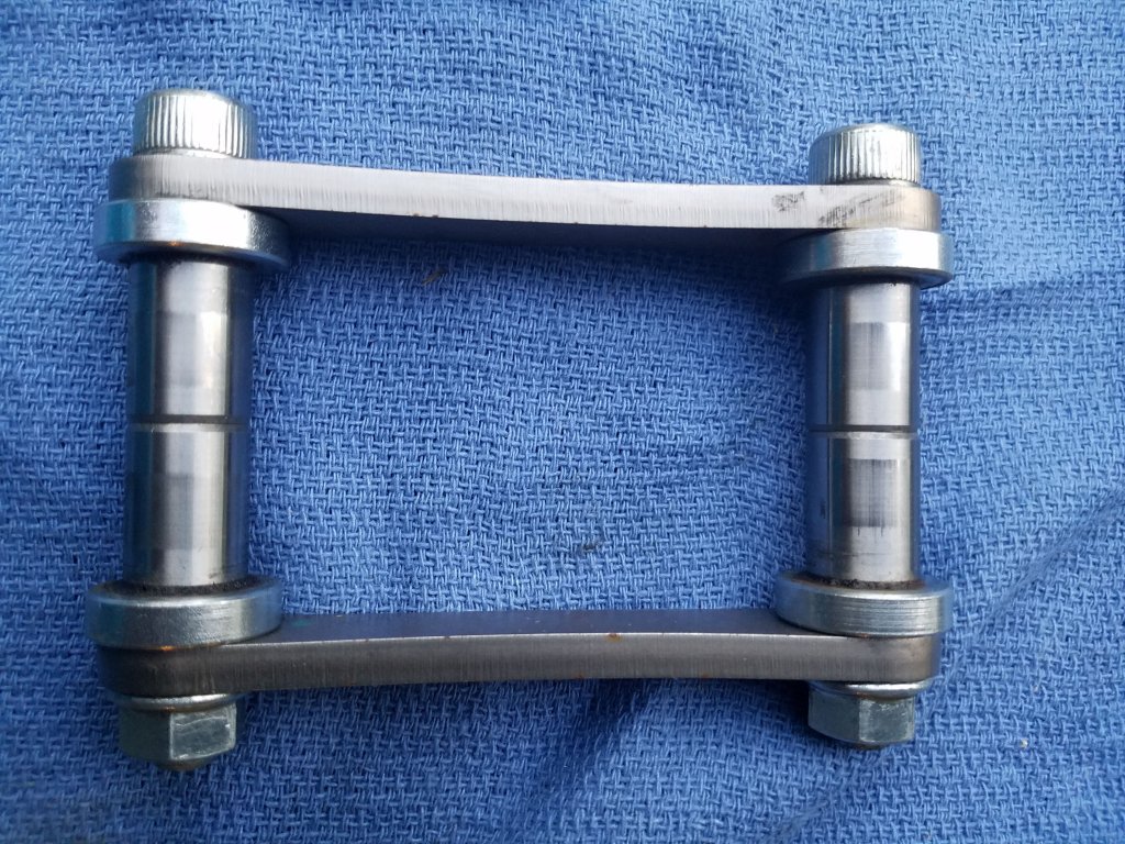

Linkage.thumb.jpg.0e03f2c8ae09afa2f08a47b313fd2653.jpg.b97ddc746f403fc243f72e115eca4ff2.jpgDid you put o-rings where I have thee red marks?  Or somewhere else?  What size/diameter?
i got a box of assorted o rings and mine are fitted where the green circles are
InkedLinkage.thumb.jpg.0e03f2c8ae09afa2f08a47b313fd2653.jpg.b97ddc746f403fc243f72e115eca4ff2_LI.jpg
Oooo.. you doubled them up against the Lip Seals in the “triangle” eh?
  • 2 weeks later...
Where you have the green circles is where we put them, have to say the newer models are better sealed, but we still use extra O rings. Only last week I stripped one down after about 18 months use, no play in the linkage and no signs of water ingress, rust or wear. Bye, Peter B.
It's a good tip - how many O-rings or at least how thick of ones did you use?  There's quite a gap between those spacers and the "triangle".
