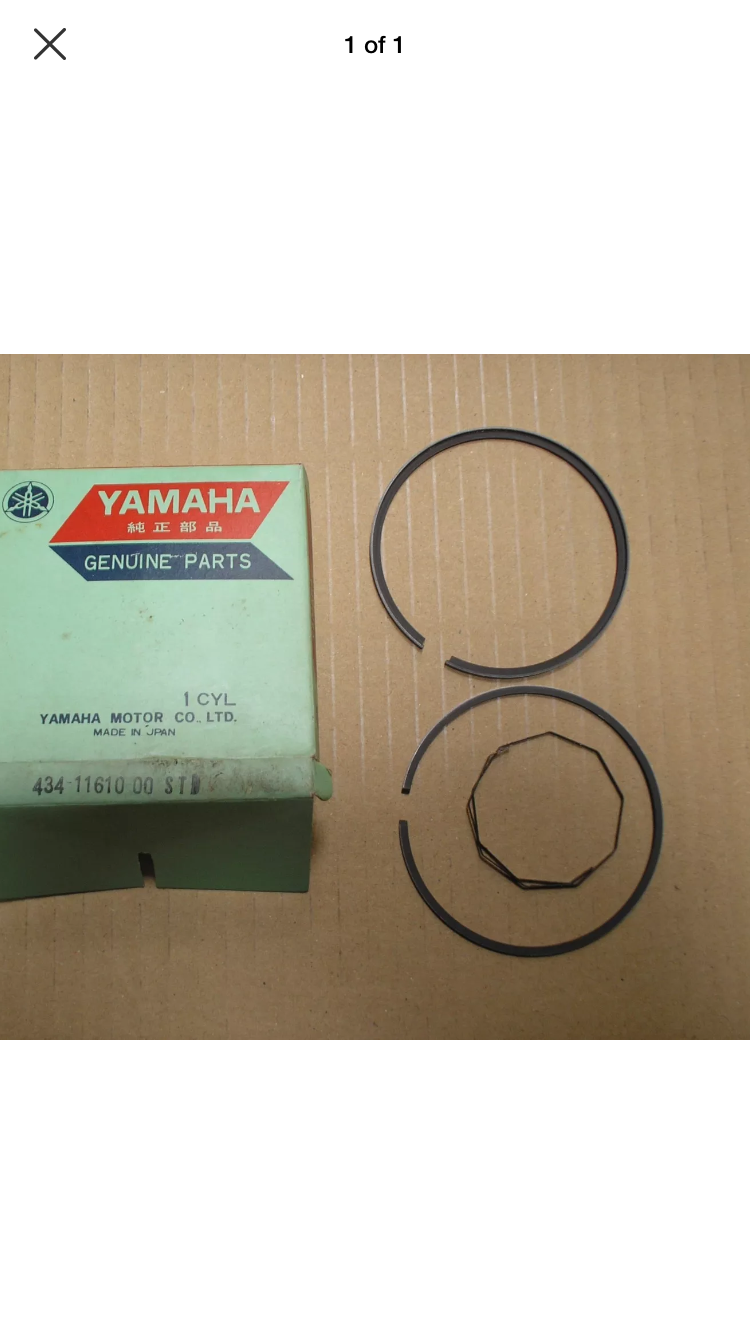

when you say an L ring piston ring do you mean the top ring is in the shape on an L and the bottom is Normal, as this is what is on the piston. There is no play so would be good to just change the rings I've brought these since which I'm hoping are the correct rings for it

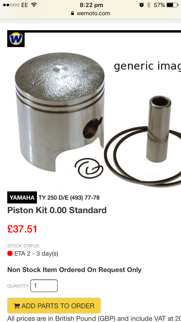

I also have a piston kit which I was assured would fit even though it says it's for a d e model but wasn't sure still so brought the genuine rings after too
Top ring has a L shaped section & the piston is stepped in above the ring land, L shaped ring goes right to the top of the piston. Sounds like that's what you have & bought
The piston kit you have shown doesn't have a good reputation, can be noisy very quickly even when bored to correct size
Last sentence, +1, concur - i was warned about these too for the mono. At a third the price of the real McCoy it tells you summat....
