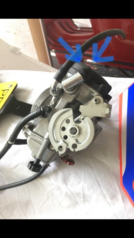

I’ve just removed the carb from a new to me Factory 4t as I was having problems with it occasionally popping and stalling off idle.
When I’ve removed it I've noticed a rubber bung on a breather pipe at the top of the carb had perished and split.
Two questions:
1- would that split cause the problems I’m having?
2- is this bung normal (it seems too smaller diameter for the pipe?)
Thanks for any help, it’s a bit more complex than the 2t carb I’ve been used to!
Yes, that decomposed rubber cap will make your bike run crappy and its a common part to fail. That plugged pipe is for equalizing pressure on street bikes with multiple carbs and not used in your application. Should be able to find one in a automotive parts supply store...hopefully better quality. Good luck

Brilliant, thanks very much.
