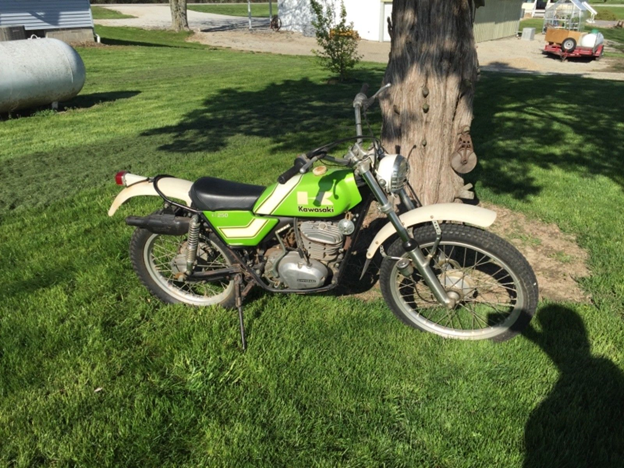

I picked up a totally original KT250 last Friday, something I didn't know still existed. With all of the TV shows where people doing "picking', I thought I'd never find another 100% original bike, ever.
The bike was a one owner that was bought in 1977 from a shop in Effingham, Illinois. Bike has 2081 miles and has been stored for many years.
Of course the tires are shot as well as the chain / sprockets. Plastic decent enough. Tank very nice with one small dent near left knee area. Has lights. Seat good. Piston was stuck, however.
After a days soaking with PB Blaster, the piston freed and cycles nicely. Bore shows minimal wear and is stock size.
I'm thinking minimal investment will have her going soon. Only problem now is the carb.
It's a stock unit and the slide is frozen. I've been using PB Blaster on this as well without luck. I don't see any signs of calcium buildup or anything. She's just stuck.
Any ideas to free it up? The bike came with the original title and I'm having thoughts of getting plates for it.
