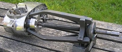

This is what I made to remove Cota 348 primary drive pinions. It worked a treat. The 247 drive gear is very similar to the 348.

Nice DIY engineering there. I was hoping to buy something suitable, but there's not a great deal of clearance under the gear and the force reputedly required necessitates a pretty robust tool.
There are gear pullers made for automotive application. Feetupfun has fabricated a workman like puller which with a little work you could either make or as the mechanics to remove the gear are demonstrated a skilled engineer should be able to perform the task. Hope you have sone luck.
Thanks again everyone - some really helpful advice and guidance (as always). I think I'll try the Machine Mart style puller kit and see how it goes from there - hopefully this, in combination with the hints and tips posted by others, should see the gear off and the job done.
I made a machined part which fits over the primary drive and allows a large puller to "Grab" it. Similar to the one pictured but more chunky.
You are welcome to borrow it, I did have some images, but I can't find them, you'll have to use a puller, but even a monster puller fits using this adaptation.

Found an image
I borrowed the puller, but I still have the adapter as pictured.
That adapter looks just about perfect! As I've just knackered a second puller, I think it's time to get something more substantial in the mix.

A MASSIVE thank you to Yamanx for his generosity lending me his puller adapter.
Have to say, an amazing piece of engineering that made removing the gear a relative piece of cake... still can't believe how much force was required to separate the gear from the crank (air impact socket on a 3' breaker bar, plus gentle persuasion with a hammer - shocking the puller/crank taper at  various degrees of tightening force), which I'd have failed miserably at were it not for the adapter!
