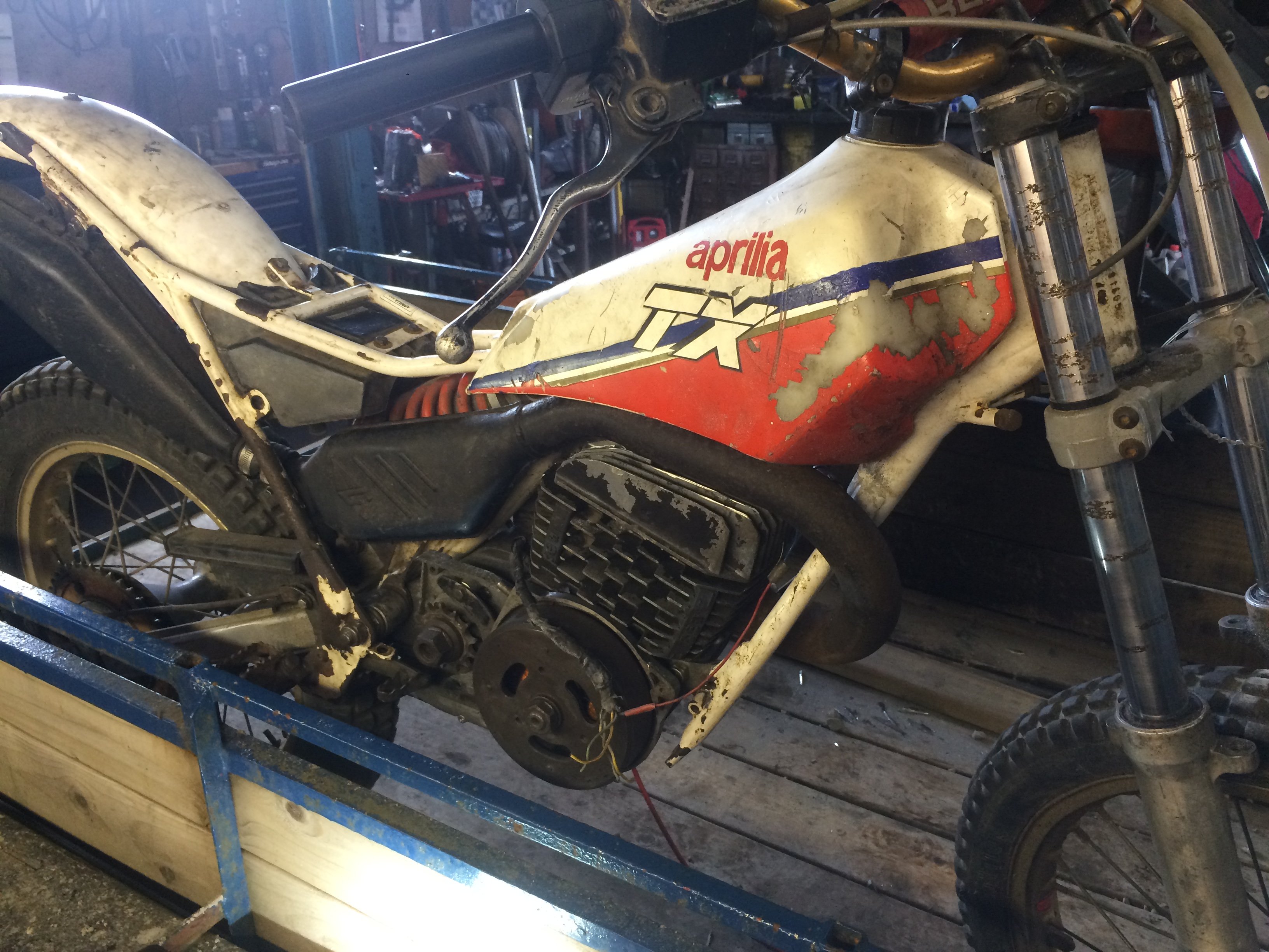

I have a tx 240 but the disc valve came loose and jammed,
I would say it's a catastrophic engine failure as the flywheel slipped, crank gears slipped, disc valve broke in 2. Flywheel previously welded on and crank taper is in bad shape.
Cylinder and piston are fine and bearings all ok
Where would I start looking to get a rotax 240 engine to replace my old one or part to fix her.
I bought a rotax 122 engine but it would require some fabrication to work- drive sprocket won't fit its too low for the chain. We're worried about the strength of the frame if we start cutting.

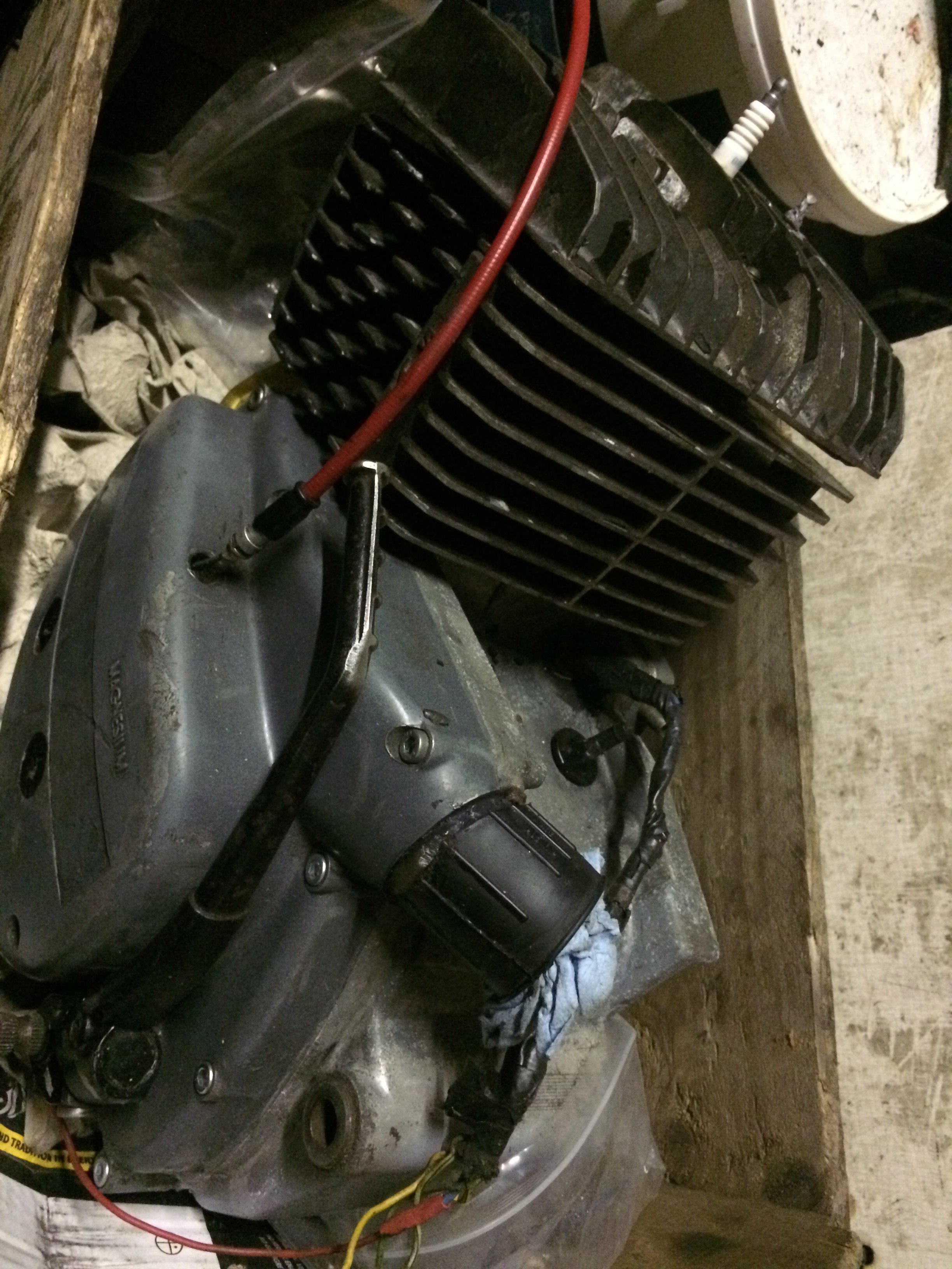

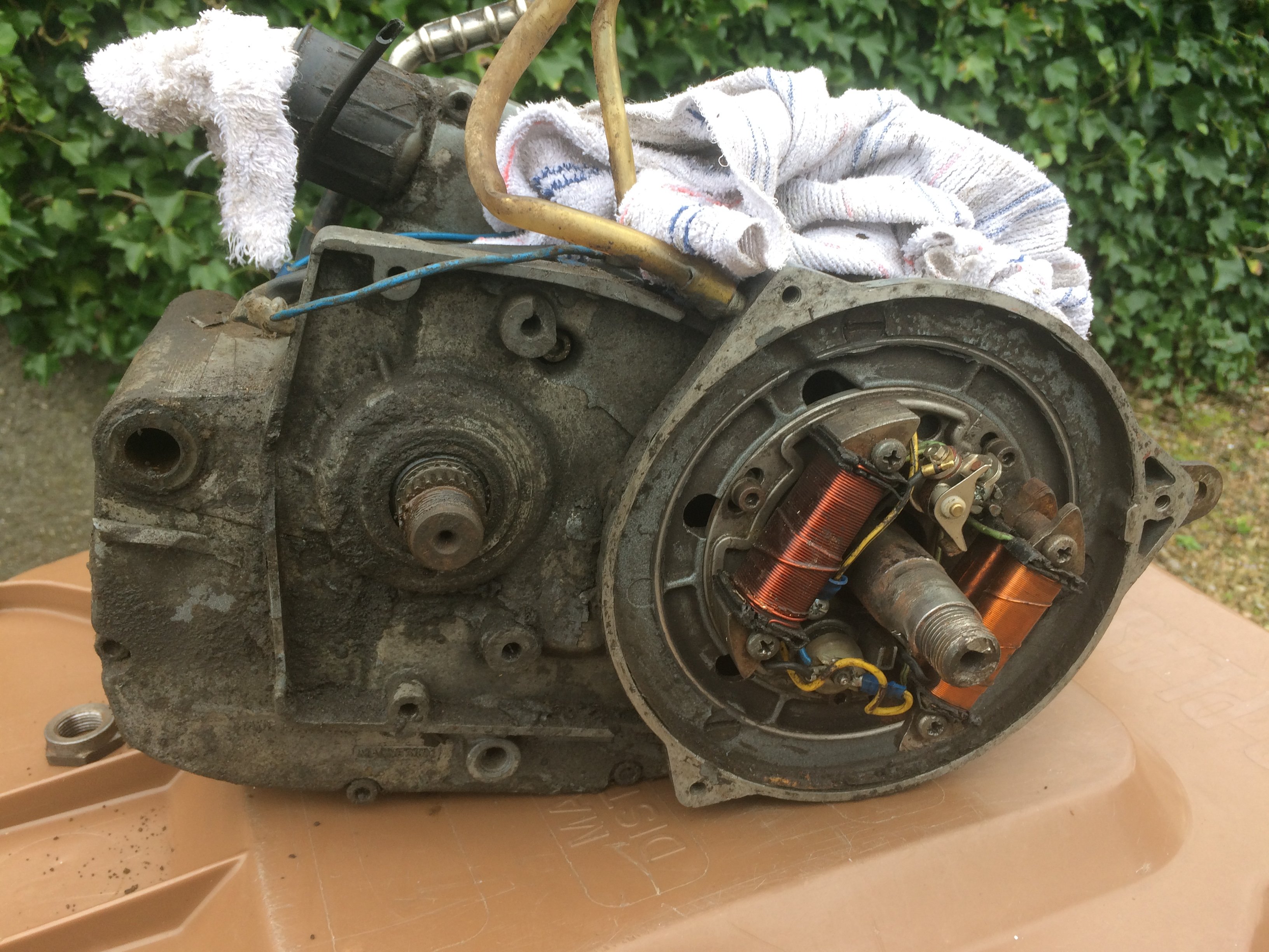

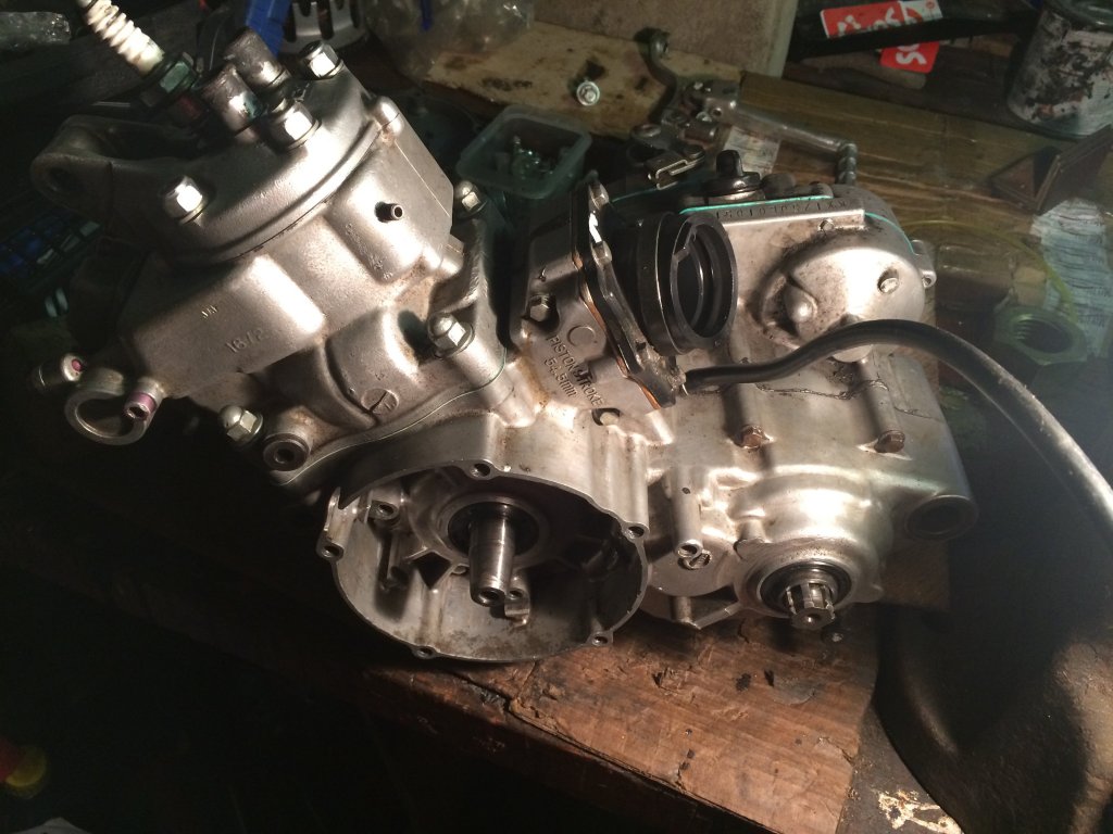

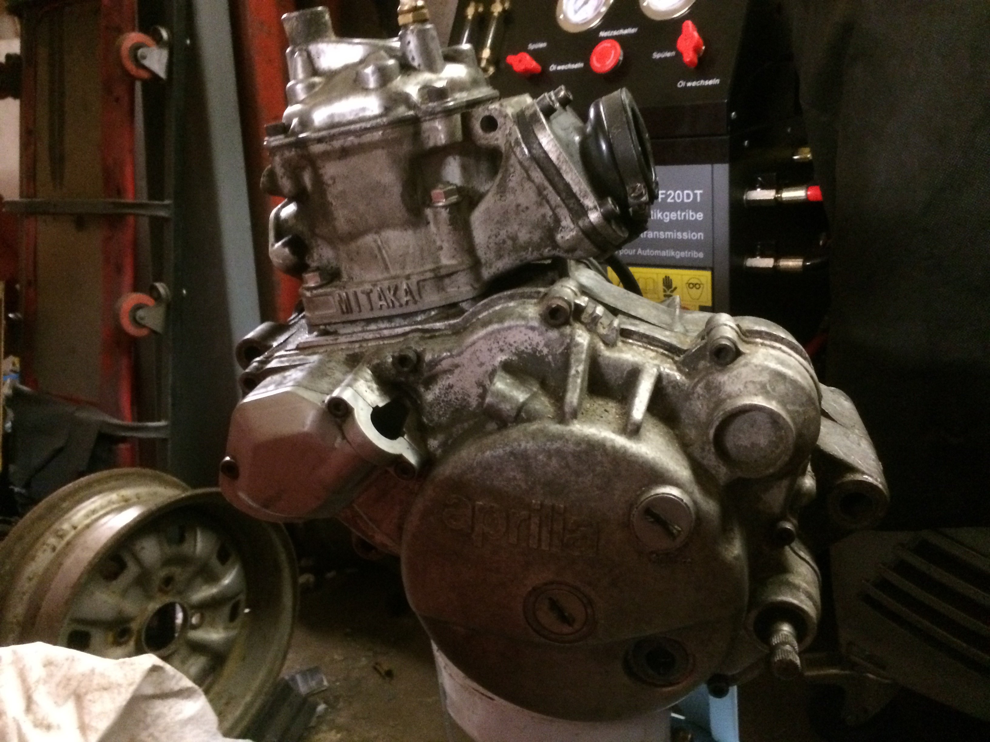

Hello all
The engine has arrived and is in my possession. Due to the way things are at the moment I can’t get to the frame to get the engine in. However patience will win and I’m not putting my dearest friends at risk over a bike.
Allen’s used trials spares got the engine for me for which I am very grateful.
Here is the engine

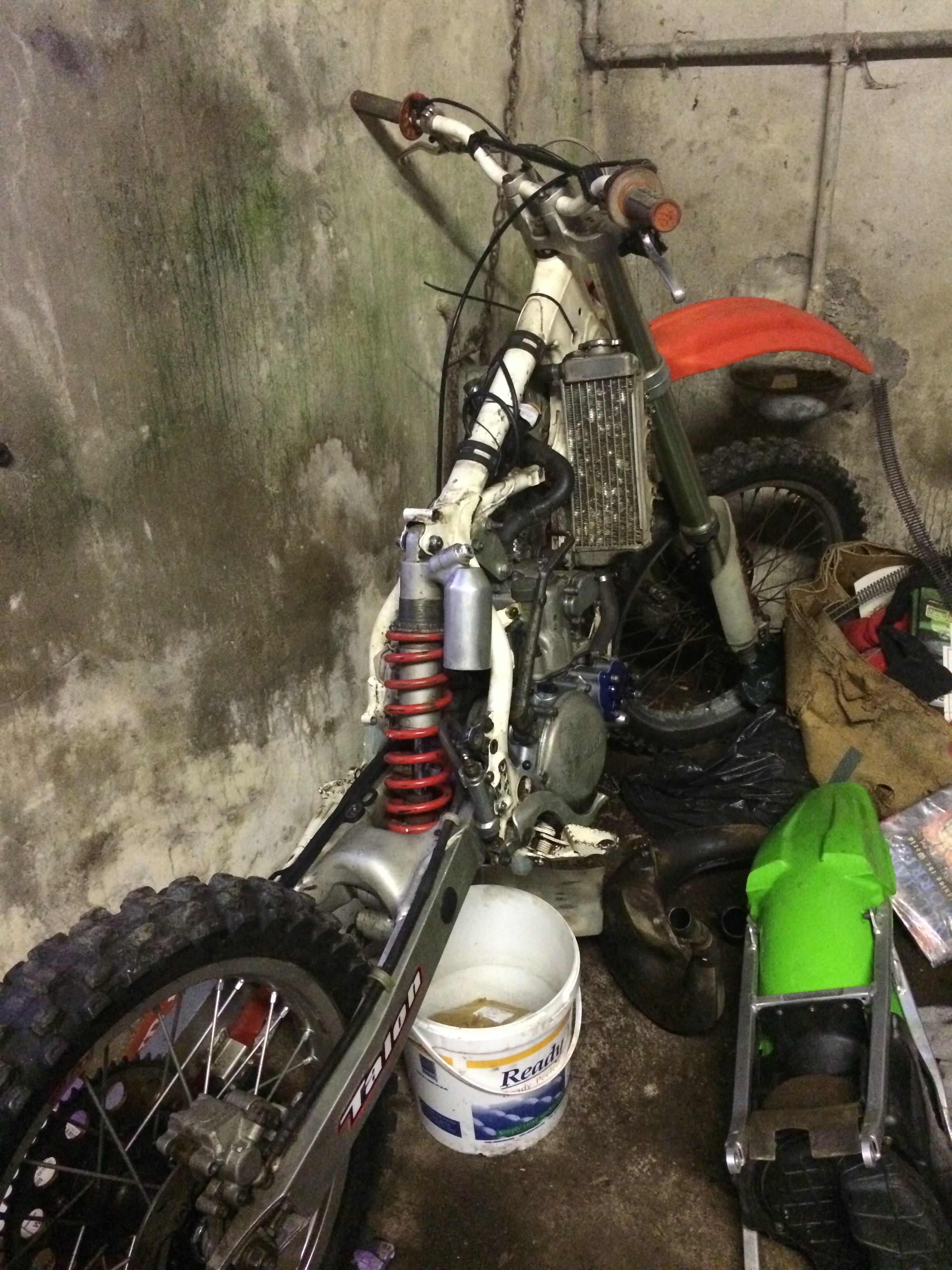

I am also building at a 1992 kx125 9279B692-AE50-4F91-9530-99BF6819FD99.thumb.jpeg.99c78a835f7776328e64c8d0924bb2ef.jpeg1D735633-1F5F-4205-AF56-8BF6A06A50DC.thumb.jpeg.233397abac785dff3349493ff1cbafad.jpeg
and a 1990 CR250
Hopefully these photos and the much awaited news of an engine for the tx will lift your spirits in these challenging times.

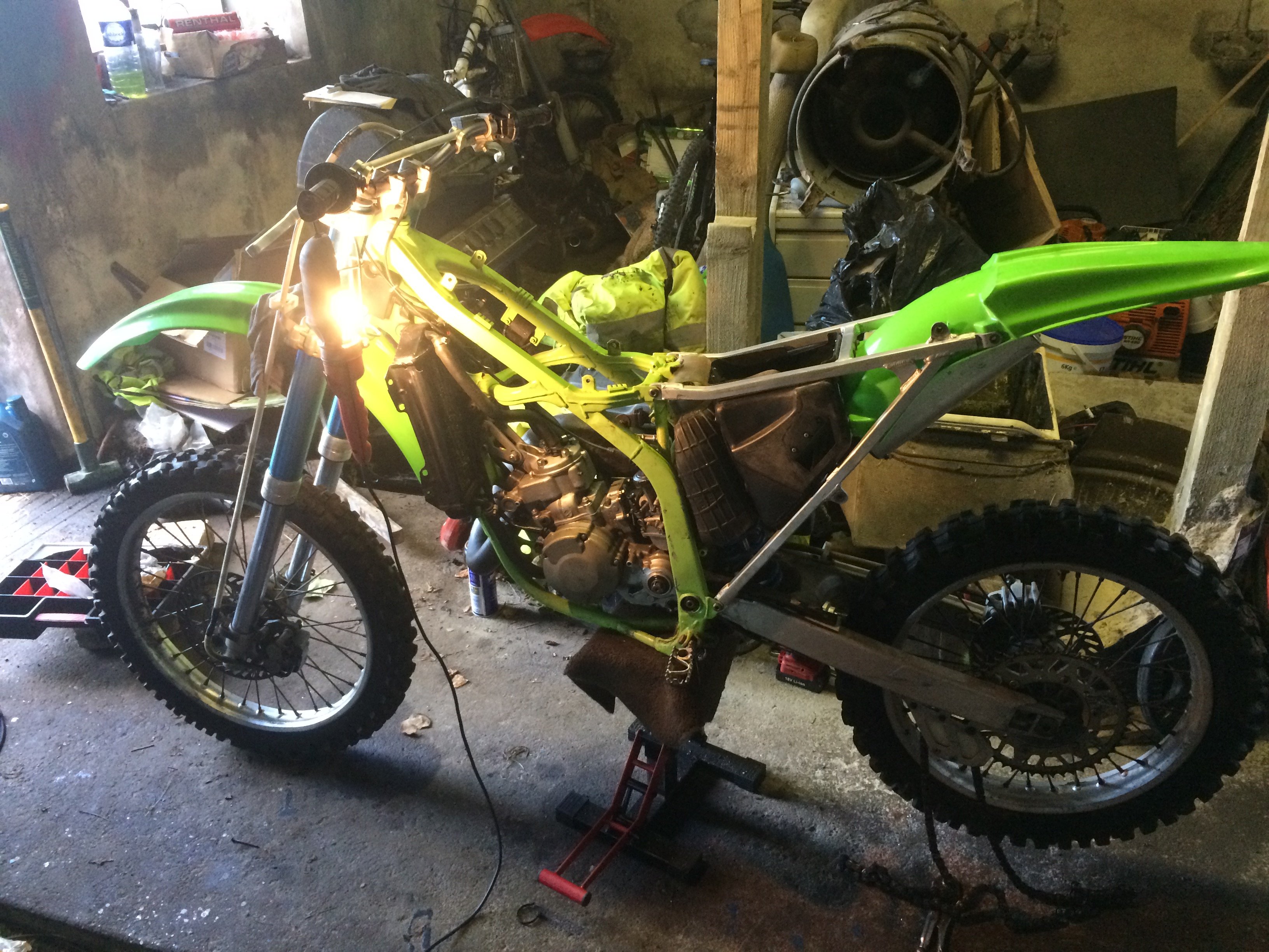

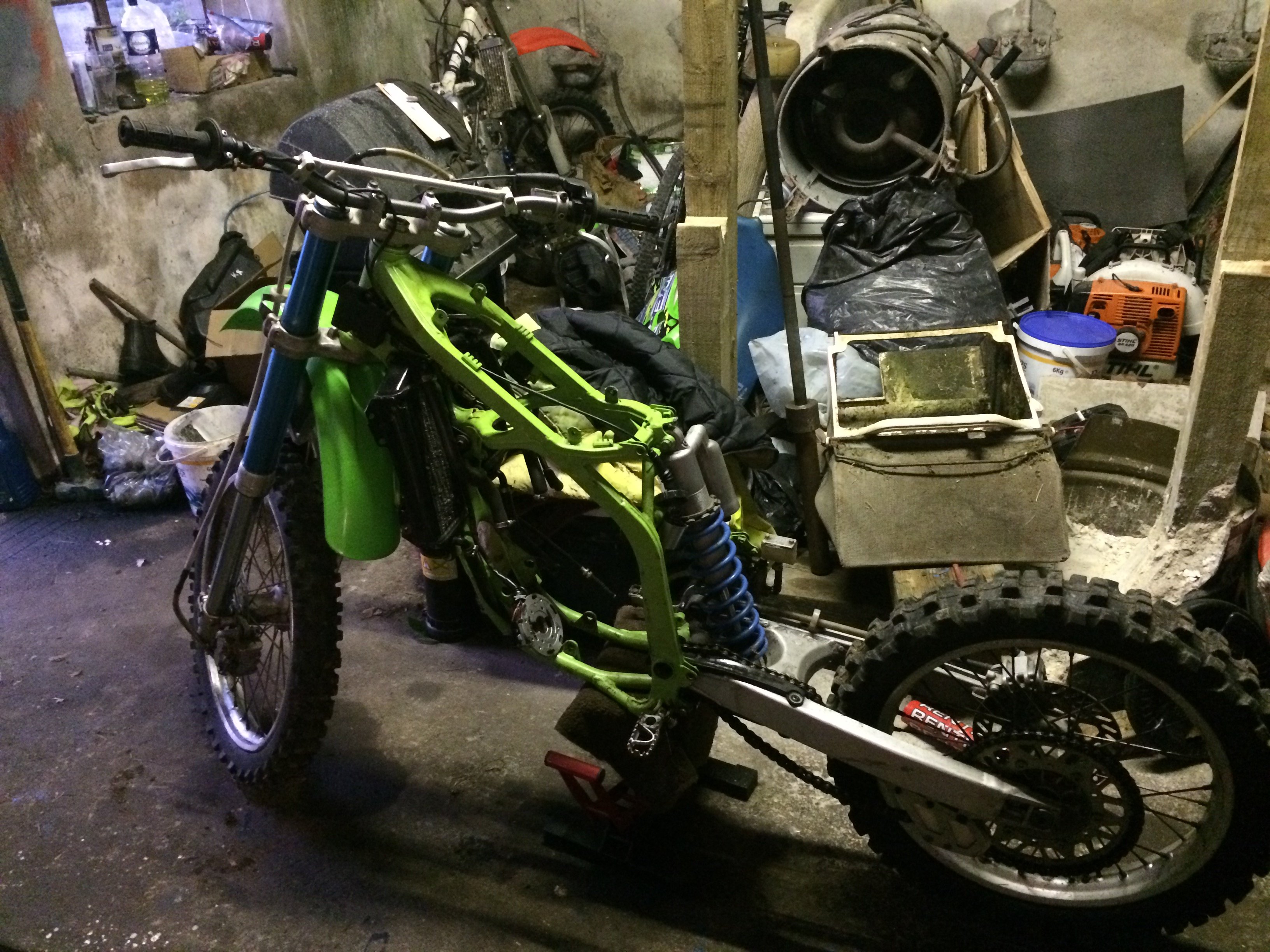

Just an update on the kx 125
Engine is in
Has spark after full rebuild
Need a radiator hose so go to parts store on Monday
Build the rest of her and try start
Kawasaki seems to have aged better than the Honda but the Honda is a simpler machine
May try and get the tx 240 frame and keep up the good momentum
Update on kx 125
Near all built.. have managed to lose the front sprocket
getting close to the first start.. I’m a bit nervous because I’ve a lot tied up in this little 125
After the kx is complete it can come off the stand and the tx240 can begin

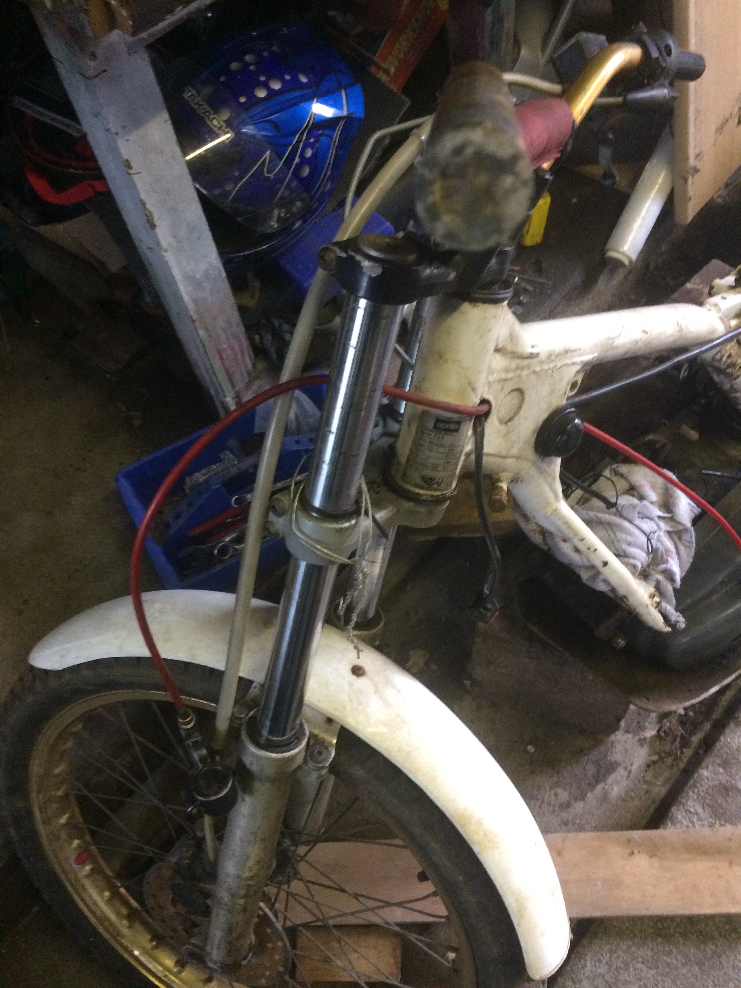

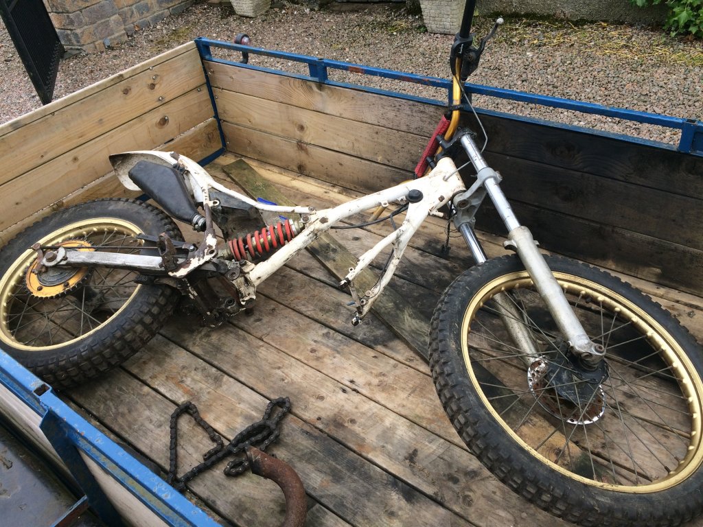

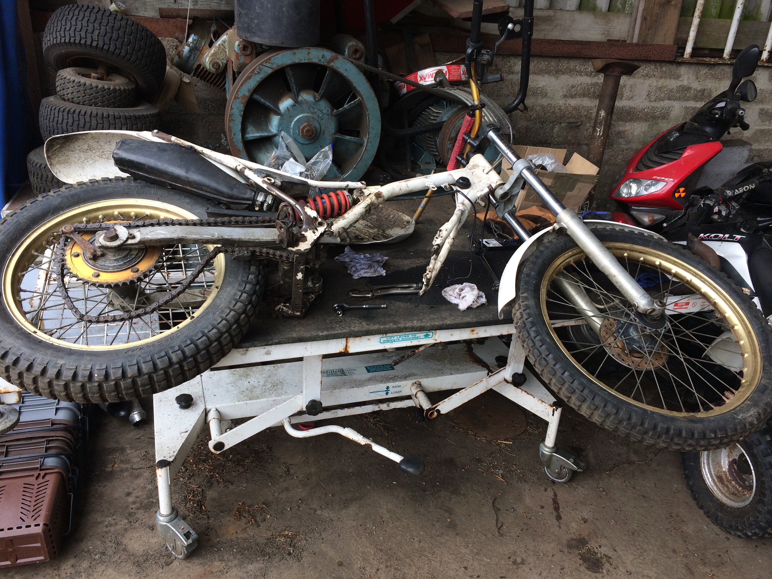

Update on tx240
frame is home
will take a day to remember a bit about the bike.. looks a very simple bike
few bits to tidy up 2 quite awkward jobs to do. One drilling out a engine mount bolt on frame. other is wiring
frame is in my shed ready for building

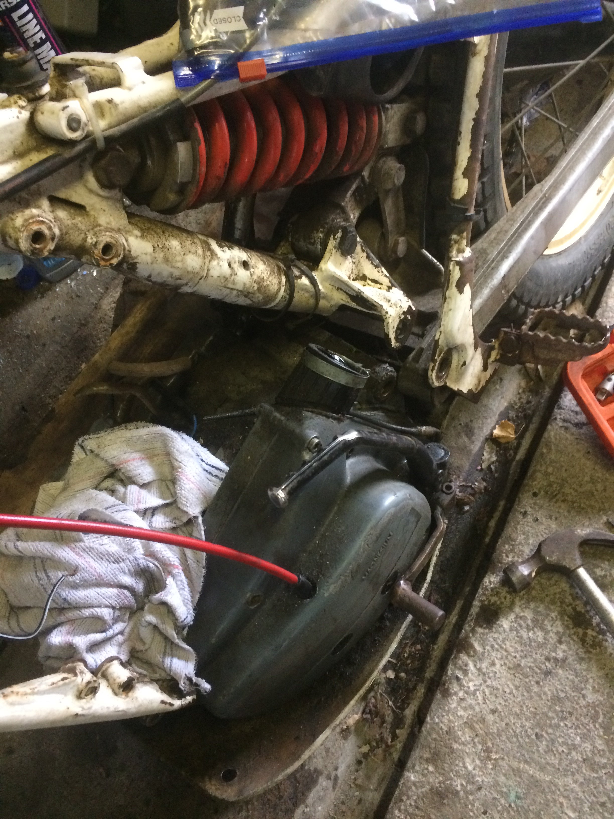

Good evening all
Tonight I spent some mechanic time with my tx
I was able to take off the clutch cover and move the intake boot so that the carb would go on. All that holds it on is a hose clamp. One of the dowels is actually a bolt hole too.
I got the engine mounted apart from the broken stud. It will need an m6 nut welded on, heated up and slackened that way. It took some prying with a prybar to get it lined up. It was either the heat of the fire or just the Italian way. Here I called on my experience of fitting gearboxes to cars along with my experience of bikes.
I think the next step is to get spark and start her up
I feel the broken stud can wait to such times suited to delicate work
I really do feel we are getting very close to the first start
I do notice this is a very large cylinder, I think it's a 311 engine it's definitely the largest displacement bike i own now. If anybody knows what the actual cc is please advise.
I can't praise enough how good of a job has been done with the engine i think the crank has even been rebuilt it is basically a brand new engine.
Will keep you all informed
Regards
Kdtx240
Edited by Kdtx240

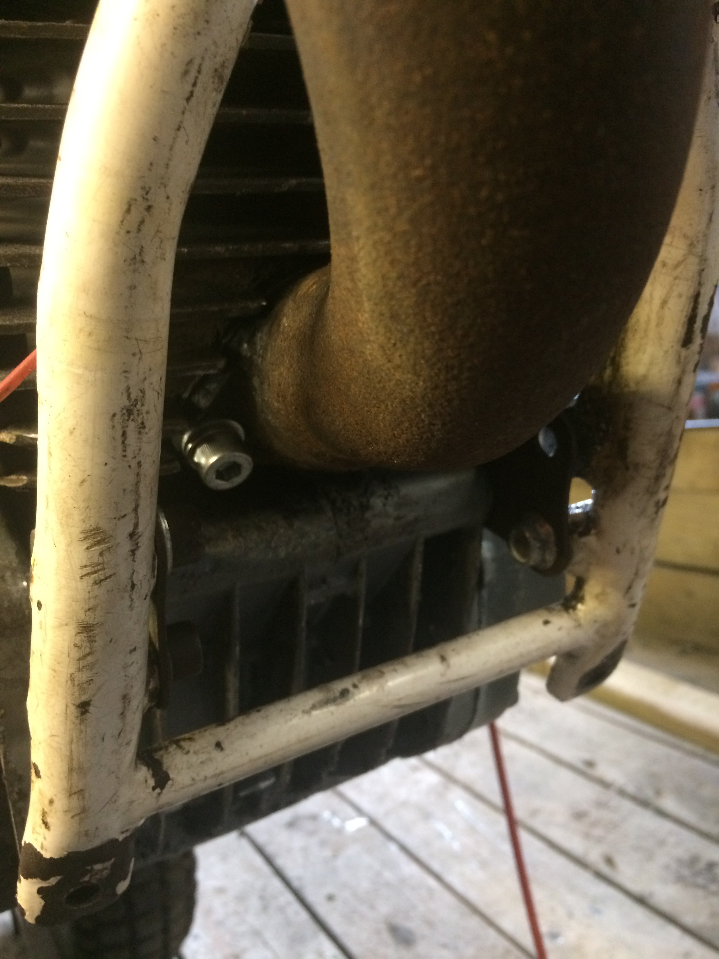

Hey everyone
so the last 2 Saturdays have been spent on the tx 240
got the exhaust on
had to timesert a rung head stud this was not fun at all
made a chain slider
i need an air filter may fit a k&n to the carb and not need any air box
and the decompression valve had to be removed to fit the old tx 240 exhaust to the swm 280 head
