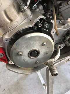

On 7/7/2019 at 8:24 AM, jha said:
Hello, my flywheel on my '17 TXT Pro is below. Could it be aftermarket?
I have a friend with a '17 School 125 and it revs up SO much quicker than my bike and is a lot more fun to ride. I understand the stock flywheel is the same for both bikes.
Can I just unbolt the three bolts and run no plate?!
Do I have to pull the flywheel out to get rid of the plate, or do just the 3 bolts hold it on?
