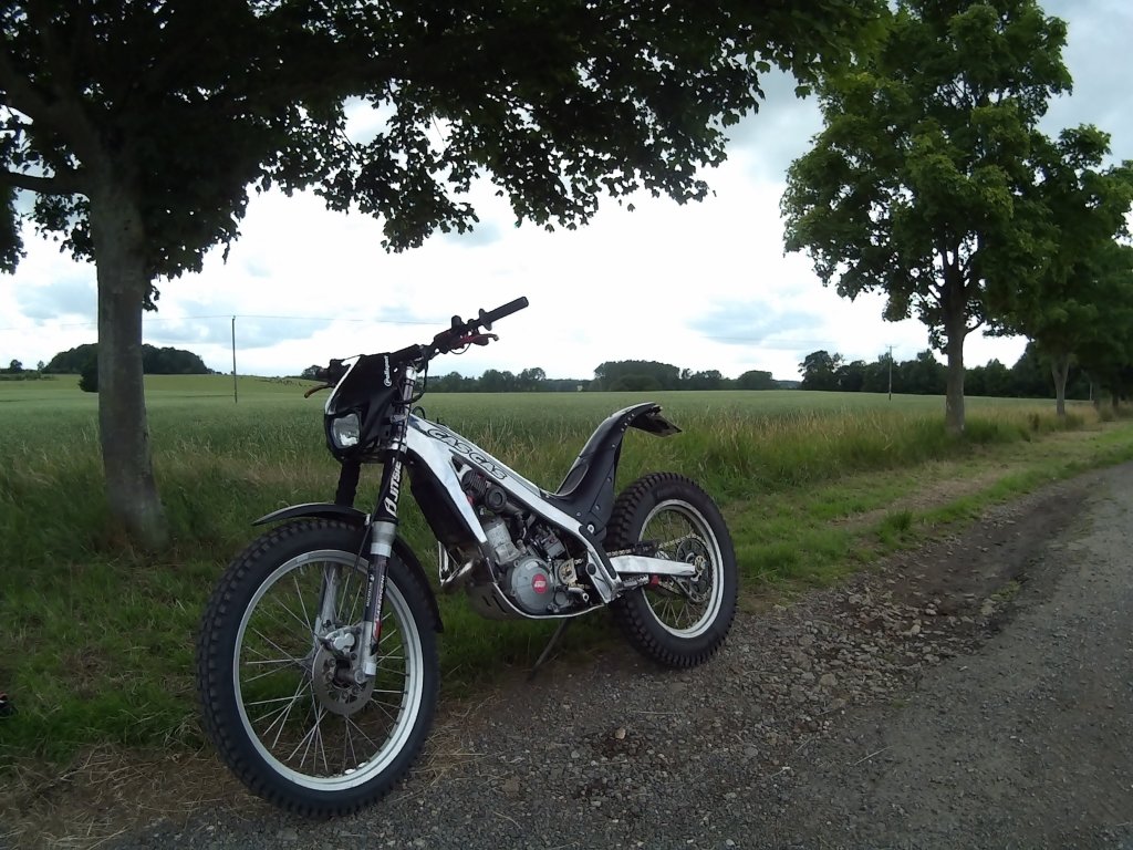

2003 Contact TXT Pro 280 clutch not disengaging properly
turns out what was needed was to put front wheel against a wall, engage rear brake and drop it into gear and just ride the clutch/grind the back tyre till it "unstuck". Then it seems to stay unstuck for a while but if left unridden for a week or so it might need unsticking again. I think it was just the old dodgy oil it had in and needs to work out of all the mating surfaces...so basically it just needs chasing round a field for a few hours and I'm sure it'll be fine.
Fortunately as of tuesday it's now got a full MOT (not just daytime) and I'm out exploring on her so the clutch is gonna get bedded in pretty soon ;)

with more regular use, as I'd hoped the clutch seems to be getting less sticky. I still start it against the wall for the first time but it's less of an issue every time I go out. I think she just needed some <3. gearbox-wise, it seems like it's loosening up a bit. I wonder if whatever wrong oil was used gunked up other mechanisms, e.g. why it's so hard to find neutral when it's running.
She's now got a full mot (not just daytime) and I'm out exploring regularly and trying to get to know the bike. I'm going to try and add another silencer because I'd be able to explore and practice in more places without annoying people if she wasn't quite so rowdy, and there's plenty of power so if it restricts it a bit then I can live with that. Just fitted the other back wheel I had with a heidenau K60 dualsport tyre and a 40 tooth sprocket (13t front) which I just tested in the wet and much to my surprise it felt really good, but also wild.
Love this bike tho whatever it is, it's exactly what I wanted. Thanks for your help everyone :)

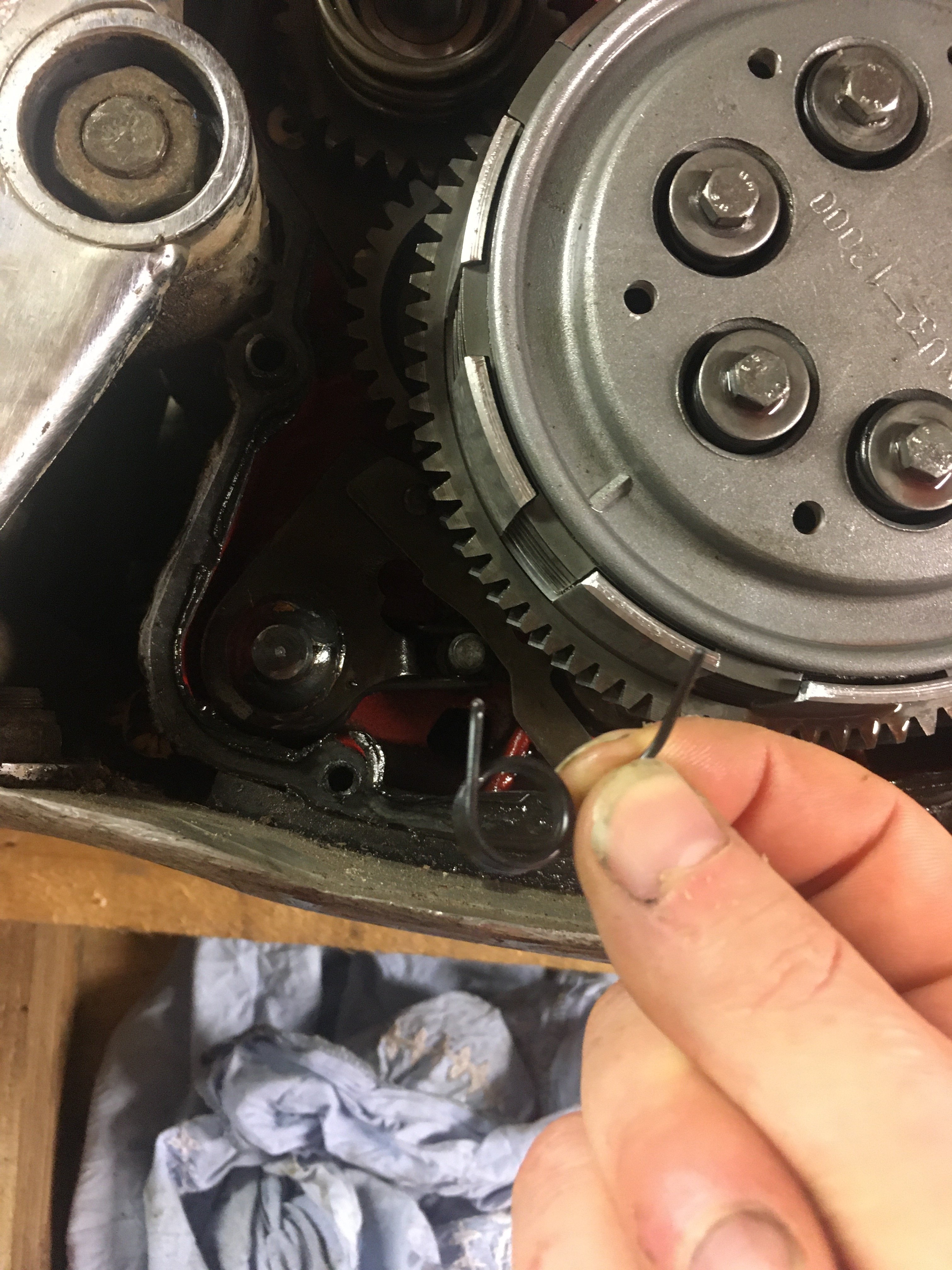

i'm not sure is mine similar.. but again i couldn't find my symptoms like you in any other thread. i have a gg jtx270 contact 1997, clutch felt a little draggy last time out as in i had to pull lever all the way in to disengage, but i bled up and seemed better, i changed out the oil in box which was atf replaced with dexron 3 as someone advised?,  but we were going well on spin through woods until drag started coming into bike and conking out on slowing down and stopping- but clutch still felt good on the lever- eventually i couldn't change gear- even with engine off bike rocking the gear selector seems free - no feel like its just moving up and down but not clicking or feeling like its going to elect anything!
i suspect discs are swollen and stuck on but i thought i should still be able to change gears with engine off? just want a bit of direction before i tear into it! could still be hydraulic!
You should be able to change gear with the engine off regardless of anything that's going on with the clutch, but you will need to roll the bike back and forward a little to align the dogs, expect it be be clunky/fiddly. Try that first, I suspect it'll be fine but confirming this allows you to focus on the clutch.
Hydraulics are likely to be ok if the fluid level isn't dropping and if you don't get bubbles when bleeding.
Changing type of oil can swell plates, they can absorb components of the new oil before they have shed components of the old.
Plates/steels can warp. Can you find plate and stack thickness specs and pressure plate travel for the bike? Everything can look fine but stop working when out of spec.
ya i have zero gear change even off and rocking bike,? thats why i was dubious about clutch locking up causing it, peddle travels perfectly and returns perfectly to centre every time but no feel of selector picking up change,
ill replace all discs in clutch anyway but i would imagine i have some sort of selector issue? cases split time?
i have bled system again and flushed 100ml of new fluid through lines all ok and lever adjusted correctly, .

Not being able to select gears with the engine off does sound like a selector issue,  but don't dive in too far you can check some of the selector mechanism after just removing side covers.
It wouldn't cause clutch drag though so you've either got two problems or it's misdiagnosed, might be worth having someone take a look at it.

Bit the bullet opened the cover! Found spring broken thankfully!! Pics attached. Also discs are a little swollen compared to the specs which would explain the drag! So new clutch and I’ll try find this spring part number! No opening of the transmission thankfully!
