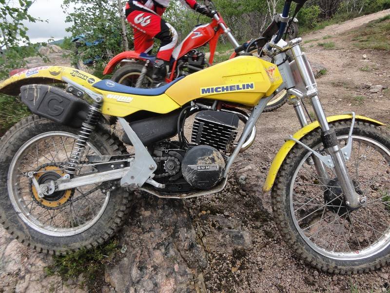

Was at a trial yesterday and a very kind person gave me a tip. He said that if I turned the front brake arm so that it was pointing forwards that it would work better. He then tried to explain that if the top shoe grips before the bottom shoe the brake works better:wacko:.
All I want to know is he talking p***

  • Think he's talking p****. The hub doesn't know which shoe is touching it, and if your complete assembly is working correctly, both shoes should touch at the same time
If both shoes have the same contact area what shoe it makes no difference what shoe is the lead shoe because they are not directional :wall:
13 hours ago, b40rt said:
If turning the arm around generates more force onto the leading shoe, the brake will be more powerful ??
Turning the arm forward generates LESS! force, because theres less leverage on the leading shoe... You're talking about 5% here btw, but it is less
The argument is that a forward arm makes the leading shoe touch first because a forward arms makes the leading shoe move further (hence the less force), which is the case on a new set of shoes, but on a brake that has been bedded in, both shoes will touch at the same time, meaning its impossible to make the leading shoe touch first

Talking ****? I know what the effect is! Looks like you didn't before you had to go to google. Thats the whole idea for twin leading shoes, for which im not arguing!!! Did you read my post? The OP wanted to know the effect the direction of the brake cam has on the leading shoe, and i was explaining the difference! The leading shoe will always be the leading shoe, but changing the direction the cam rotates on the leading shoe effects the force that it applies to the hub. Im starting to think this is all over your head.

Brake shoes do have a leading and trailing edge. Conventional front single action brake plates have one brake fulcrum (the lever that the cable attaches to) and a fixed pivot for the other end of the shoe. By convention in all of this type of design, as the fulcrum is turned by the rider pulling the brake lever the brake shoe moves out towards the drum surface. The other end of the shoe only pivots about the fixed pivot post/shaft and so only gets to touch the drum surface when the shoe has significantly worn. This same science applies to all single fulcrum operated brakes, that is why we have twin leading shoe front brakes on race bikes and Honda used a twin leading shoe effort on some their m/x and enduro machines and ditto Yamaha. Check out Google for explanatory diagrams etc before loosing off ‘ah buts’. ?‍???
The guy has an SWM, his anchor arm is fixed. You're also arguing something completely different, the benefits of twin leading shoes

I have bikes with backward facing brake arm, forward facing arm, and fantic 300 brake plate. Hard to do a scientific test as they are all used and have different brake linings and brake cables. But in my examples the best is the fantic, followed with forward facing and last rear facing.
