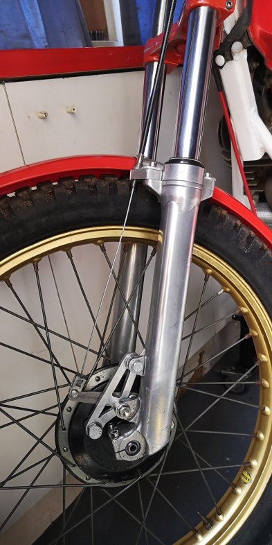

I spent hours trying to work out the forces etc.... Came to the conclusion that the leverage from the cam would be slightly weaker by moving the arm to the front. But I did it anyway on my Armstrong, mainly for the cable run. I was wearing a hole in the bottom yoke. On braking forks compress and you can feel the effect on the lever as the cable is bent.
Fitted some new forks as my old stanchions were knackered, so I needed to make some bits anyway. I made a custom mudguard risers with a cable pull anchor (drilled and hollowed for weight saving). Custom fork brace which is flatter and helps reduce twisting. Also made a nice strong torque arm. I tried to keep all the angles optimum for best efficiency, which meant a new brake arm with slot at a different angle. Less outer cable = less flex and no deflection on fork travel. I used 2mm Cable, but I also have a 2.5mm to make up to try.
Tested it Saturday. Overall result = Awesome :) Works better that I'd hoped, lever feels so solid, not too vulnerable for damage and I think it looks good too. What do you think?
Sorry to muddy the SWM forum with pics of an Armstrong!
Very nicely done, brake operating lever looks to be well protected ?
