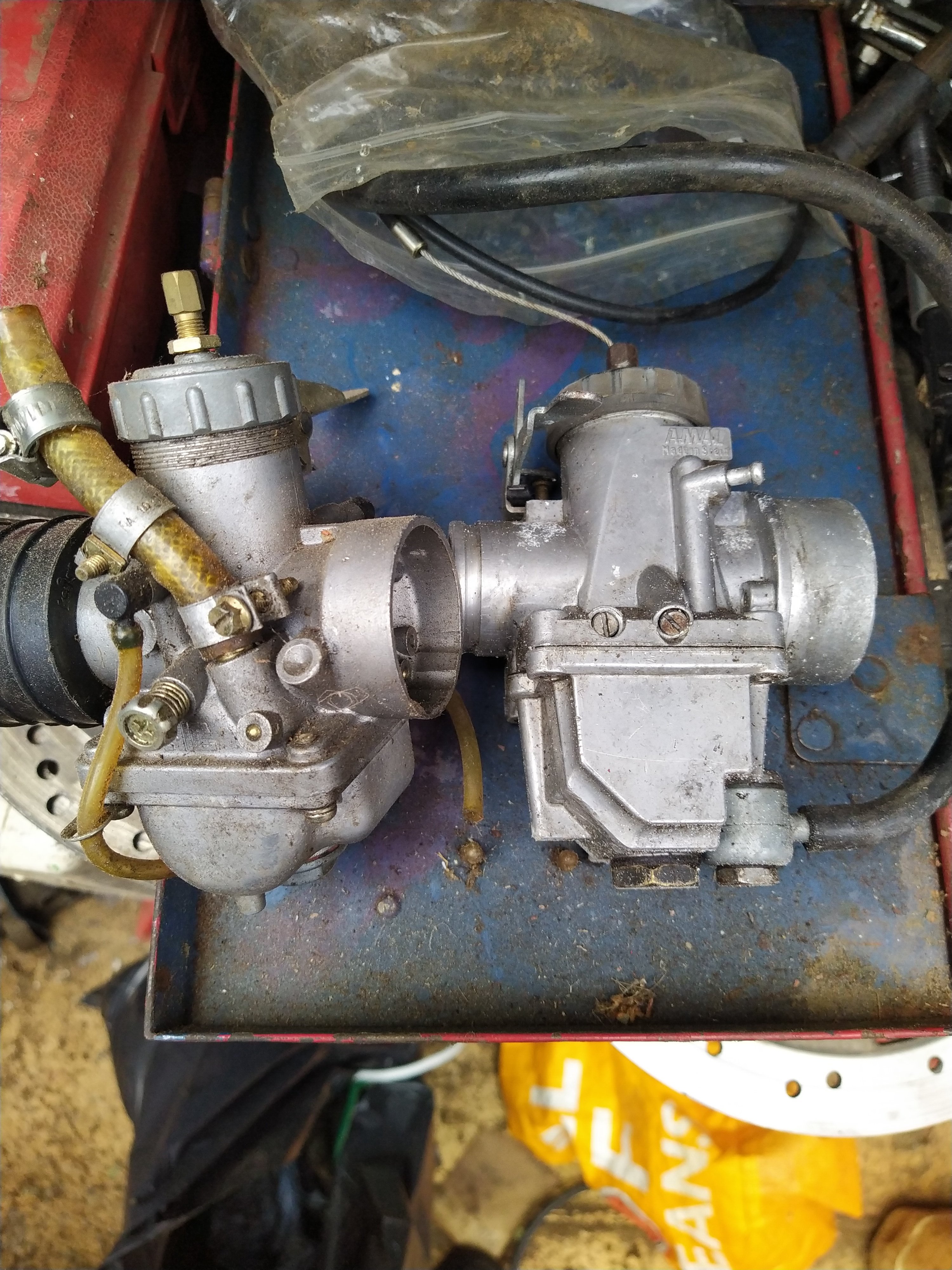

I'll have a look this afternoon and get back to you with the jet sizes, I bought mine second hand off a fella who had it on a 349
and its the best money I've spent on the bike.. Would recommend Mid Atlantic trials if I was after a new one.
Useful to check where the petrol feed is. I fitted a mikini, the pipe was on the wrong side. And too high up .There's not a lot of space I had troubles getting the petrol into the bowl
