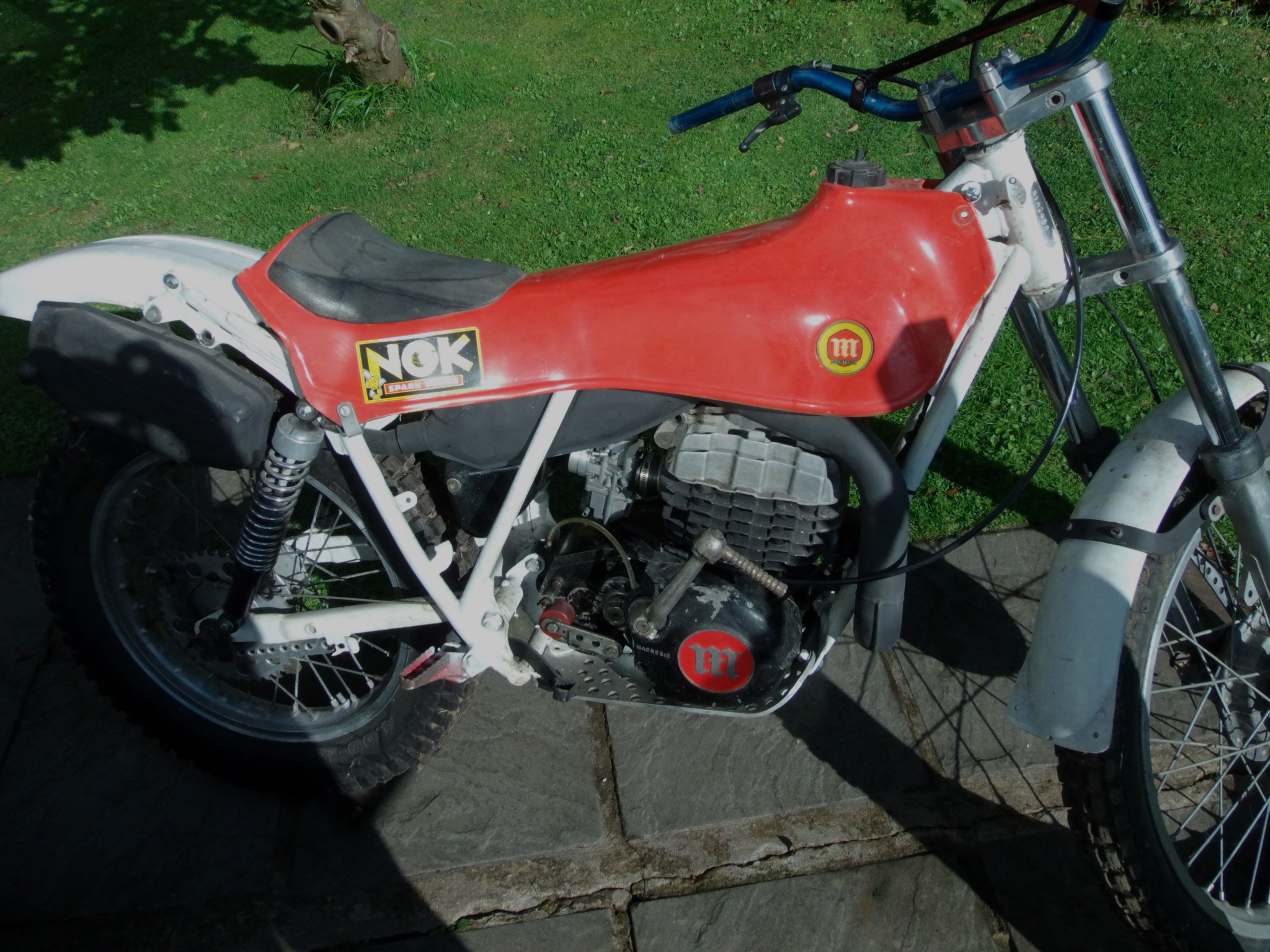

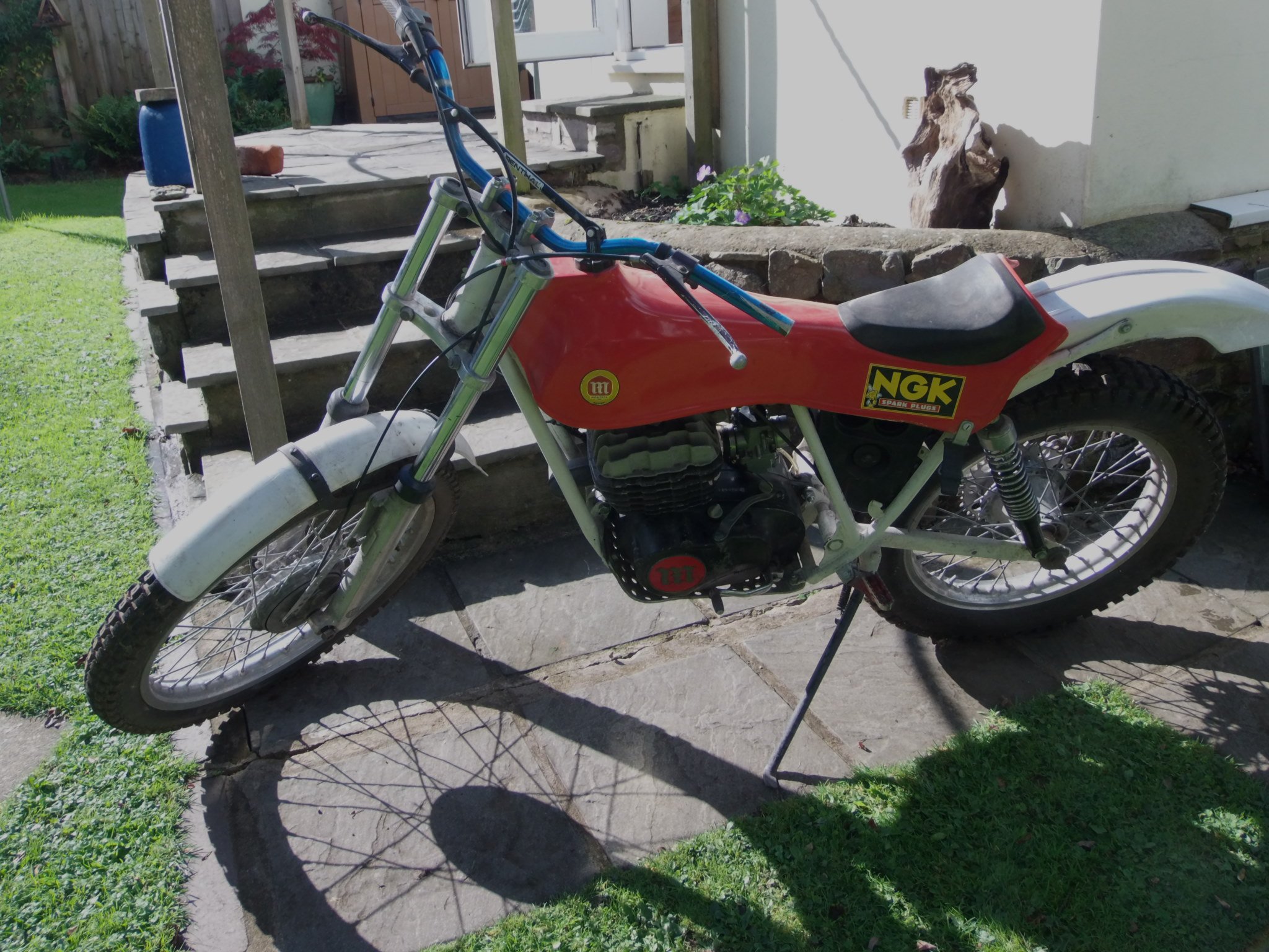

October 1, 20206 yr Hi Have just bought a montesa cota 348/349 ?? can anyone out there help identify what ive got before I go looking for parts, chassis and engine numbers match 51M24661, the frame appears to split and has a sump guard at the bottom and has been painted white (badly) should this be black not seen a white one??. Hopefully I have managed to load a couple of pics. All replys gratefully recieved. Cheers Seadogtypebadger
October 1, 20206 yr Looks to me like you've got a 349/4 or series 4 the last of the 349's. The frame should be grey, the only thing that dosent look original is the swinging arm that should have a kink in it. I hope that helps
October 1, 20206 yr Defo a 349, as said it should have a grey frame and matching grey mudguards, front and rear. the tank/seat unit should sit flush to the rear guard, is it the correct air box or is that not holding it up, it's just the image and not held down tightly? Edited October 1, 20206 yr by jonboy883
October 1, 20206 yr Author 8 minutes ago, jonboy883 said: Defo a 349, as said it should have a grey frame and matching grey mudguards, front and rear. the tank/seat unit should sit flush to the rear guard, is it the correct air box or is that not holding it up, it's just the image and not held down tightly? Hi Thanks , tank just rested on for photo
October 1, 20206 yr Author 51 minutes ago, barnesy said: Looks to me like you've got a 349/4 or series 4 the last of the 349's. The frame should be grey, the only thing that dosent look original is the swinging arm that should have a kink in it. I hope that helps Thanks that helps

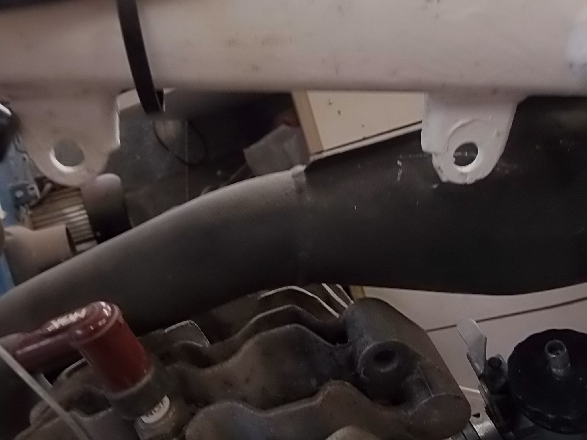

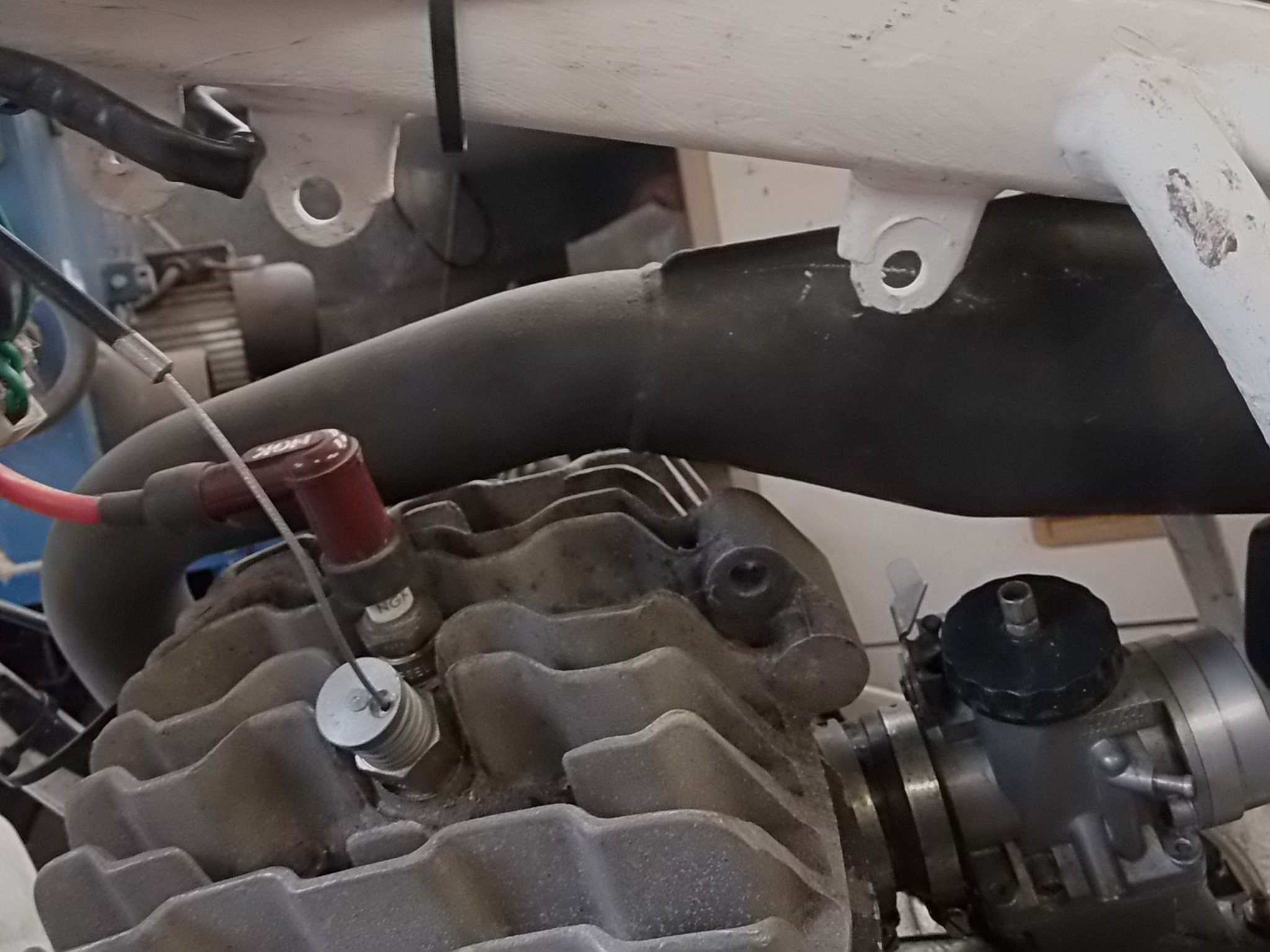

October 1, 20206 yr Author Hi again Two more pic, help , pretty sure there should be some kind of mounting plate between the two holes on the top of the frame and top of engine??? Also any idea of the year . Thanks guys
October 1, 20206 yr That's right there should be a triangular alloy bracket that connect's frame to head. I would think its an 83/84 .
October 2, 20206 yr You may not be able to get a bracket, cardboard template and a friendly engineering firm to cut a nice alloy one!
