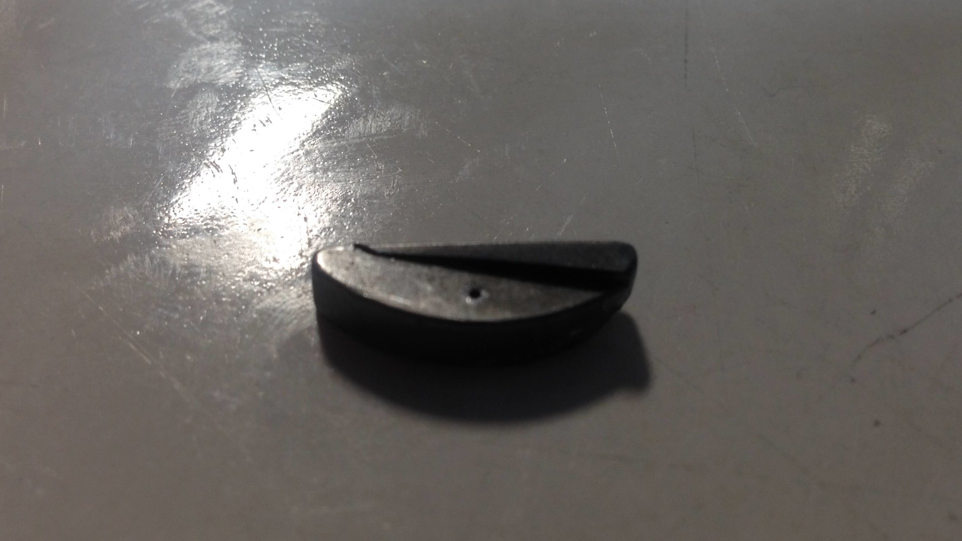

I would guess that most of your internals will be ok, the only damage usually occurs from water. My 18 was drowned in the 2019 scott about 2 mins from the start. The bike knocked its tits off for the rest of the day. Upon stripping it down, the woodruff key had folded itself in half and stretched both ends of the con rod resulting in a knock that was noticeable throughout the rev range.
