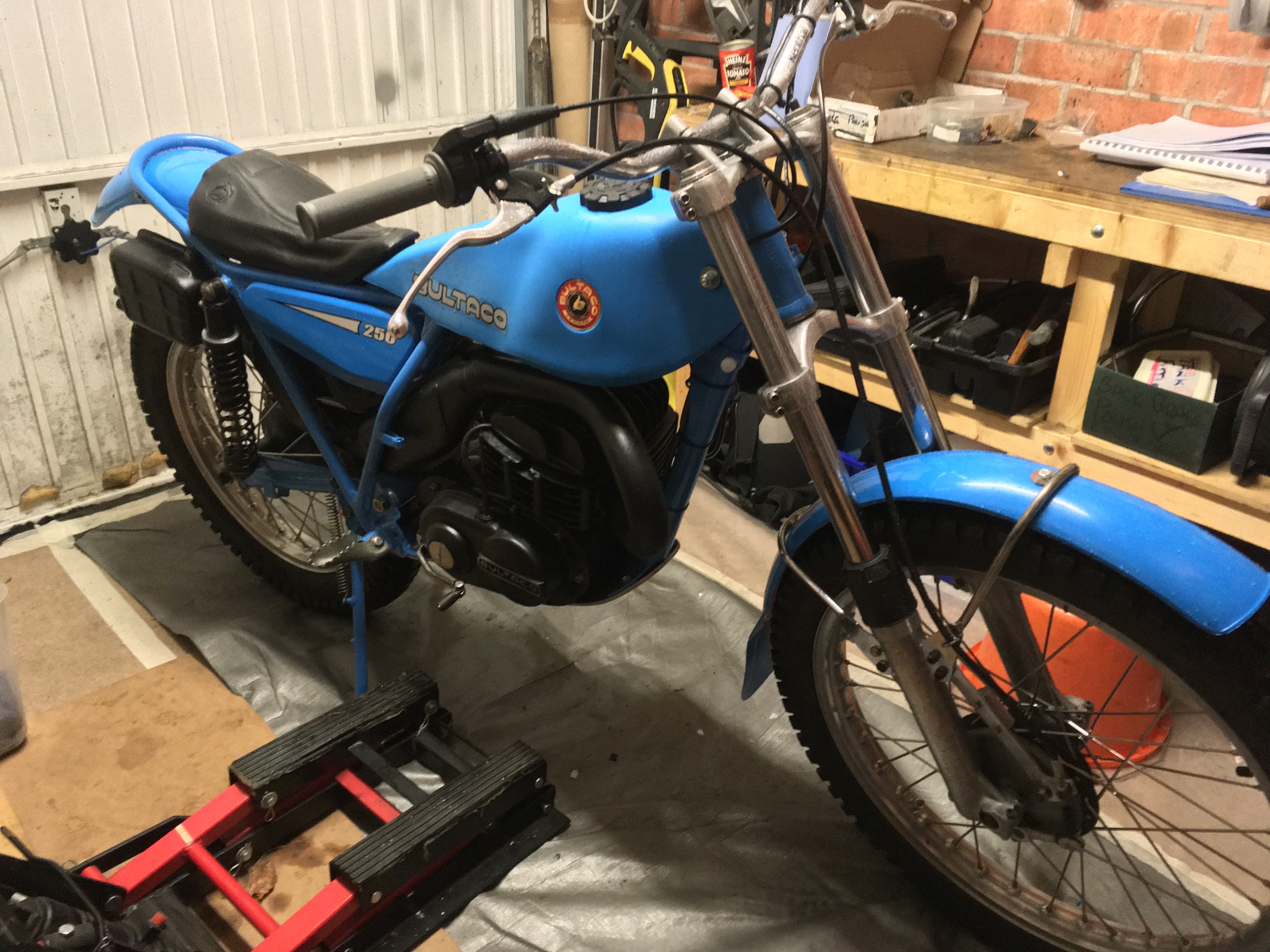

Well the Sherpa is finally back together and after a short run up the road in a hailstorm all seems to be working OK. However, my initial difficulty in kickstarting the bike before I stripped her down remains. Surely it can’t be right that the kickstart (which is already high for my short legs) hits the frame (so much for new powder coating!) then the brake pedal and obviously the footpeg is also in the way and catches your heal even if you hitch it up?
Is there a solution I.e. an alternative base pivoting or cranked lever that has some additional clearance? I’m used to kickstarting my T140V Bonneville but that doesn’t hit anything on the way down! Help please!30D139E7-F0C4-472A-9833-DB106215396B.thumb.jpeg.f6ffbbf64e373e910afc9fa9baadd5c0.jpeg
The kickstart lever it not meant to go past the footpeg or brake pedal tip.
Maybe post up a photo showing the kickstart side of the bike.
 It's not uncommon. On A and B models the kickstart is closer to the frame as the shaft is shorter. If either the kickstart itself or the shaft have the slightest of bends in them it will catch the frame or brake pedal. I have three B Sherpas and it catches on each of them
If everything is working correctly the bikes start so easily that your heel hitting the footrest shouldn't matter, the kickstart doesn't need to rotate further than the footrest. Use the clutch to get the kickstart into a comfortable position and then fiddle with it to get the piston to TDC. Then let the kickstart up as high as is comfortable and give it a sharp push rather than kicking and thrashing at it. If everything with the engine is as it should be it should fire up with one kick. It's thrashing and kicking at it that can bend things inwards towards the frame
There is no alternative lever that bends away from the frame
Woody is right the kickstart will nick the frame on the 199A & B models, the kickstart shaft is shorter by about 10mm to accommodate the narrower late model ignition cover, but they didn't narrow the frame so hence the problem
I know of someone who fitted a shortened OSSA MAR kickstart lever to their 198A and I had wondered why but this is probably why (it has the swivel joint at the bottom end, providing more clearance)
Ah thanks that explains it. It’s early days so I no doubt will develop the right technique, but due to the height of the lever and the fact that it’s at about 12 o’clock when engaged, struggle getting my leg high enough (I’m 5’8”) so inevitably take it down past the frame etc. It’s a problem in my garage so will only be more difficult on a trial etc. (Not done one yet!).
