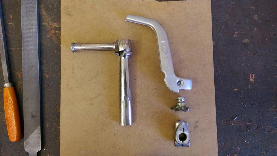

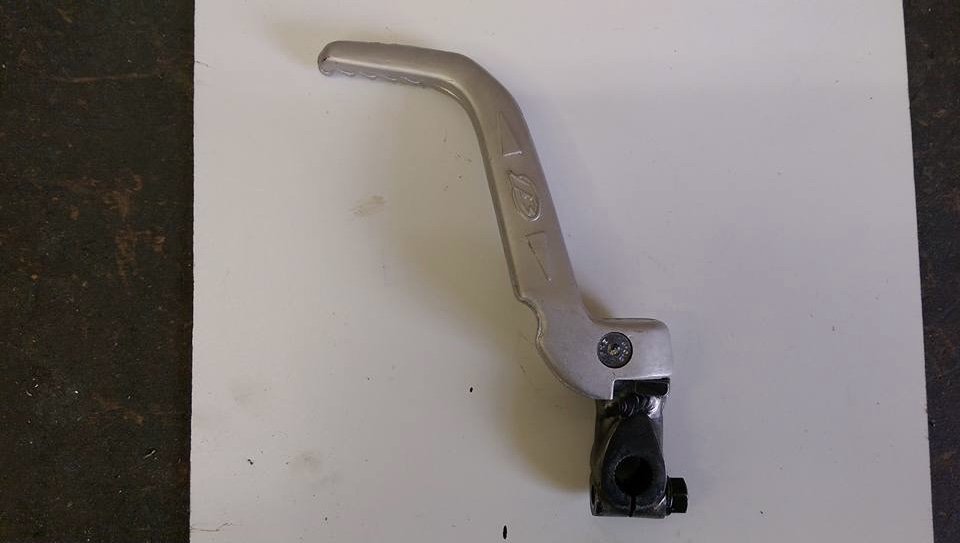

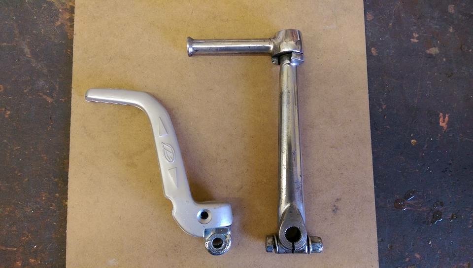

This kickstart mod looks well made. Think it was posted on the forum a few years ago
That's the mod I was referring to with the Beta kickstart that I did for mine although that's not mine in the picture.  I took mine off after trying it for a while as I got fed up of having to reach down to flick it out by hand to use it. The Bultaco lever can just be flicked out with your heel, I couldn't get my heel behind the Beta one
