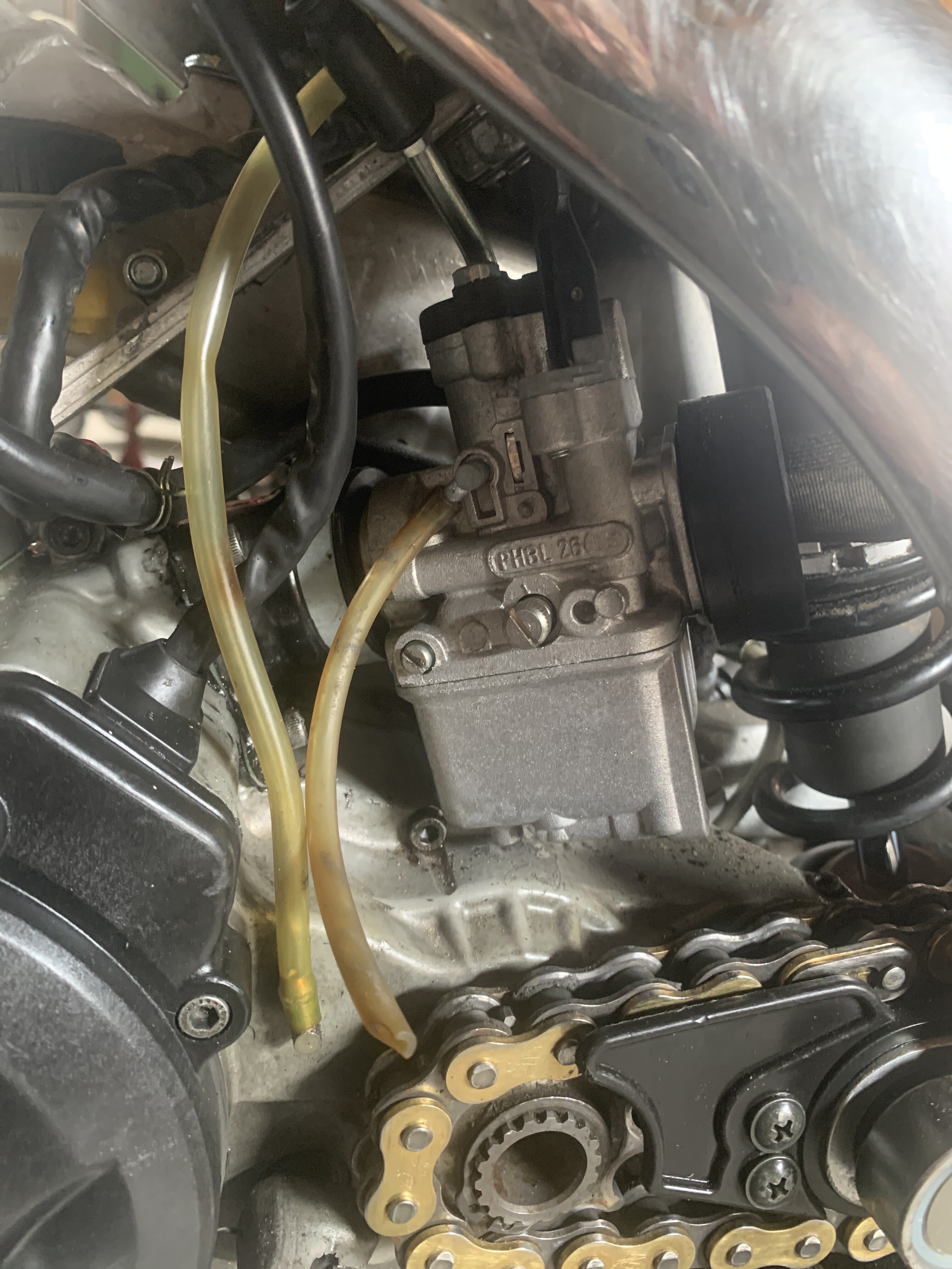

 Take a picture of the bike, with focus around the carb. And post it here. Have you tried removing the gas cap when it does not start?
Thanks for resoponding.
I think he's getting plenty of gas. the spark plug is even wet.

2 thoughts         1)   with the fuel turned on and the bike laying flat on the ground ( either side )     does fuel pour out onto the ground ?
                          2)   have you taken the flywheel off the check the woodruff key ?
Thanks Reggie,
1) I will see this tonight.
2) The woodruff key is in place.
Strange is that the engine sometimes (mostly not) starts after 1 kick. When this happends the second time i need al least 10/ 15 kicks.
Alex
I assume you are running with an airbox fitted, is that just the adaptor fitted to the rear of the carb ?
If it starts and runs when cold then the ignition must all be in place I would suspect a blockage in the carb.
 The times it refuses to start, you have to verify if you are getting spark or not. If it is flooding it`s a carb/intake or even a main seal issue. But the flooding could be from kicking it 20 times with no spark. A quick cheap other trick would be pull off the spark plug cap and cut the wire back a little to fresh wire and screw the cap back on. And double check the pins connecting the CDI, they have been known to push in or out of place.  Being 17 years old now, anything is possible.

1) I'll see fuel leeking when i put the bike on the richt site. Left is not leaking, richt is leeking.
2) Woodruff key is oké, in place.
Why do you ask about the leaking?

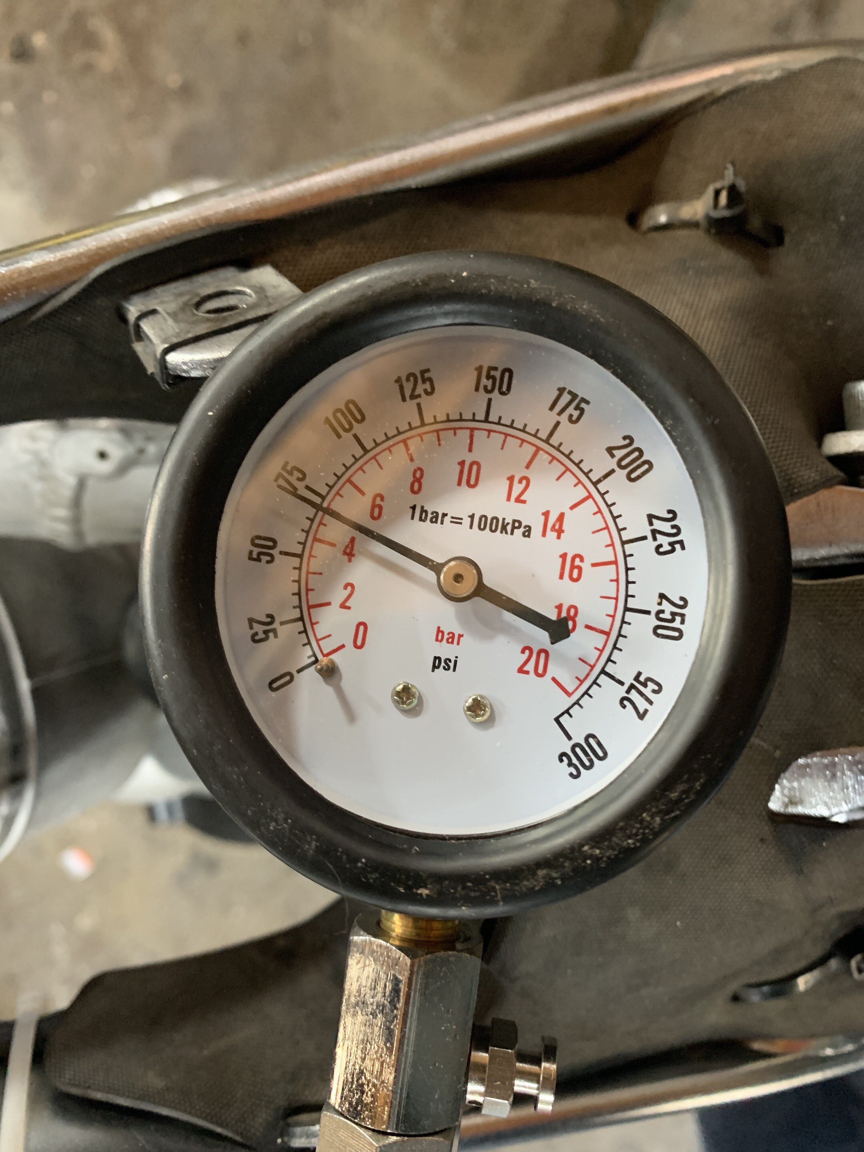

Thats a good start. HAve you done a compression test?
I did this morning, stable just below 75 psi after a few kicks. measured several times with the same result
 Thats not enough to run if accurate. Whats the history on the bike? Did it run when you b ought it? Did it all of a sudden start having this issue. Could just be stuck rings. You probably should plan on taking it apart. But you would just pull thd header pipe off and take a look at the exhaust side if the piston. Post a pic if your not sure what you find. Good luck.
