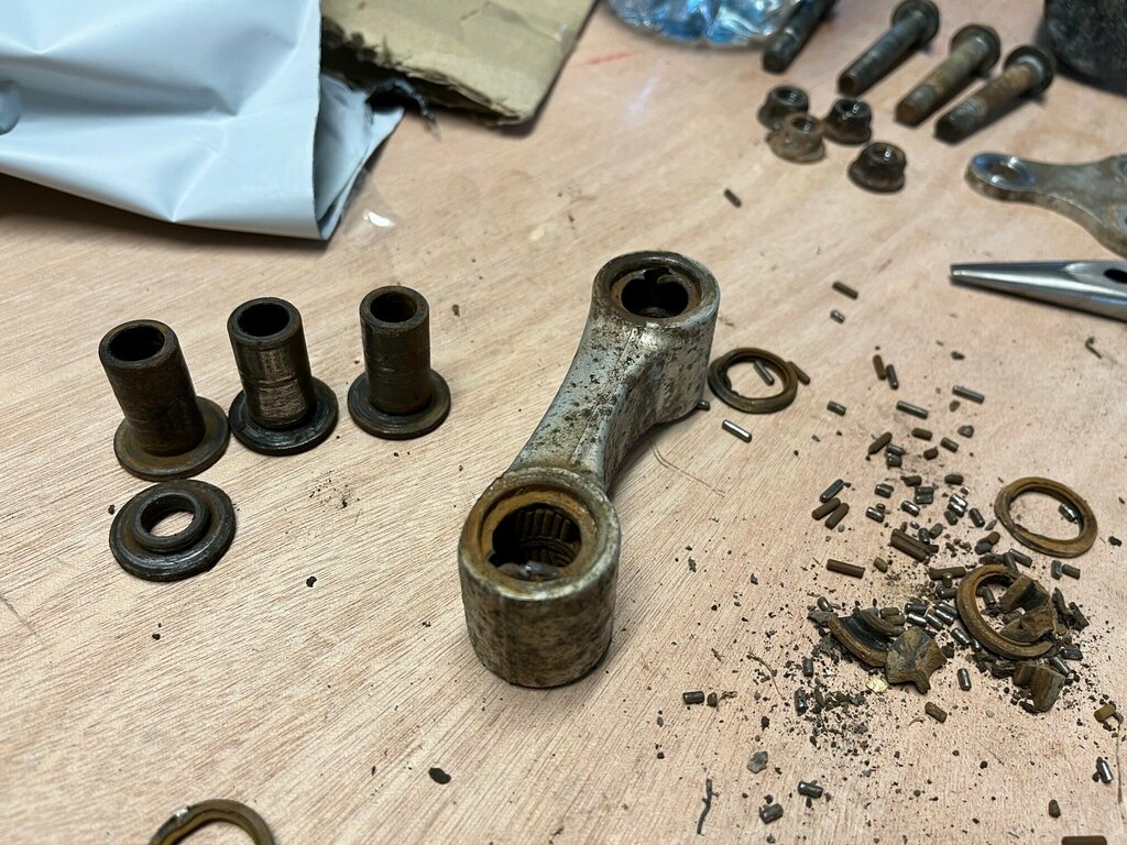

On 3/6/2022 at 2:06 AM, Cube said:
I will NOT look into the swing arm at this stage.
The swing arm bearings seldom need attention but the ones you really DO need to check (and the ones I was referring to) are the ones that attach the arm to the dogbone linkage. If neglected will cause damage to the arm. Plenty of info/pics on line showing what can happen......................
AH. got ya. Please see the picture attached. Is this what you mean? ;)
I took out the rear shock because it was "spring only" and send it off for revision. 530NZ$.😱 I need a new shaft.🄵 And then I thought.....while this is open....let's check the linkage kit and may give it some grease. Well....I am currently trying to source a linkage kit.
The swingarm itself has no play and everything is fine. But again hard to source a kit here in New Zealand. Overseas are plenty. So I guess I will leave it for now and open it another time. Actually scared to open it and then not be able to put it together again because it might fall apart as the linkage did. 😁
