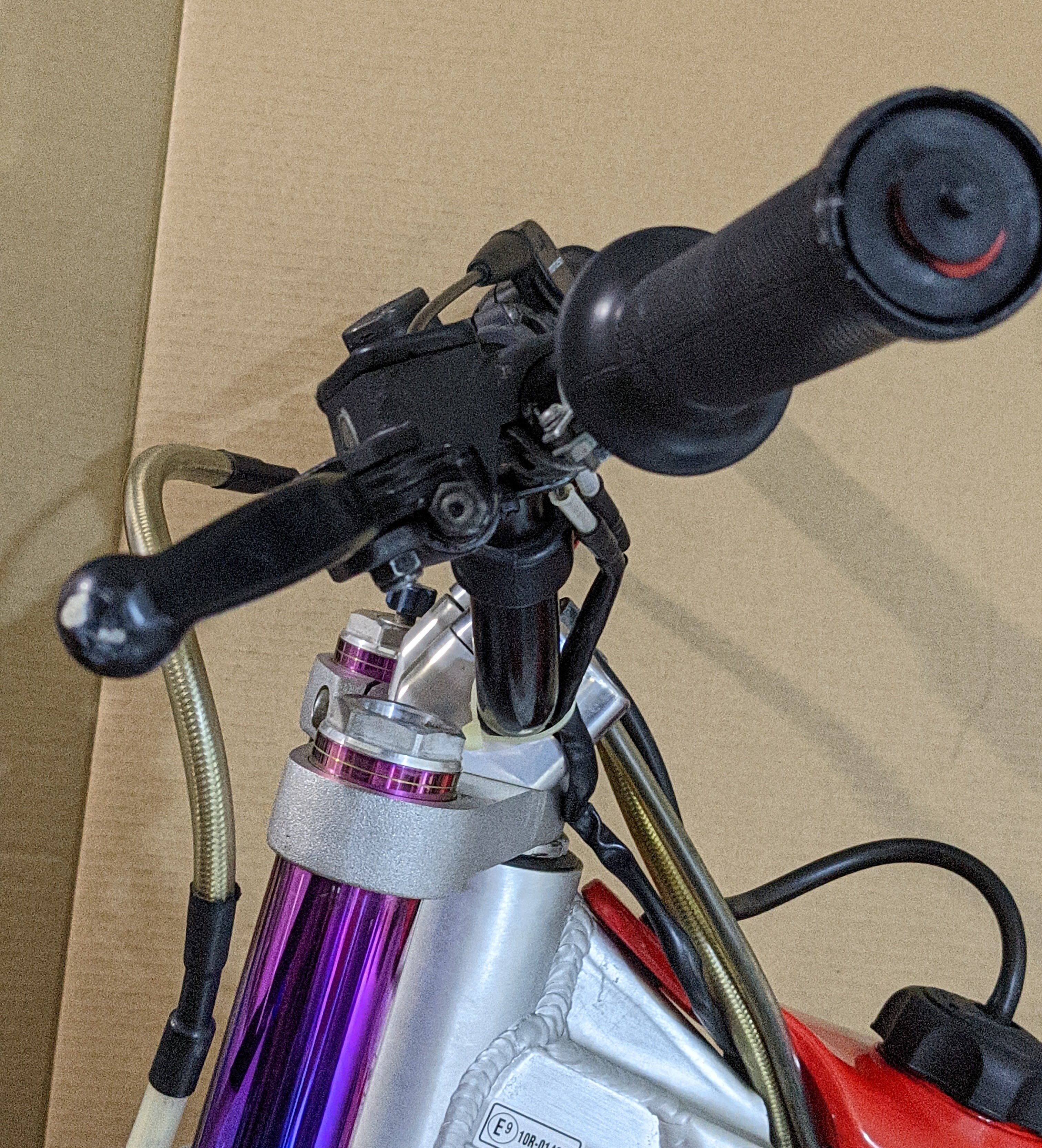

Bought recently a Cota 315R and I am having a hard time finding a comfortable position for the levers, the clutch in particular.
Holding the clutch with my index finger ends up pinching my fingers or hitting my knuckles. From various pictures and videos, I see setups that are dramatically different, WRT inclination and horizontal position on the handlebars.

To recap, clutch lever needs to fully disengage before hitting the knuckles (makes sense, will do this during the WE) and almost horizontal (right now it's pointing down a lot, even after adjusting from the previous owner).

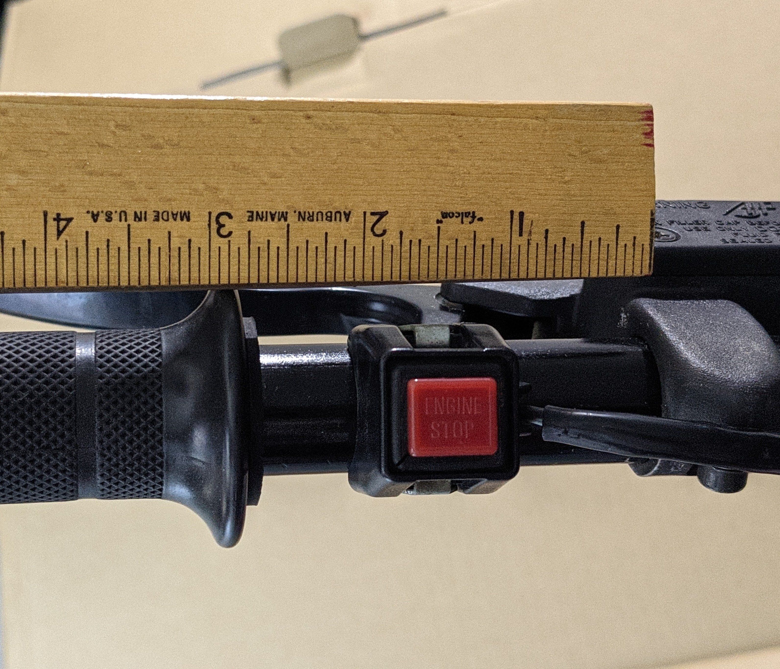

What about the distance from the grips? I measure roughly 3 inches (~8 cm) now, that is way less than the previous owner (!?!?!)

IMO your lever angle looks ok. Thats what i ride with, but most others would be between that and horizontal. Your lever needs to be closer to the end of your bars. Youre aiming for your index finger to position in the most inward bend part of the lever, ie about the 2 5/8 inch mark on your ruler.
