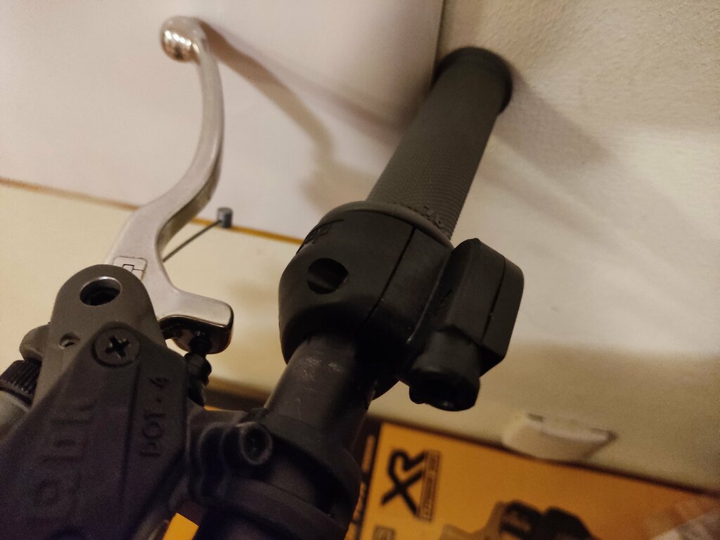

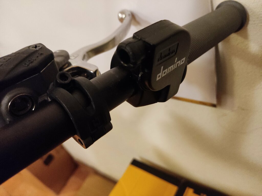

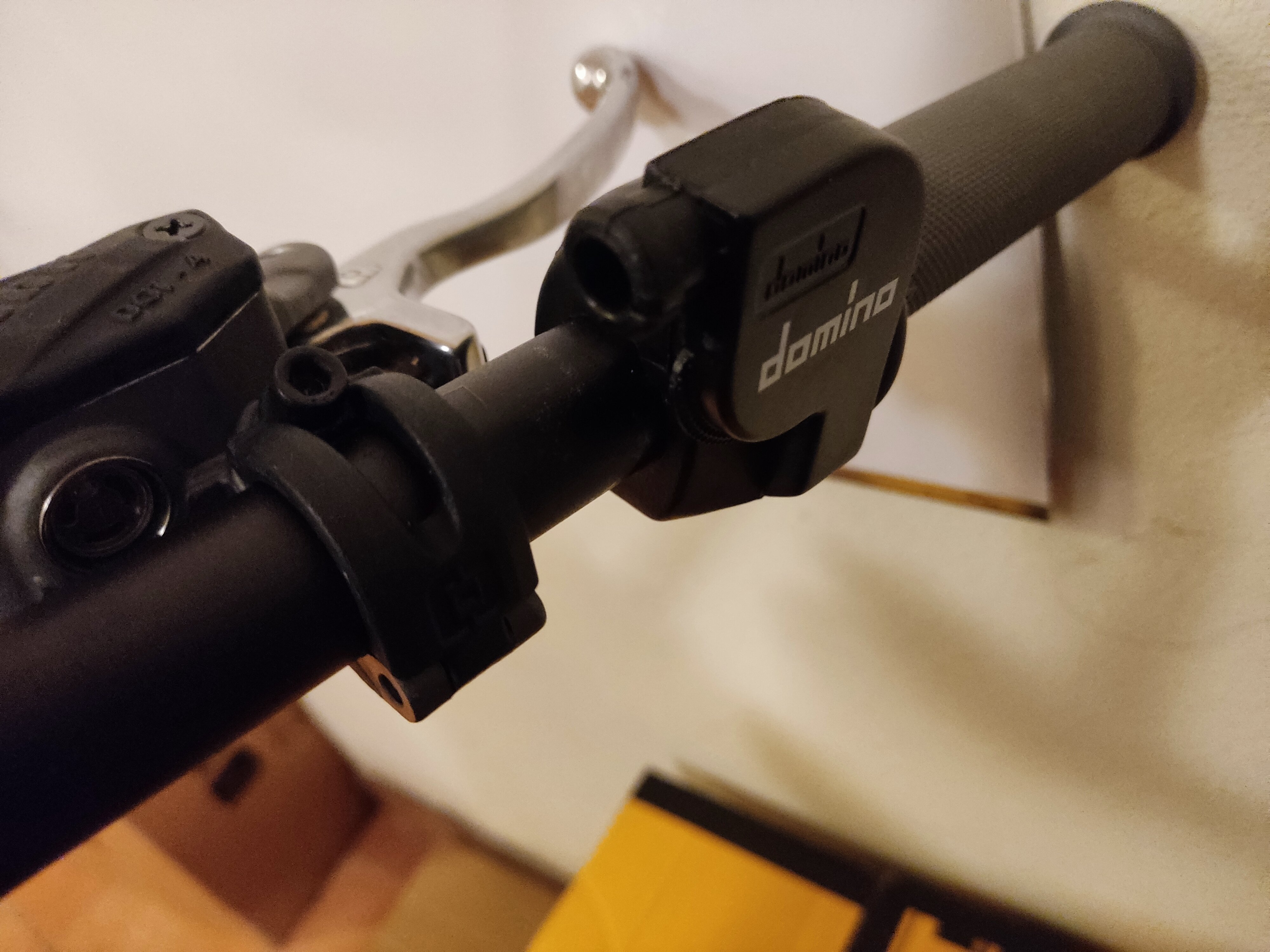

November 18, 20224 yr Author Below on the pics is the TB Domino housing what I'm asking about, is there a cover I can pop up or unscrew everything?
November 18, 20224 yr No need to take the hex bolts out. Pull up on the tab just to the left of the d in 'domino'.
November 18, 20224 yr Author 8 hours ago, faussy said: No need to take the hex bolts out. Pull up on the tab just to the left of the d in 'domino'. are you sure i won't break it?
November 19, 20224 yr The cover is meant to just clip in place, close the throttle & fit the cable with the last piece to go in being the outer casing into the housing. Test that the cable is working properly before refitting the cover
