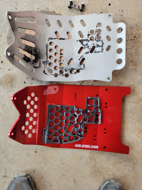

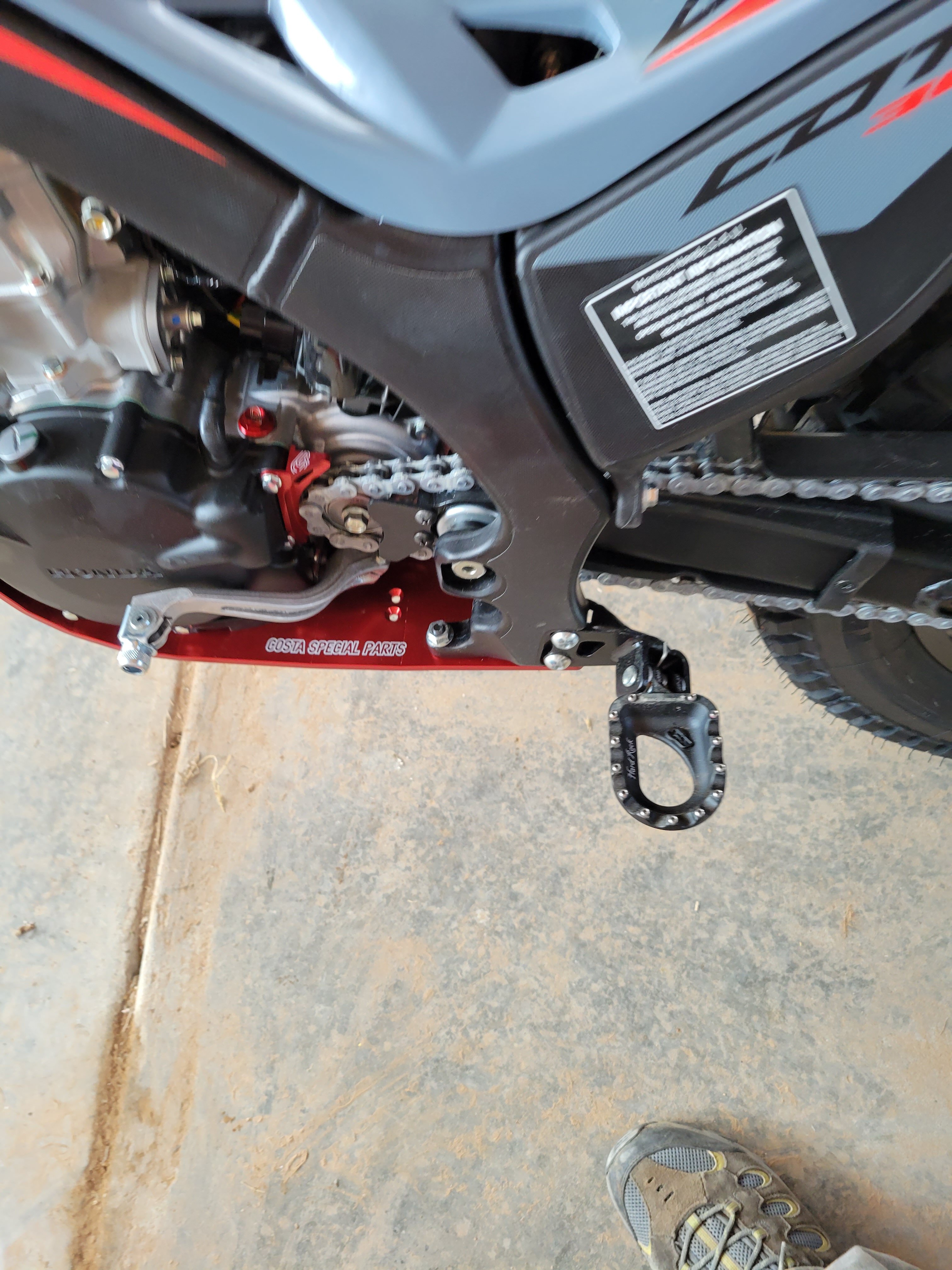

 I replaced with a CSP before I even started the bike. Biggest thing is the stock plate is too thin. Also look at how I cut the pad as to just remove the pad doing oil changes. I also put longer bolts in the rear, no need to remove the plate ever again.

Many thanks for the information and the pictures. Very useful indeed. Yes it definitely protects the underside more. I honestly had no idea before I bought the bike what a faff an oil change was on the 4rt. I had a beta Rev 4 in 2008 and an oil and filter change was a simple task. I'm sure the Evo 4t is similar.
What length bolts have you got on the back ? I see h&d racing do there own sump guard for £110 which looks pretty similar.
I also see you have bought a case protector around the front sprocket. Is the standard montesa one no good ?

 The stock guard is fine. I waited six months for my bike and in the mean time bought all the CSP bling except the foot peg brackets. The frame at the brackets is the weakest link of the whole bike. Better to bend the stock bracket.
 The bolt was just long enough to add a nut to. To change the oil filter just back off the bolts and remove the small rubber along the case. I silicone the pad back in place.

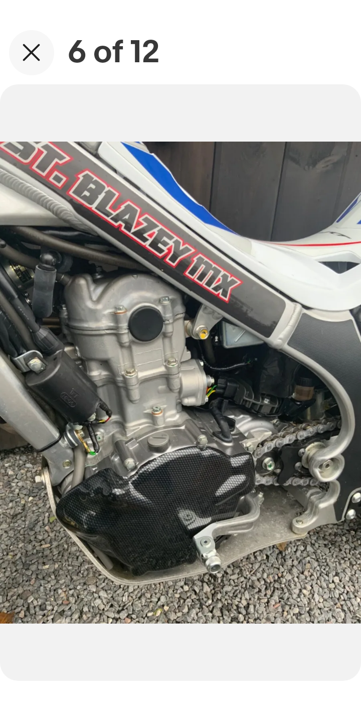

I did the full carbon fiber case covers, after a friend cracked the left side case by the oil passage at the top. Hairline crack, but he had to get towed back to the pits.

I have done the same. Engine covers, frame covers, swingarm covers and fork slider covers. Just the sump bash plate to get now. I always cover my bike with guards. The way I ride it's essential!!
