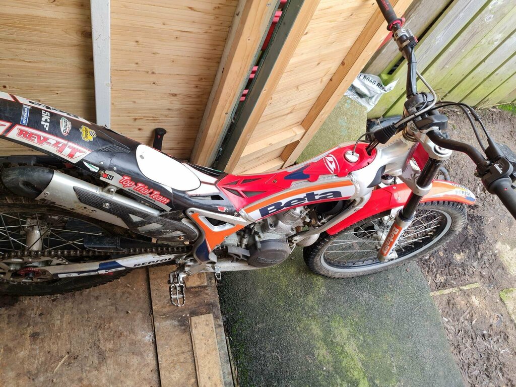

Having just been set right on a bike I proposed to buy which was identified by a forum member as being mid-advertised as a 2012 when it was a 2005, can I seek your advice in confirming/not the bike below, which is described as a Beta 250 from 2008, please?
I appreciate it isn’t a 4T (presumably the plastics or decals are from another bike)

One way to help know what year a Rev 3 is, is to count the spokes. The wheels changed from 36 spoke to 32 spoke in about 2005.
If it was me buying it, I wouldn't care what year model Rev 3 it is. They are all good to ride. Condition would be the important thing.
From the photos it is impossible to know if it is a 200, 250 or 270. The 125 had a different exhaust to the one in the photos.
I had a 2007 that looked very similar but my wheels were plain alloy - I think those black/silver rims came in 2008 and stayed for a few years including the Evo. Of course, they may not be the original rims. Good bikes regardless, if they are well looked after.

Note that the rear guard is cracked up bigtime and by the looks of things a throwaway Chinese pitbike master cylinder on the front brake.
A Beta rev 3 is a good choice as a starter bike as virtually all parts are available ex factory.
After a trip into the roundabouts around Teesside, I’ve brought home what turns out to be an ‘08 Rev3 270 (not the 250 as advertised-will do some research on this later tonight)

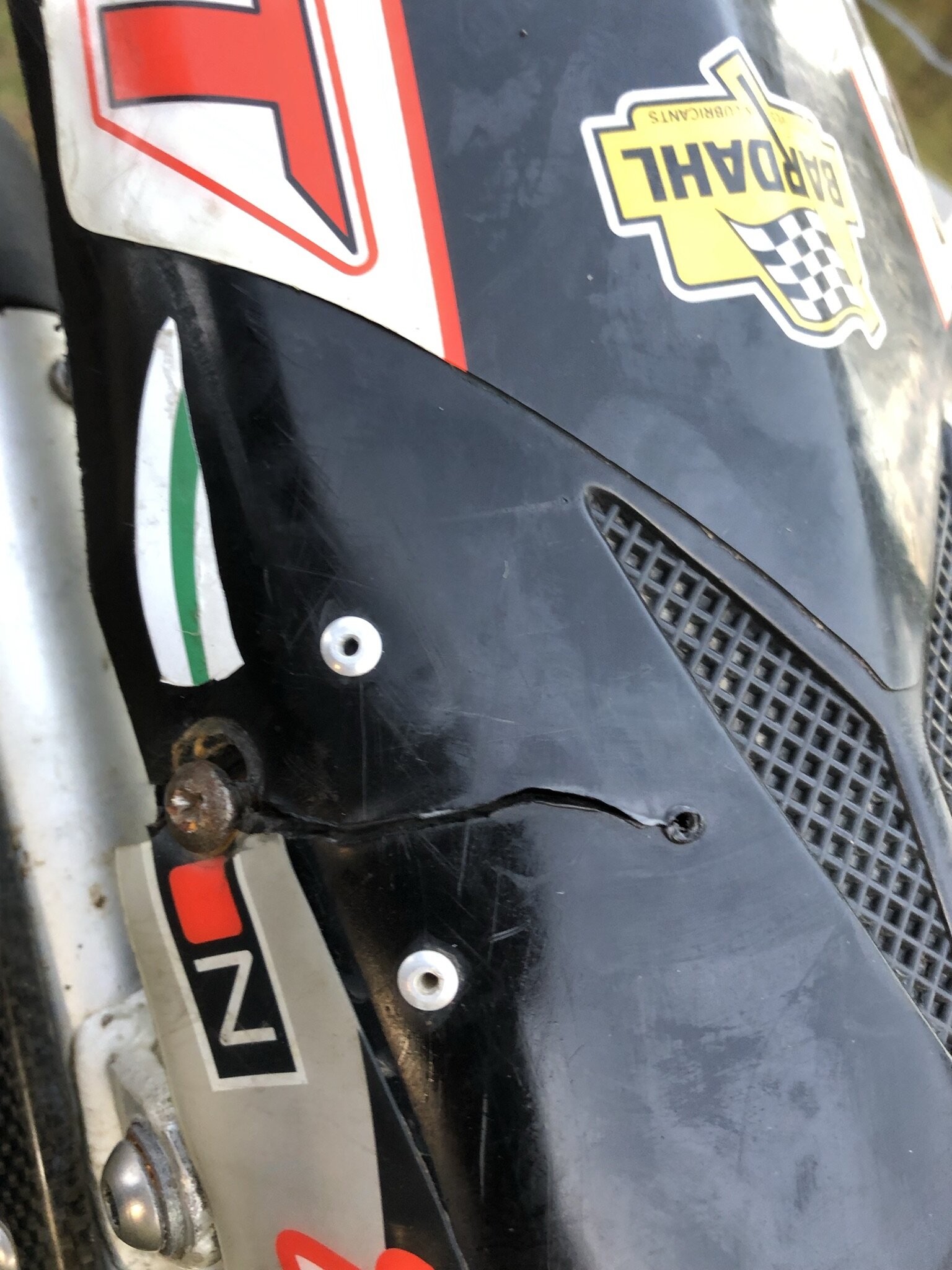

and the rear mudguard is split, has been plated, but that’s come loose. I gather it’s a 4T version, and as the correct one is over £150, and I’m bound to damage it, I’m proposing to re-rivet the crack and struggle on.

I'd just ride it as it is and find out what doesn't work and fix as you go. If you've never ridden trial before then leave the existing mudguard as likely to snap a brand new one 🙂
