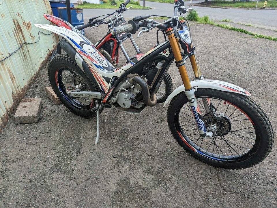

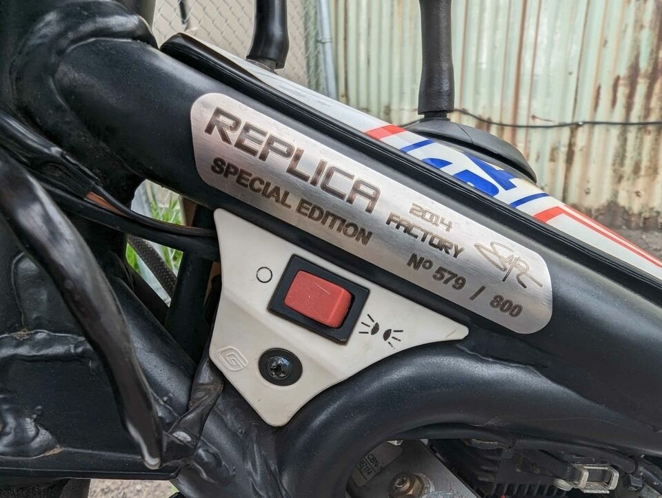

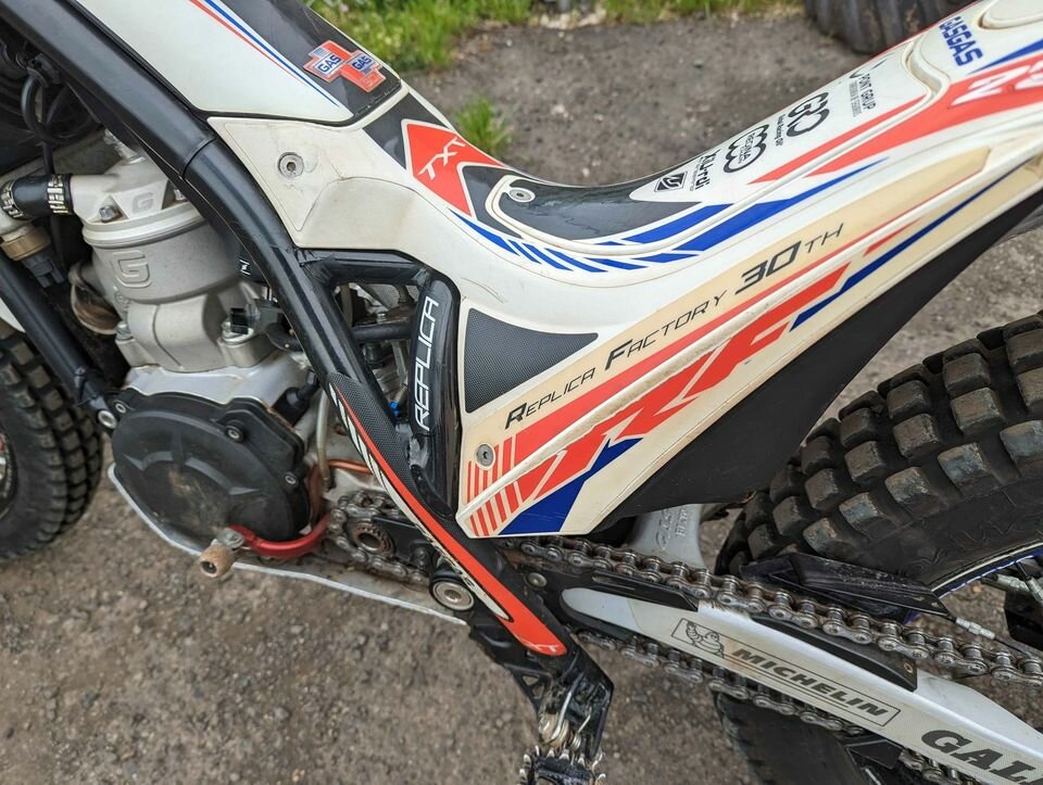

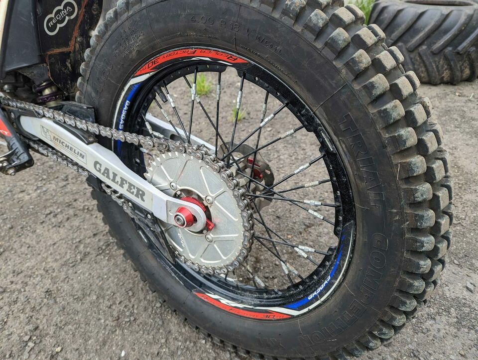

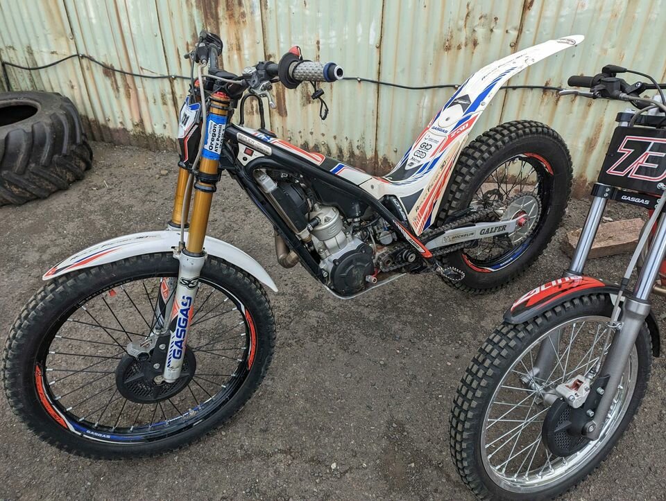

Well, the 2014 GAS GAS TXT250 Raga is firm at $3,500. I'm leaning towards waiting to see what else I can find, even if it takes a few months. What do you guys think, is that a good deal for the PNW USA?
Edited by Trials4Wulf
I wish I could read the mfg date on that rear tire? Maybe you can by zooming in on the original pic, could be an original tire showing it's lack of use. Very similar price that I paid for a very similar bike. Everything I see looks original except maybe pegs and shifter, someone has cut down the levers as well. I don't even see boot wear on the frame stickers, much less visible wear than mine! I don't know that I have ever seen pillow top grips on a trials bike, look out of place.
