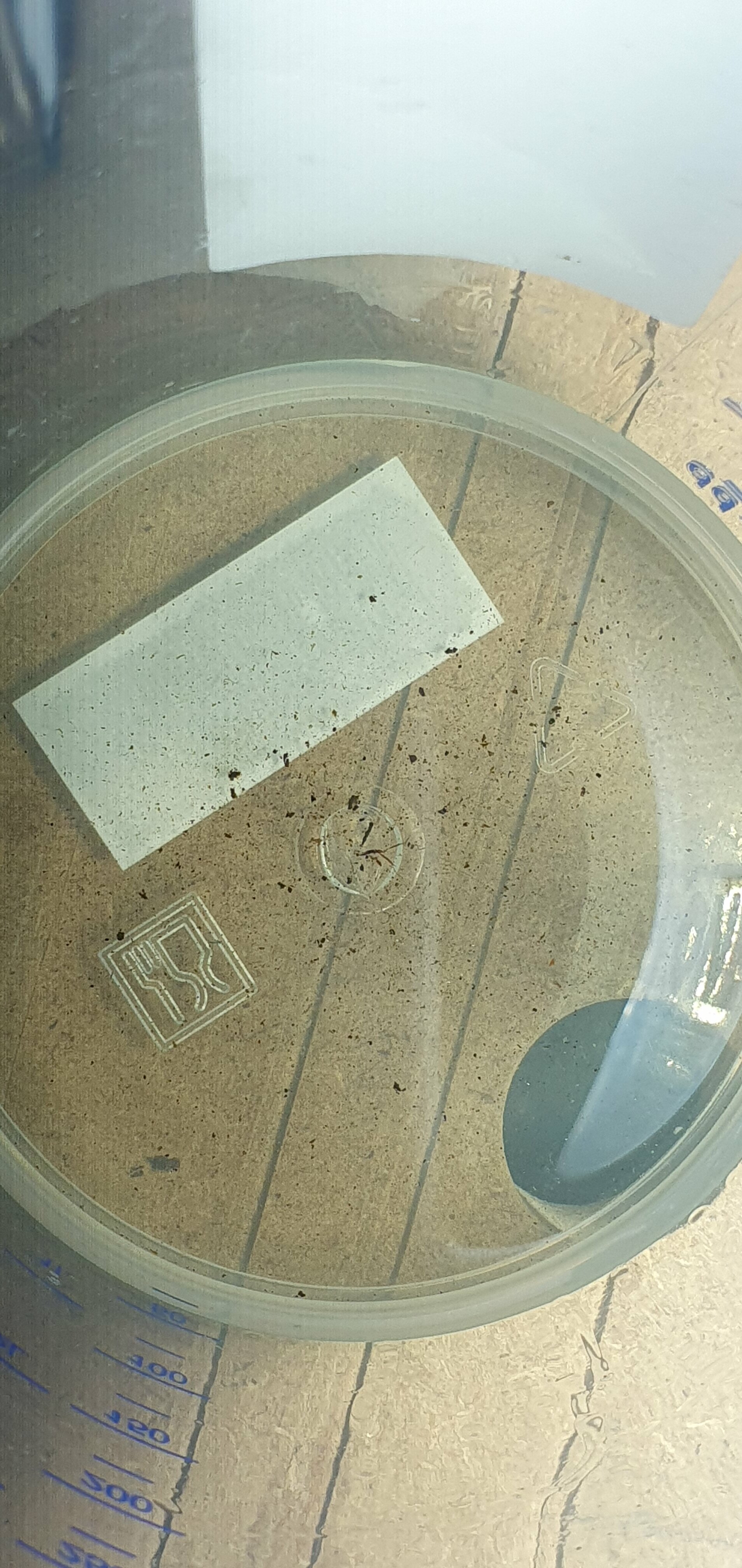

Hello all,
After washing the bike I went to take the float bowl drain plug out to make sure no water had found its way in.  The fuel inside had quite a lot of crud in it.  There is no inline fuel filter on my bike and the fuel hose, whilst Sherco branded, wasn't clipped but was incredibly tight fitting.  Had to cut it off.  I guess I'd need a longer one for an inline filter anyway.
Is this typical for a float bowl?

Definitely excessive, I'd rather find it in the float bowl than many other places though!
Thanks, thats kind of what I thought.  I'm going to see what a strong magnet picks up tomorrow as I saved the contents.

Cheers.  I've ridden it for about 5 hours so far.
It doesn't run particularly well.  It's been struggling in 3 and 4th and stalls intermittently when idling in gear.  Hoping the carb clean will sort that but it's as much about getting to know the bike at the same time really.
That does sound like the kind of problems a good carb clean will sort, it's definitely worth fitting a carb service kit at the same time, then once it's dialled in you won't have to touch it again in a long while (assuming the bikes getting used ;) )
