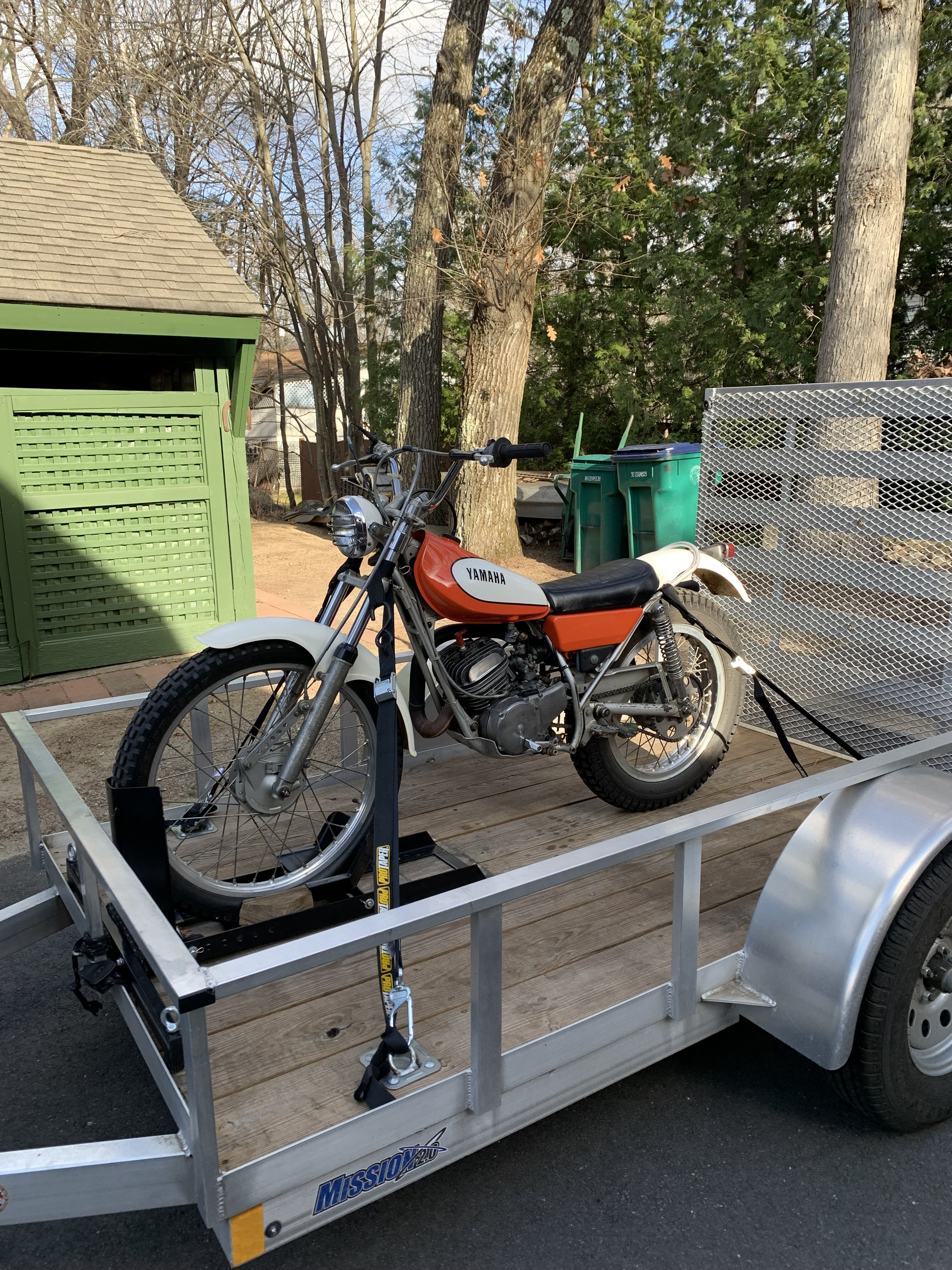

Hello All; new elderly member returning riding after 40 years; Just found a 1976 Yamaha TY175 the same bike I bought new in 1976; The bike is in good shape everything original; I’d like to slowly start updating it to make it a bit lighter and handle and ride better; nothing major at first may be tires, handlebars, levers, and foot peg replacement / repositioning; any advice or previous experiences in doing this; would be appreciated; my goal being older now; is to slowly bring back my riding skills; in woods behind my house and possibly enter a Observed Trials event down the road; I’m hoping some upgrading and simple mods; will help and make a more enjoyable riding experience! Any input will be appreciated. Thanks; John.

Hello; found the 1976 Yamaha TY175 coming home now ; excited about trying to relive some old memories; that I had in 1976; when I bought this same bike new! Thanks, John

Looks like it has just come off the showrrom floor :)
Thanks for the compliment not quite that good; if you get close up it’s still a 47-year-old bike and showing signs of normal wear; although it doesn’t look like it’s been trashed;  but I’m old and worn out some also so we should get along good together! Take care, John

Nice headlight, you should take that off and store it somewhere safe.
