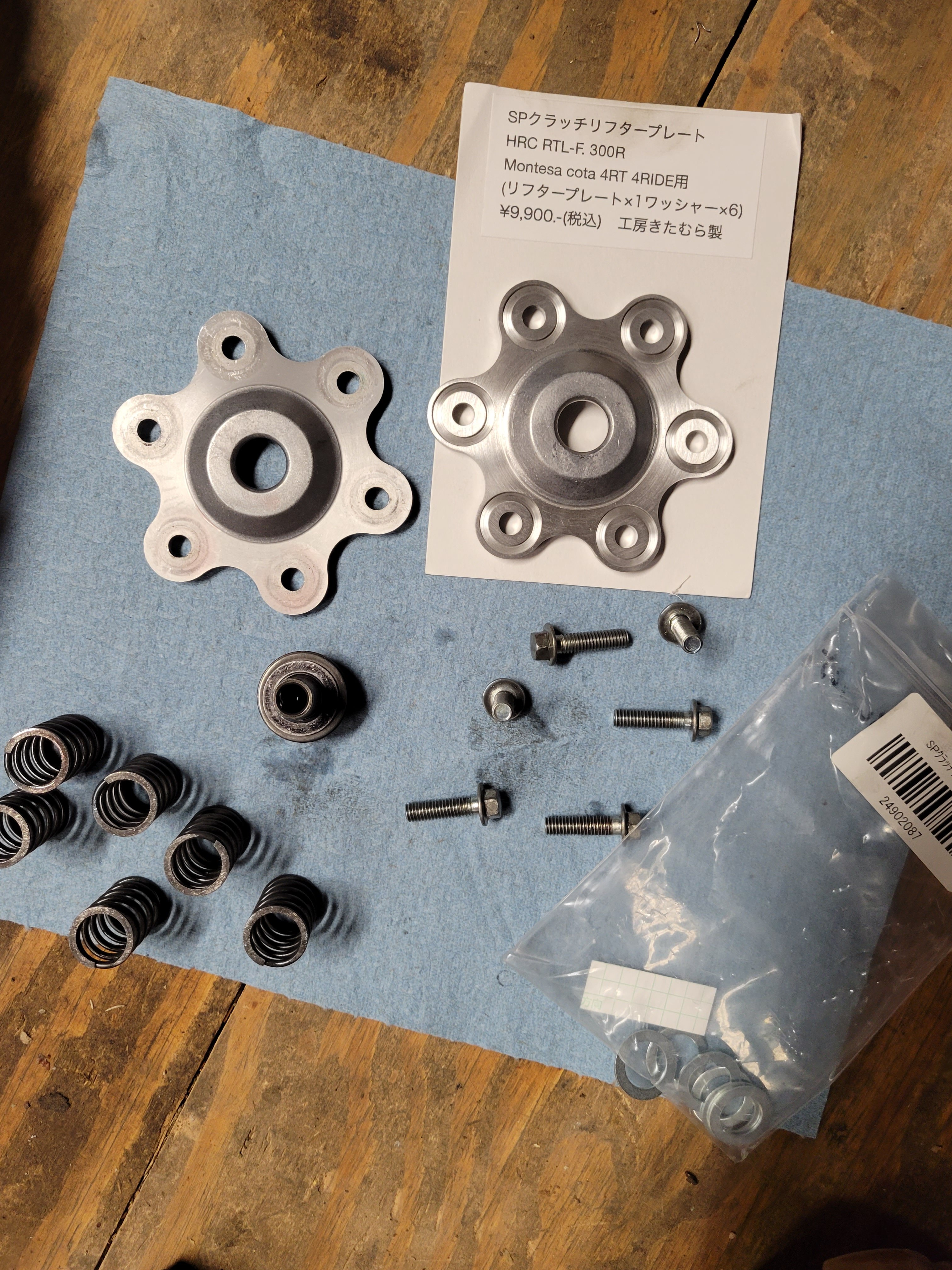

lineaway Posted November 15 Report Share Posted November 15 (edited) There are springs and plate available which improves the clutch feel. of course it`s only available in Japan. Edited November 15 by lineaway Quote Link to comment Share on other sites More sharing options...
lineaway Posted November 15 Report Share Posted November 15 The plate holds the springs straight. They other wise rub on the towers. The springs are much lighter. Available from Webike. Quote Link to comment Share on other sites More sharing options...
