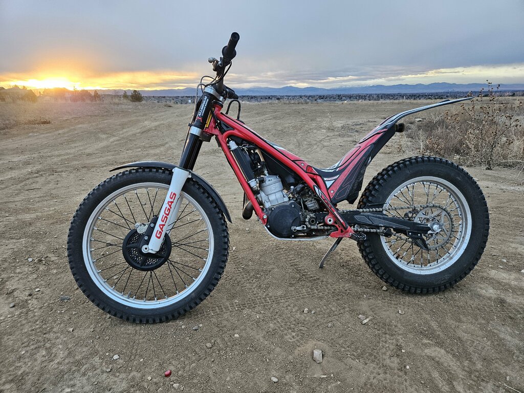

mostexcellentdude Posted December 23, 2025 Report Share Posted December 23, 2025 (edited) I recently picked up an 04 GasGas TxtPro Raga 300 and am interested in finding a bike for my wife as well. She is a competent singletrack/enduro rider, intermediate I'd say. Trouble is, she's petite - 5'-2" and 120lbs. Good shape but not the strongest. She can't even kick my 300 over. I'm interested in picking up a smaller displacement bike that might be easier for her to start. We live at 5,000ft elevation and could ride as high as 10,000ft. I prefer to go gas over electric, we do a lot of extended trips deep in the mountains or desert far away from a charging source. Would a 125 have too little power, especially considering our elevation? I'm leaning towards a 200 because although she's a decent rider, I don't want her overwhelmed with all the clutching a 125 might require. The main benefit I see with the 125 is I imagine it would be easier to kick over. I'd like to keep the budget around 2k USD... in my area that buys me an older GasGas/Sherco 125 or 200 most likely. Is the Sherco kickstart system easier than the 'short throw' TxtPro kickstarter? Edited December 25, 2025 by mostexcellentdude 1 Quote Link to comment Share on other sites More sharing options...

mostexcellentdude Posted January 3 Author Report Share Posted January 3 (edited) Thanks for the feedback everyone. We were leaning towards a 200 after reading the comments, but I ended up getting a 2014 GasGas TxtPro 250 on a trade deal for a motocross bike I just finished building. She's been able to start it without too much hassle so far. It definitely kicks over easier than my Raga 300. If repeated starting becomes a problem, we'll toss on a low compression head insert and see if that makes things easier 👍 Edited January 3 by mostexcellentdude 2 Quote Link to comment Share on other sites More sharing options...
