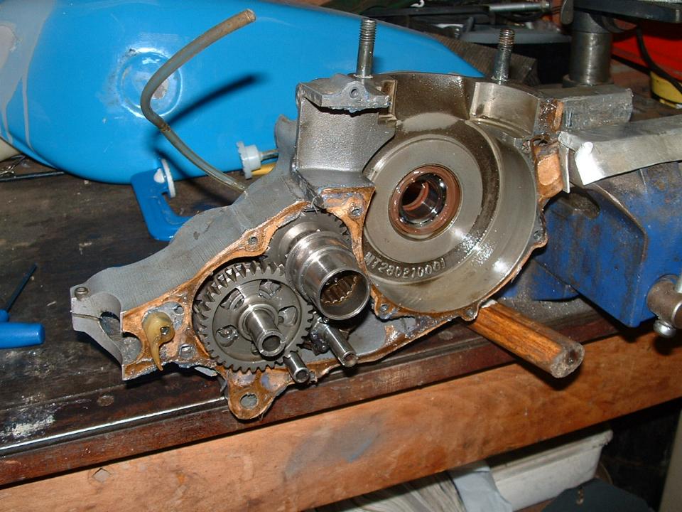

Uhoh, do a search in this gg forum with:engine (or something like that)and try to find my topic. There is a pic of the gearbox internals.
