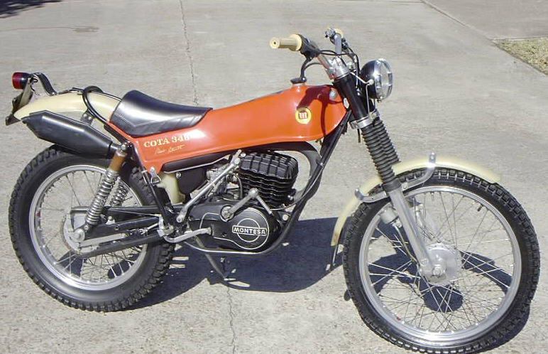

Hi there - new member, being a British expat currently resident in Mexico. Coincidentally, I too have just purchased here in Mexico a Montesa Cota 348 MR Replica. The bike has stood idle for 7 years but from what I can see is both complete and original, down to the miniature speedo on the right fork leg. The engine and frame number on mine are 51M 9740 which I understand makes it a 1976 model. I only picked the bike up yesterday, so have not had a chance to go over it in detail, but the engine appears to turn over and has compression and it appears to move through the gears ok.
What would you suggest I need to do to the bike - would I be risking anything by merely changing all the fluids and trying to start her? I suspect that if she has sat for 7 years the crank seals will need replacement - what else should I focus attention on.
What I am desperately in need of is a workshop manual - i have managed to find a download the owners manual and parts manual, but does a workshop manual for this model exist (I have the clymer manual covering all 123cc to 360cc models, but only up to 1975 which does not appear to cover the Cota 348).
One final question, the final silencer on the exhaust appears, from what I can see from my limited research, to have come off the Cota 348 Trail - does this look right.
All comments and suggestions would be gratefully received!!

Hi from Spain Mexbiker. Being in Mexico you must know some Spanish, in Todotrial you have the complete 348 manual in Spanish:
http://www.todotrial.com/ttclasico/manuale...nualcota348.htm
My advise is you start with the next;
1.- Check Ignition and plug, (pionts, coils, condenser, advance) untill you get a nice spark.
2.- Check Clutch
3.- Engine oils
4.- Clean carburettor, interior tank and fuel valve.
4.- Change front brake, throttle and clutch cables.
5.- Chain
6.- Brakes shoes
7.- Check and change fork oil.
8.- Spokes
I would then change the handlebar as it looks bent in the photo, and the throttle (it looks an old Mototecnica for enduro). Check bearing, seals etc. etc. and change shocks if they don
