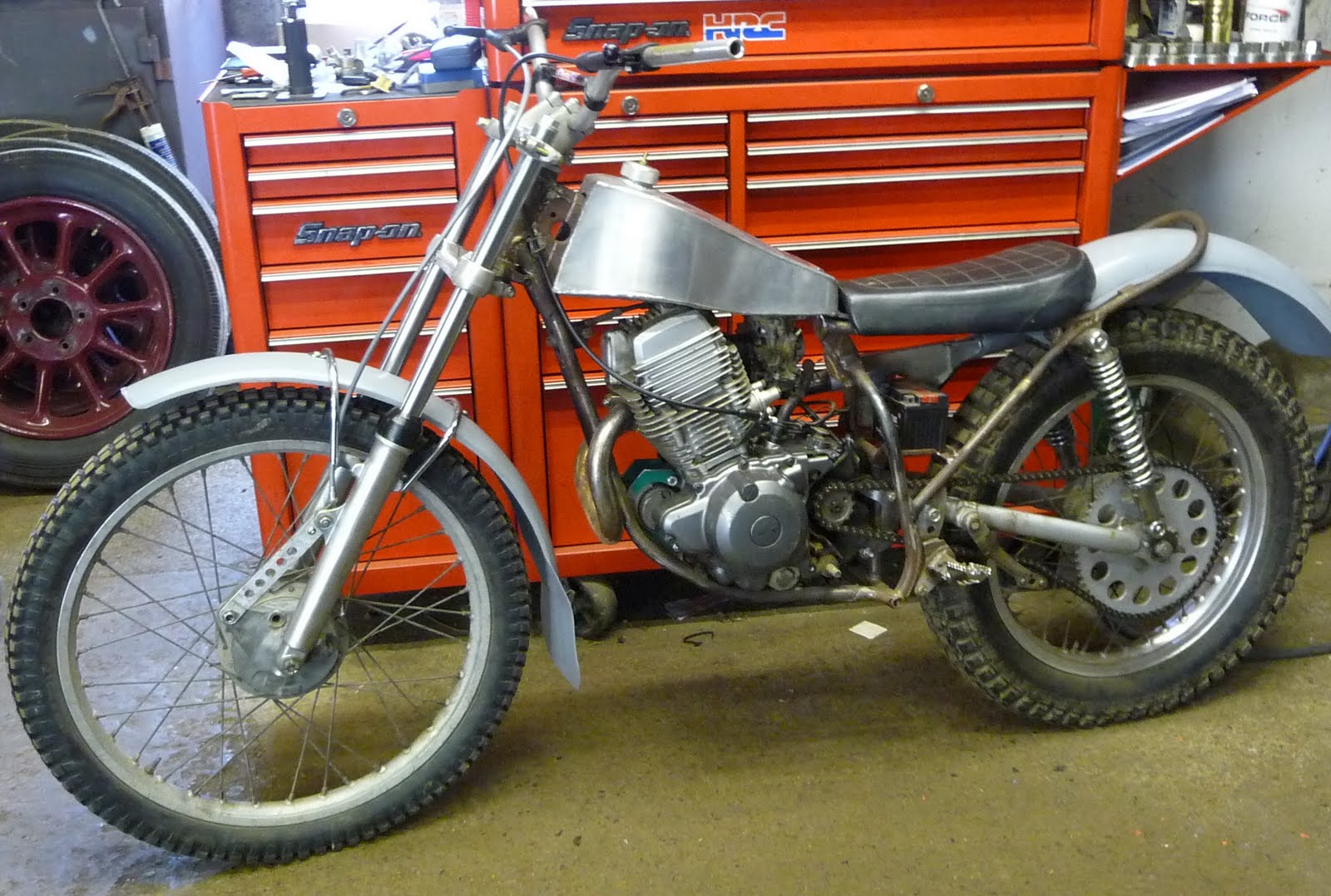

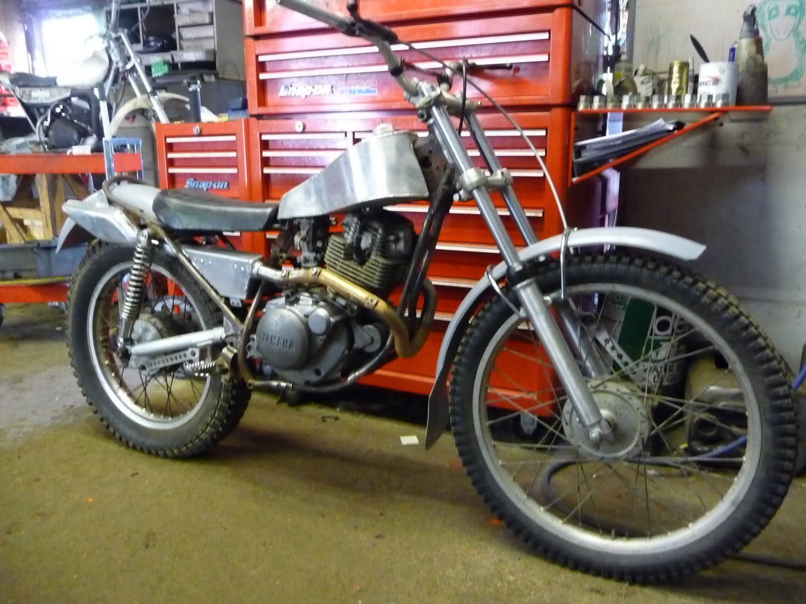

Well at last there is progress.... I decided its been too long sitting gathering dust so I've had a good go at it this weekend and built it up to a rolling bike.Nowhere near finished,but its got me enthused to get on with it.Balancing on it in the workshop makes it feel really small and suprisingly well balanced.
The idea is to do a dry build so I can do a good test ride on it then strip and paint it.Dartmoor here I come !

It runs !! I cancelled a couple of jobs this week to give me time to sort a few things out.Then I just got carried away with working on the Xty, I've sorted out the electrics,(Well the ignition anyway)starting is by jump leads from a car battery.It has no brakes yet,nor air filter etc so plenty more to do.
First impressions are good,its centre of gravity feels low and it steers nicely.Despite the slow action Domino throttle its still too abrupt so that wants slowing down.My calcs for the gearing were about right,first is nice and low but second is a tad faster than I'd like - I guess there has to be a compromise somewhere unless you have a works team behind you.
