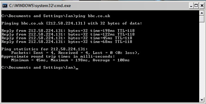

The easiest way to check an internet connection is using the ping function in windows.
Try this ...
Click START > Run > then in the box type CMD
A DOS box should come up like below .
Type ping bbc.co.uk in the command line ( as below ) and it should return the info similar to below if everything is ok.
You can try other internet names after the word ping instead of bbc.co.uk to see if you have a connection.
Is it timing out? If it is not, it may be an issue with your browser/firewall/router settings

it's ok when I ping sites, so it's not that.
