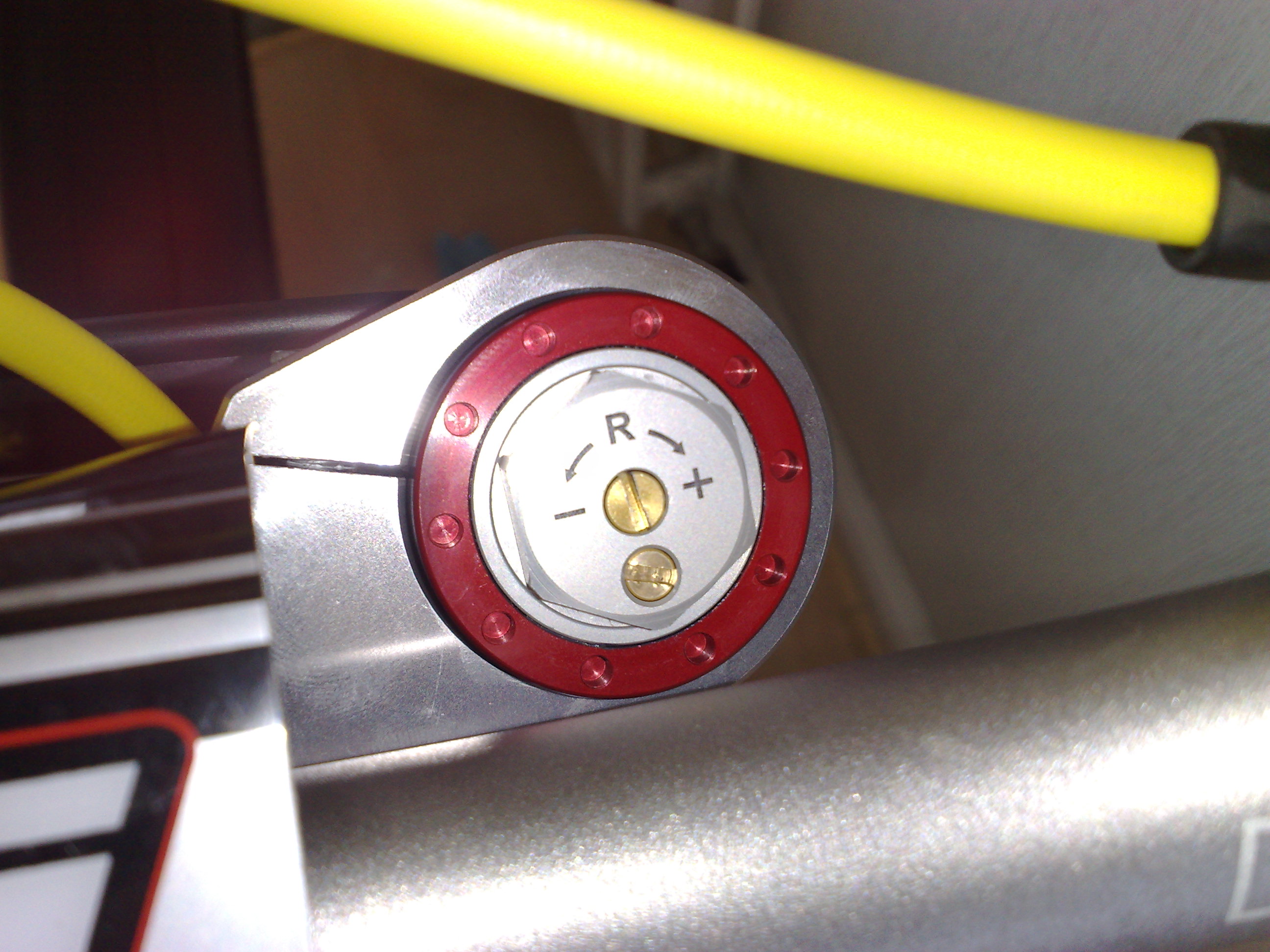

Not to challenge Jon, but the pre-load is adjustable be turning the large nut inside the red ring (the one with the R on it). Don't overdue it either way as you can damage the internal stop if it is forced.

You cant adjust preload as such, but you can slow or speed up dampening and rebound seperately.
If you want to do preload you'll have to dismantle the forks, remove the plastic tube and make up an new one of the same diameter.
You can try screwing the large nut with the screws in it, a bit... not to far though, that will make a difference, if thats not to your liking just adjust the two screws, they make a huge difference to the feeling of the bike and you SHOULD be able to get it how you want!

THIS IS INCORRECT!!!
On the forks pictured you CAN adjust the preload,just wind in the 22mm nut in the picture inside the red ring,it allows about an extra 5mm of preload.
